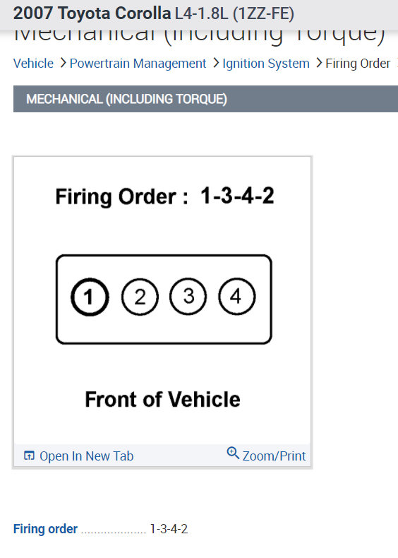

My engine light is on so i went to autozone to do a test and its saying that the #3 is not firing, so witch is the #3 plug.
Mar 3, 2009 at 3:04 AM
MMPRINCE4000
  • 8,548 POSTS
3rd plug from #1. #1 is closest to the assy drive (alt. PS). Cylinders are 1-2-3-4 from assy side. Firing order is different from cylinder location.

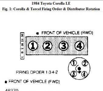

Hi what is the firing order for a toyota corolla 1295 cc please
Dec 30, 2020 at 8:00 AM (Merged)
FISHERMAN
  • 937 POSTS
Hello !! Here`s the firing order : good Luck!
https://images.2carpros.com/forum/automotive_pictures/576_0_3.jpg

I need to know the firing order of my 1999 Corola. I took the wires off the plugs and do not know the order to return them. Please help.

  • 75,992 POSTS
FIRING ORDER
FIRING ORDER
ApplicationFiring Order 4-Cylinder
(1)Camry & Camry Solara
(2) 1-3-4-2
Celica, Corolla, RAV4, Tacoma & 4Runner
(3) 1-3-4-2
V6
(4)Avalon, Camry, Camry Solara & Sienna
(5) 1-2-3-4-5-6
Tacoma, Tundra & 4Runner(5) 1-2-3-4-5-6
V8
(6)Land Cruiser & Tundra
7) 1-8-4-3-6-5-7-2
4cyl F/O 1342
(1)Cylinder No. 1 is located at timing belt or timing chain end of engine. Cylinder No. 4 is located at flywheel end of engine. Timing belt/chain is 2/3 in middle 4 at flywheel.
(2)System uses a Distributorless Ignition System (DIS) with 2 ignition coils. Cylinders No. 1 and 4 use the same ignition coil. Cylinders No. 2 and 3 use the same ignition coil. See Fig. 2
(3)See Fig. 4.
(4)Cylinder No. 1 is front cylinder on right side of engine when viewed from flywheel end of engine. Cylinder No. 2 is front cylinder on left side of engine when viewed from flywheel end of engine. Cylinders No. 1, 3 and 5 are on right side of engine. Cylinders No. 2, 4 and 6 are on left side of engine.
(5)System uses a Distributorless Ignition System (DIS) with 3 ignition coils. Two cylinders fire simultaneously using same ignition coil. See Fig. 3
(6)Cylinder No. 1 is front cylinder on left side of engine when viewed from flywheel end of engine. Cylinder No. 2 is front cylinder on right side of engine when viewed from flywheel end of engine. Cylinders No. 1, 3, 5 and 7 are on left side of engine. Cylinders No. 2, 4, 6 and 8 on right side of engine. See Fig. 5.
