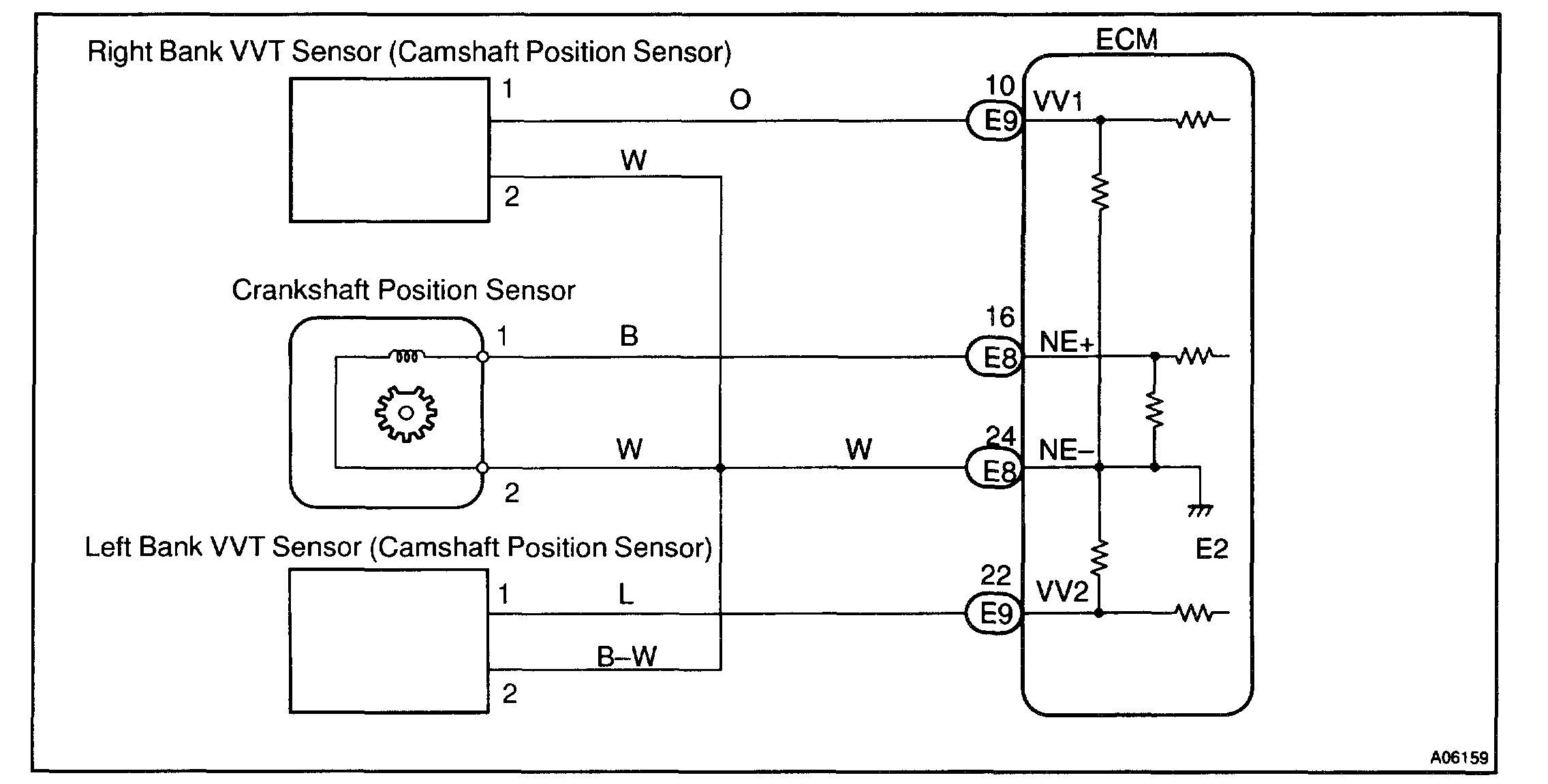

I have replaced the water pump, timing belt, tensioner and idler pulley. Check engine light comes on, code P1346 VVT sensor/camshaft position sensor circuit range/performance problem (bank 1). I've replaced the camshaft position sensor, bank 1, and the check engine light comes on again with the same error code. The car runs great, (except for the check engine light). Double checked timing marks and they are all aligned. I've cleared the codes a few times with the same results as mentioned.
What do you suggest?
Oct 26, 2019 at 4:39 PM
  • 110,190 POSTS
Welcome to 2CarPros.

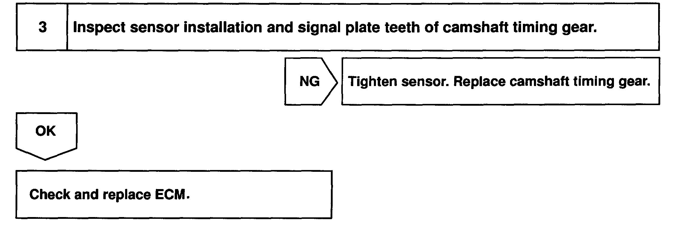

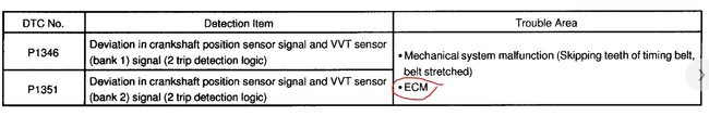

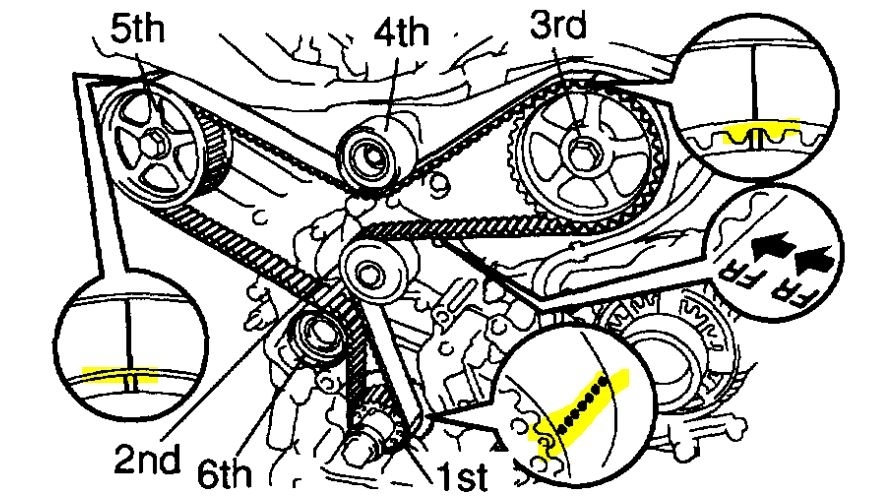

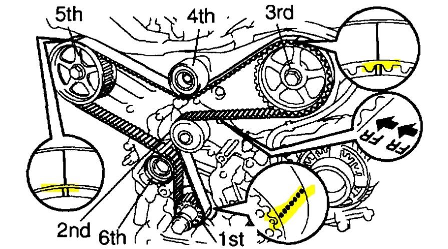

Take a look at picture 1. For this code, it indicates either a timing issue or ECM. If this wasn't an issue prior to the replacement of the belt, I suspect that for some reason, timing is off. I attached another picture. Is that where the timing marks are located with the engine cold?

Yes, those are the locations of the timing marks that I used when I replaced the timing belt and related components. Would the engine run smooth if the timing was off? The engine runs very good, smooth.
I don't know if the 'check engine' light came on the day the water pump went out. The old water pump bearing was completely shot.
I suppose I should remove the timing covers and verify the timing marks positions.

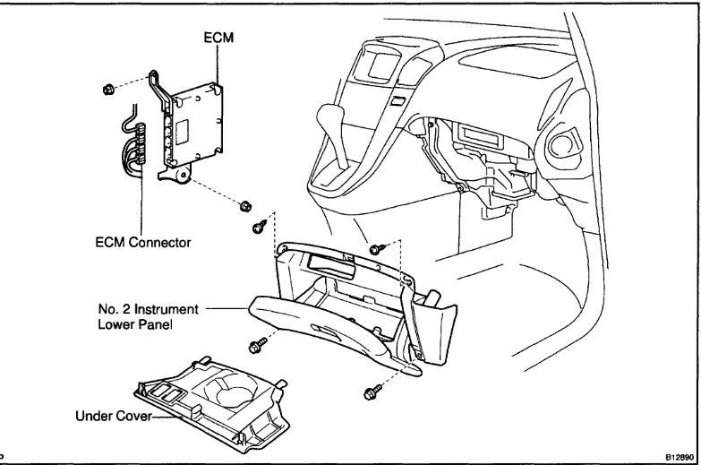

How do I access the ECM? If my Haynes manual is correct, it is located behind the glove box. Can you advise on how to remove the glove box, (if that is what is needed to access the ECM)? Thank you in advance.
Nov 3, 2019 at 12:26 PM
  • 110,190 POSTS
Welcome back:
I attached a picture showing how it comes apart. Let me know if it helps.

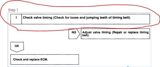

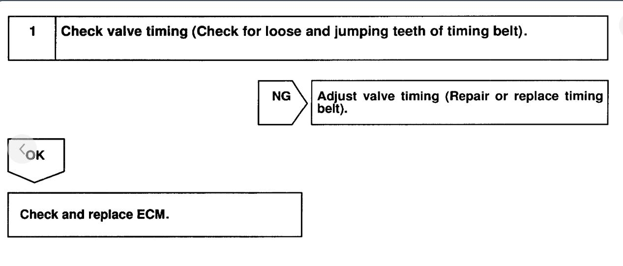

Is it the same code that returned? If it is, we know the code indicates a variation in VVT timing between the crankshaft and camshaft VVT sensor bank 1. I honestly suspect it is a mechanical issue such as a stretched timing belt. It is either a timing issue (stretched belt or off a tooth) or the ECM is bad.
If you look at pic 1, it shows the flow chart for troubleshooting the problem.

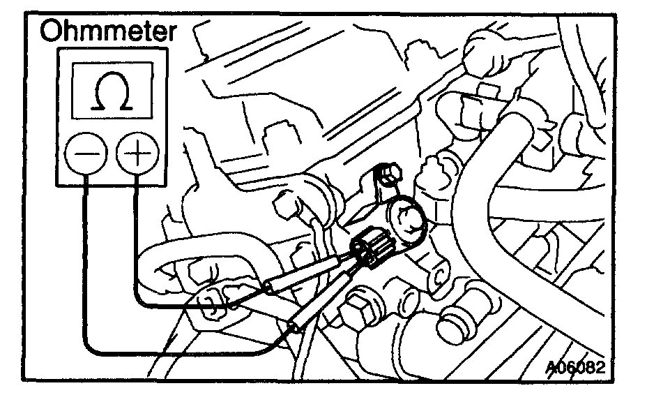

Here are the directions for testing them. Picture 2 correlates with these directions. All you are doing is checking resistance in the sensor itself.
__________________________________________
2001 Lexus Truck RX 300 AWD V6-3.0L (1MZ-FE)
On-Vehicle Inspection
Vehicle Powertrain Management Computers and Control Systems Variable Valve Timing Actuator Testing and Inspection Component Tests and General Diagnostics Camshaft Oil Control Valve On-Vehicle Inspection
ON-VEHICLE INSPECTION
pic 2
INSPECT OIL CONTROL VALVE RESISTANCE
a. Remove the V-bank cover.
b. Remove the intake air connector.
c. Disconnect the oil control valve connector.
d. Using an Ohmmeter, measure the resistance between the terminals.
Resistance: 6.9 - 7.9 ohms at 20 °C (68 °F)
If the resistance is not as specified, replace the valve.
e. Reconnect the oil control valve connector.
f. Reinstall the intake air connector.
g. Reinstall the V-bank cover.

The probes on my meter won't reach both contacts on the oil control valve. Is there any reason I can't test the control valve on the bench? (Remove the valve and test on the bench.) Please advise. Thank you in advance.
Nov 25, 2019 at 3:51 PM
  • 110,190 POSTS
When checking resistance, you can remove it because all you are checking for is to see if there is a break down in the unit. The DMM (digital multi meter) supplies power.

It is the same error code, P1346. I checked the resistance on the oil control valve and it is good. It measured 7.3 - 7.4 ohms. Do you suggest verifying the timing marks positions? I'm very confident I had them in the correct position when I replaced all those components. When I was doing that work, I wanted to be sure the timing marks were aligned because I didn't want to do all this work twice. Good plan, but maybe a poor execution. Is there a way to test the ECM? Please advise. Thank you in advance.

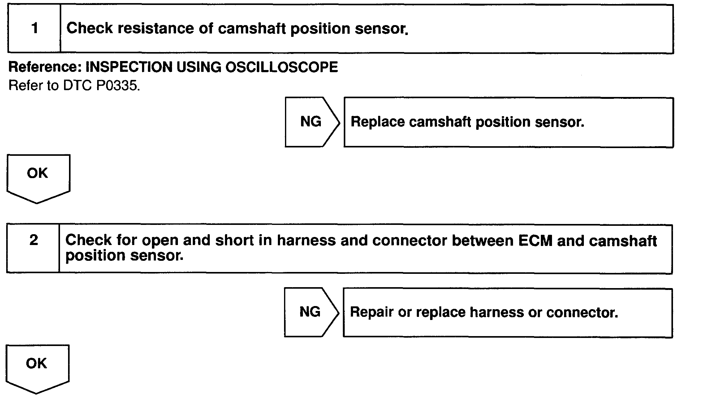

If you were checking ohms, that is different because the power was supplied via the multi meter simply checking resistance. I may have asked this already, but do you have a scanner that can provide freeze frame data? If so, read freeze frame data using an OBD II scan tool, because freeze frame records the engine conditions when the malfunction is detected, it will be useful for determining whether the vehicle was running or stopped, the engine was warmed up or not, the air-fuel ratio was lean or rich, etc. at the time of the malfunction. As far as checking the ECM, basically the directions indicate to check for an open or short in the wiring between the sensor and the ECM. If no problem is detected, replace the ECM.
Take a look at the flow charts I attached. See if anything helps.

It looks like your first analysis was correct. I finally got the timing covers and associated parts out and found the bank 1 timing marks are off by one tooth. I was sure I had it correct when I replaced the water pump and timing components, but I guess I made a mistake. I'll let you know the results after I adjust the timing belt on bank 1 cam gear. Thanks again for the assistance.
