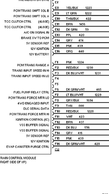

So today I ran a pressure test and it showed 0. I replaced the fuel pump and the relay and still nothing. I completely forgot what you said about checking for power at the tank and that must be my problem and thats all on me for forgetting. Now that im back at college where my truck is ill be able to work on it more so how do I go about making sure I have power?

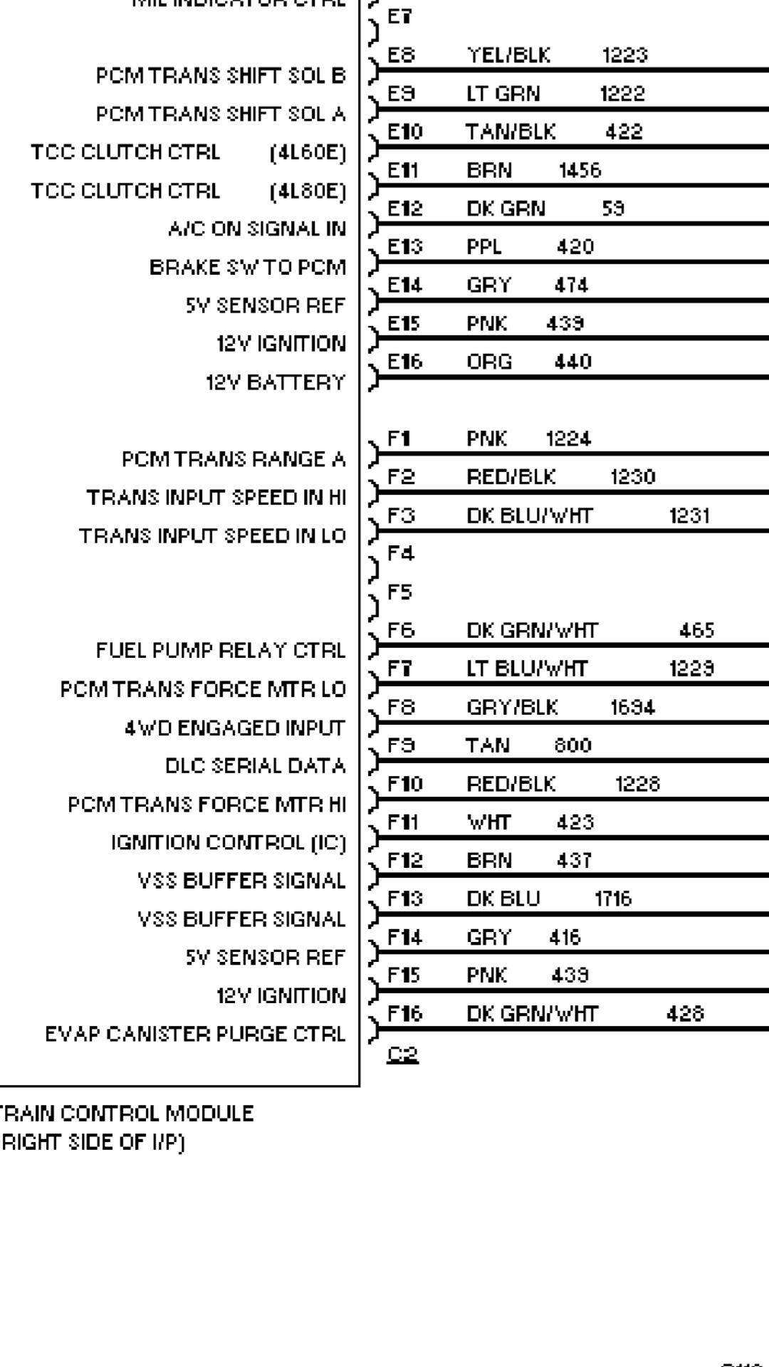

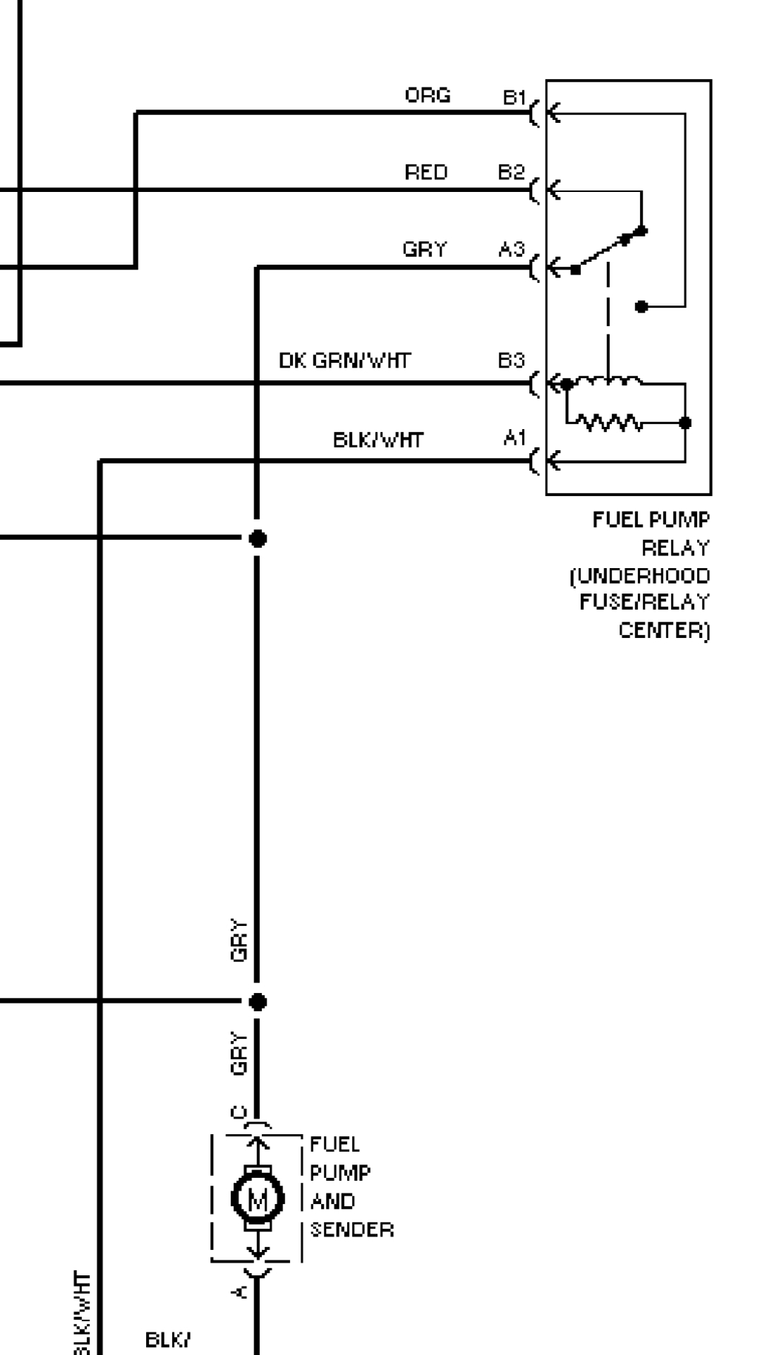

Okay, we're going to skip forward here since you've replaced the fuel pump relay already. There should be 2 hot wires (12 volt) while cranking, where the relay sits. So take it out and check the pins for 2 for 12 v cranking. Now there could be corrosion in fuse panel where the relay is too, so you'll have to check it. If there isn't 2 hot pins at the relay, then go to the back of the ECM and check pin F6, it will be dark green/white. You will have to find it according to color. This wire should be 12v while cranking as well. Here's 2 wiring diagrams to help. Make sure to pay attention to wire condition also, you most likely have a broken or corroded wire. Check around where you have been working on the truck so far, that you didn't move any wires or hide the problem. Since you had the fuel pump running before. Check all the ground wires near the pump on the back of the frame too. The 2 thicker wires at the fuel pump are power and ground, the power is the thick grey wire.

My fuel pump relay isn't in the fuse box its on the firewall directly in front of the ECM in the engine bay. I don't think the location should matter as long as I am finding the right wires. Right?
Monday, January 20th, 2020 AT 11:18 AM
AL514
  • 4,793 POSTS
No it shouldn't. Only wire color matters.
