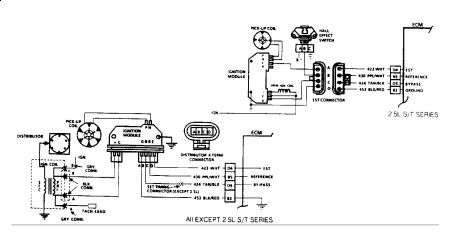

It seems that code 42 is related to the ground of the control module mounted on the distributor. Now what I need you to do is disconnect the 4 pin connector to the distributor and use the pic below to find pin A and check it. What you do is use a digital multi meter and ohm between term A and gound is there continuity? Get back to me with what you find. We will check the ESC Module next if this checks ok. I do need to know what size truck 1/2 ton or ? and what engine as the 305 has a different ESC then the 350 and so on.

do i check on the ign module or the connector side ?
the eng is a 350. 1/2 t
Jan 22, 2010 at 5:17 AM
CARPNTA
  • 5 POSTS
checked the a term. on the ign module, checks ok

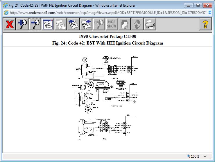

I have a 90 Chevy Silverado, 5.7 Truck is running sluggish, has a code 42, with vehicle running I unplugged the EST wire and it almost died so i would say its getting a good connection between the distributor and the ECM. I replaced the module in the distributor, still runs the same. Not sure where to go from here.
Oct 22, 2018 at 12:18 PM (Merged)
SATURNTECH9
  • 30,869 POSTS
Do you have a multimeter to do some testing?
JHENRIKSEN
  • 18 POSTS
yes
JHENRIKSEN
  • 18 POSTS
Yes I do
SATURNTECH9
  • 30,869 POSTS

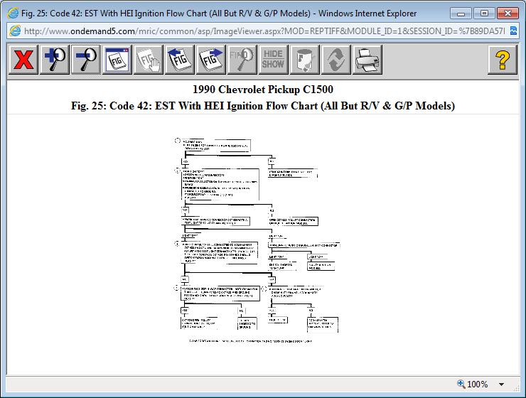

I posted the wire diagram and troublke tree for you follow them and let me know what you find.

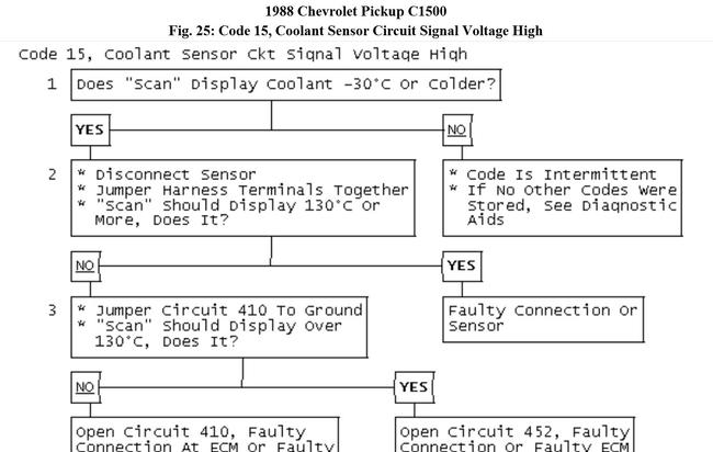

When I conect the temp unit it wont idel in gear, But if I disconect the temp unit it will idle fine when in gear, ANY IDEAS IM RELLY GRASPING FOR A ANSWER, the codes show a 15 it is the temp unit

Saturntech9, I'm not able to read the text in the diagrams, real blurry and blotchy

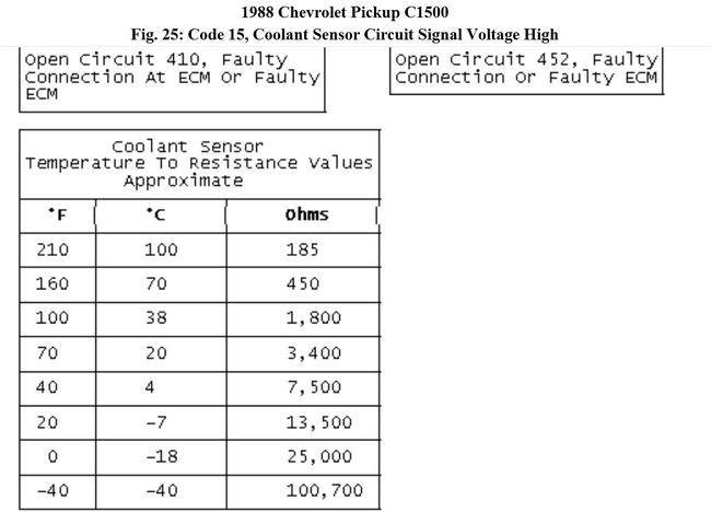

Code 15 is Coolant Sensor Signal Voltage Low.
When the ECM gets this signal, it would think that the engine is cold and would induce a richer fuel supply hence the poor idling. Did you replace the sensor and/or checked its wiring? It could be the sensor, its wiring or ECM fault.
Oct 22, 2018 at 12:19 PM (Merged)
CHEVYUP
  • 5 POSTS
I replaced the unit by the thermastat housing (auto zone), same thing wont idle in gear, I replaced the ecm, still the same
KHLOW2008
  • 41,814 POSTS
Are you still getting the same code?
Did you test the wiring?
CHEVYUP
  • 5 POSTS
checked wiring all ok, still getting same code 15,,,,new info ,,,,sometimes it will idle fine other times it will not

KHLOW2008
  • 41,814 POSTS
This means the problem is most likely intermittent and could be due to a loose wire, ECM or the charging system.
The chart below shows how to go about testing the circuit.

I borrow this thread, hope it´s OK. I have the same problem with my TBI code 42. And I have checked the Pin A blk/red from the control module to ground and theres no ground there.. is my ECM bad or can i hook this blk/red cable directly to ground and see if this solve my problem?
Nov 10, 2018 at 5:07 PM
  • 55,224 POSTS
Yes, try to introduce a new ground to see if that fixes it. If not I would try a used/rebuilt ECM. Please let us know what you find we are interested to see what it is.
