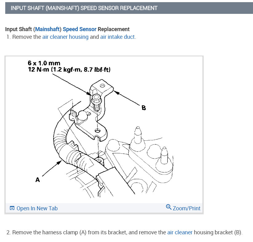

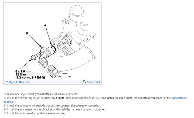

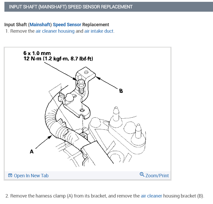

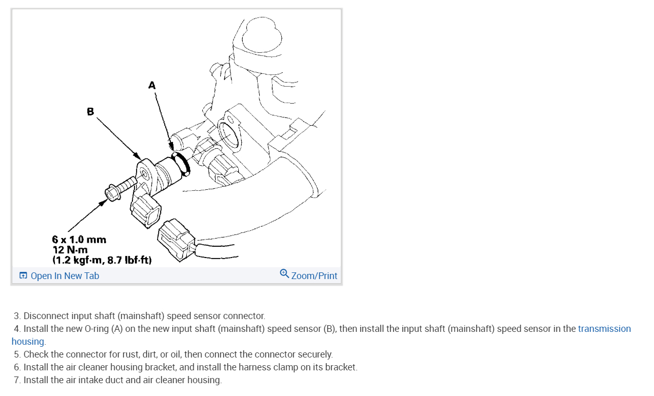

Good day, The D light is blinking on my car. I scan the car to try to figure out the problem. and it return the error code 70-03 (A/T system Malfunction). Can you provide me with some assistance or some guidance as to how can I go about serving this problem? Thank you.

9 times out of 10 it is the input shaft speed sensor. here is a video that shows how the job is done on a similar car with diagrams below to help you with your car:
https://youtu.be/f3bETtCIdxM
