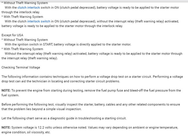

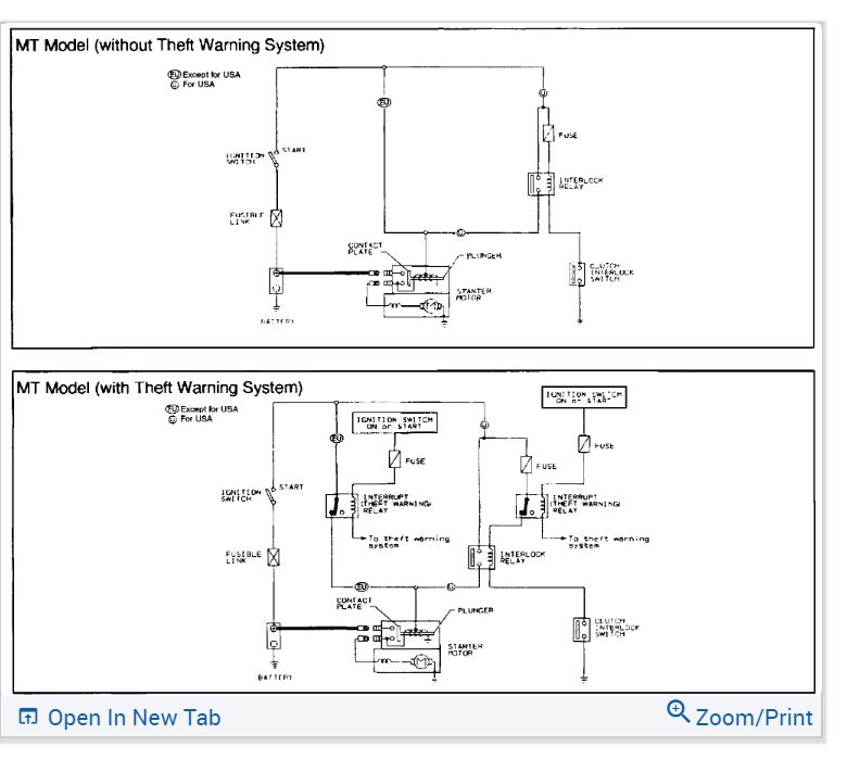

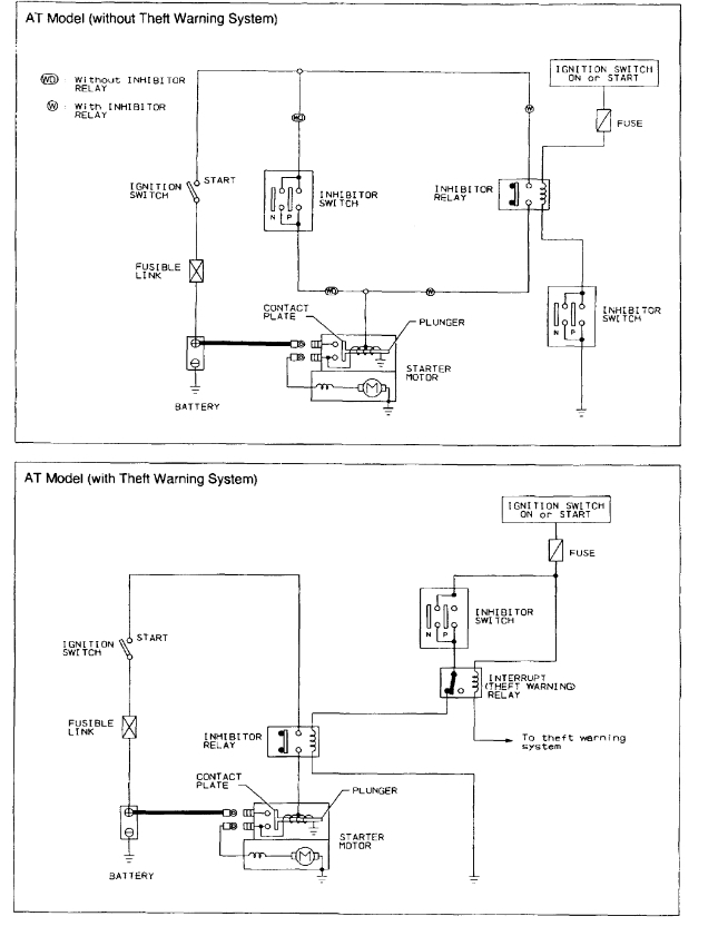

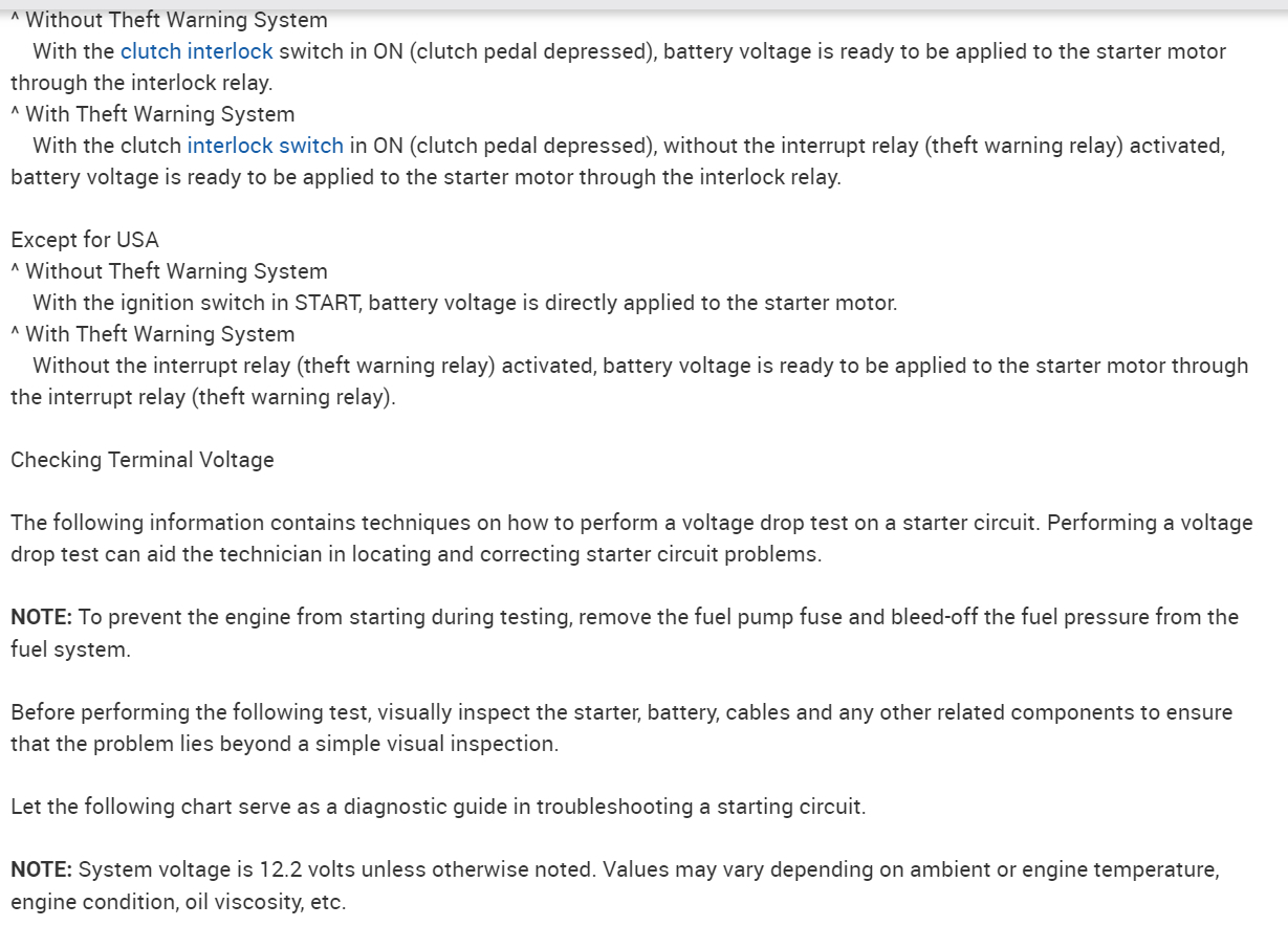

Battery is good. Starter and solenoid are brand new. Sometimes I have to turn ignition switch several times to get power to starter, sometimes turning very slowly, if at all. I have bypassed the clutch interlock, just to prove to myself through process of elimination. I have a starter relay, and ignition relay ordered. I guess ignition switch next. Wish I knew how to check this starter circuit without guessing and throwing new parts at it. Any suggestions?
Feb 9, 2019 at 1:33 AM
SCGRANTURISMO
  • 4,897 POSTS

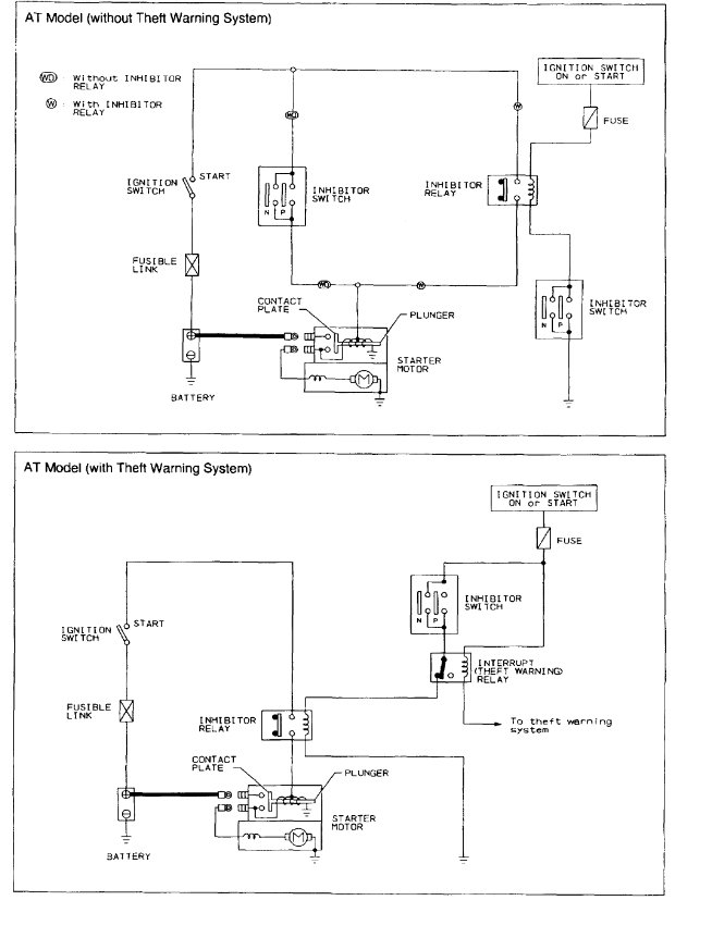

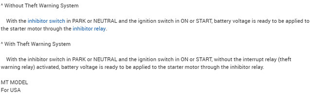

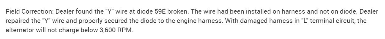

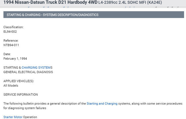

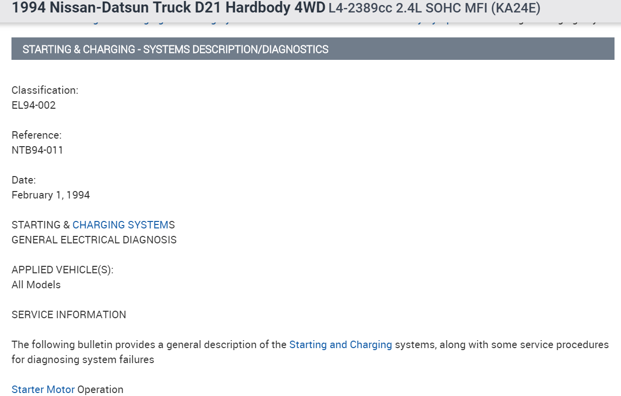

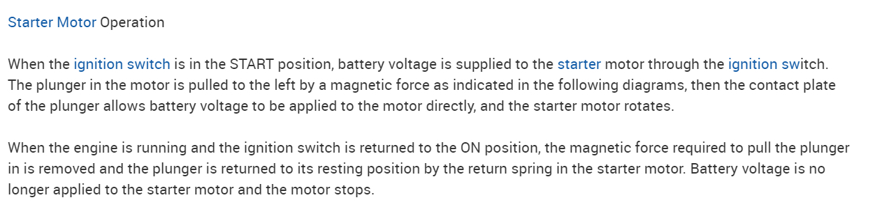

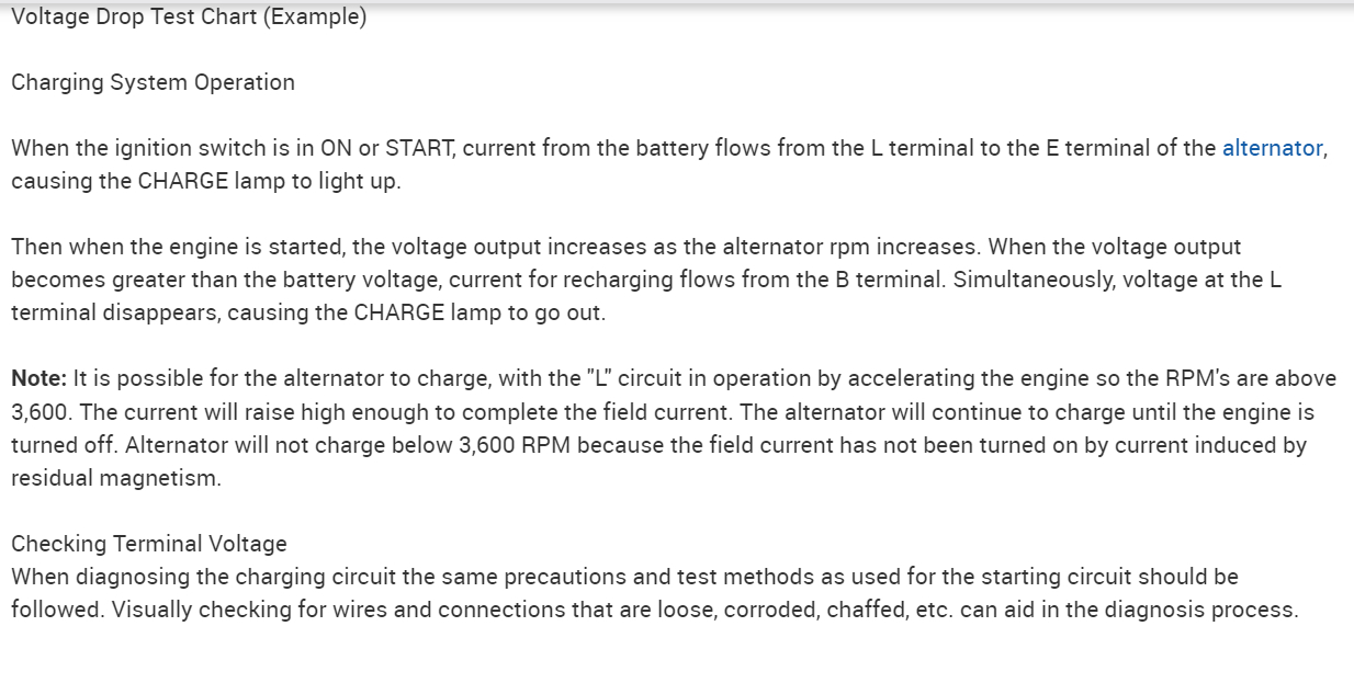

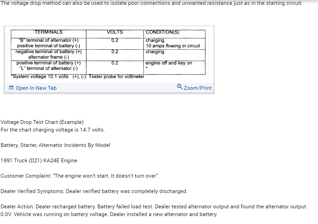

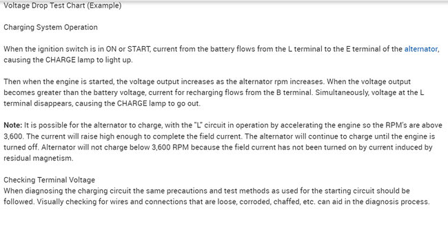

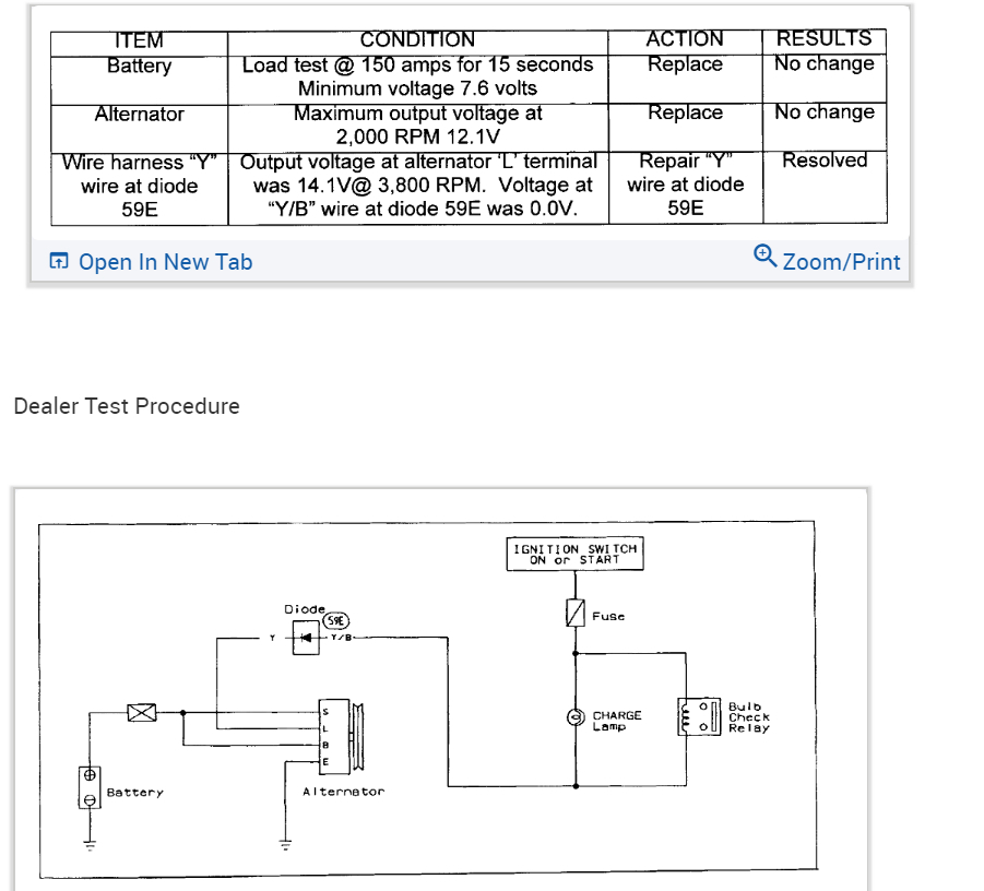

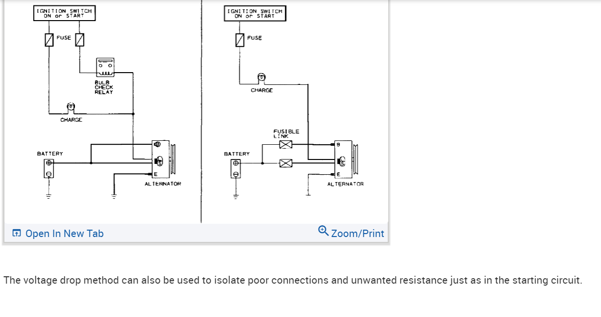

I have included a flowchart on the starting and charging system on your truck below in the diagrams. Go through it and let us know what you find out.
Thanks,
Alex
