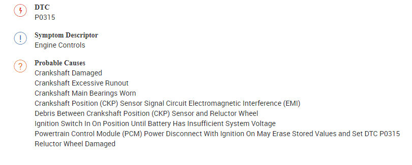

New update: Finally got someone to come out and program the new ECM I installed. Car is running, but still a little rough at idle and doesn’t quite shift properly still. I put my scanner on it and now I have dtc p0315. Will this clear on its own or do I need to worry about it?

Hello again,
No, it is an active code.

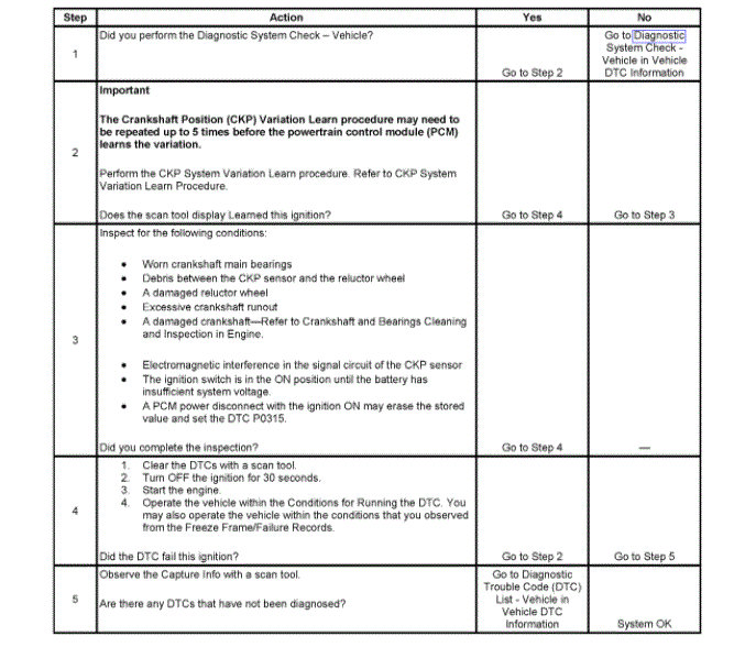

I attached the possibilities and the flow chart for you to view.
DTC P0315
CIRCUIT DESCRIPTION
The crankshaft position (CKP) system variation learn feature is used to calculate reference period errors caused by slight tolerance variations in the crankshaft, and the crankshaft position sensors. The calculated error allows the powertrain control module (PCM) to accurately compensate for reference period variations. This enhances the ability of the PCM to detect misfire events over a wider range of engine speed and load.
The CKP system variation compensating values are stored in PCM memory after a learn procedure has been performed. If the actual CKP variation is not within the CKP system variation compensating values stored in the PCM, DTC P0300 may set.
If the CKP system variation values are not stored in the PCM memory, DTC P0315 sets.

Hello again. I have an update on this and need a little more guidance. I spoke with the man who programmed the new ECM for me about this DTC. He told me he never programmed it because the car wouldn't start after he did the rest of the programming. I remember it having a broken wire in the ignition switch at that time. He told me he will be happy to come out and take care of the problem for me, but I need to have the car running right before he can do it. He also told me the rough idle and transmission not shifting properly are not side effects of this DTC and I need to figure that out. The car is not showing any other DTC's than this one. At the time that I replaced the head gasket in this car, I did every item that came in the head gasket set, as well O2 sensors, plugs and wires. Can you give me a direction to look in?

That should be good enough for him to program it. The crank relearn is done in the park position.

Okay. Also, when I got home, I put the code reader on it and now it’s reading a misfire. So I have to figure that out, but I’m wondering about the transmission not shifting out. I will get to 3k-4K rpm before it shifts even when I’m not getting into the gas...
Feb 12, 2021 at 8:23 AM
One step at a time.
Get it programmed.

Programming is done. Still has misfire. Car stalled this morning in my way to work and then wouldn’t turn over. Turned the key and had dash lights all come on, but didn’t turn over. After it sat for a while, it started right up. Thoughts?
Feb 16, 2021 at 12:55 AM
Okay, that is a separate issue from not starting. We can only deal with one issue per question.
Please start a new question and we will be glad to help with the misfire issue.
