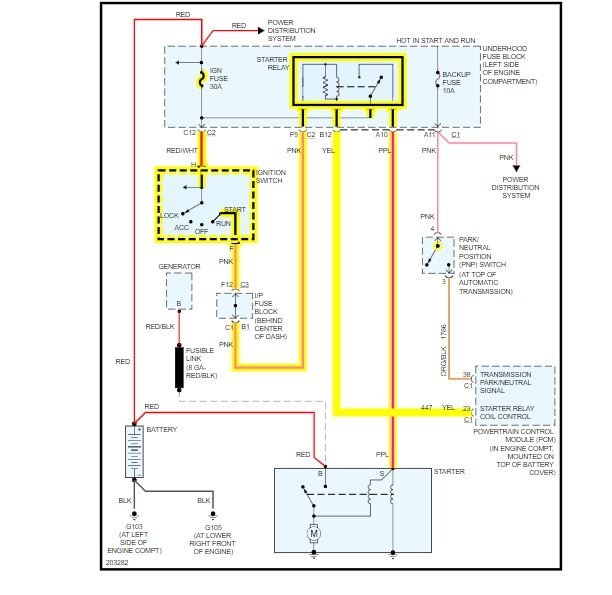

Sometimes when I turn the key, it starts right up. Sometimes I turn the key and get nothing at all. If I leave the key on and get under it and jump across the starter with a screwdriver, it will spin, but won't kick in and engage with the flywheel. I replaced the starter, and have the same results. Is there a way to test the relay? Or should I be looking somewhere else?
Jun 20, 2020 at 5:09 AM
Good afternoon,
I attached a wiring diagram for you to view.
Do you have a test light or voltmeter to do checks on the starting system?

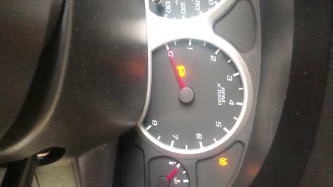

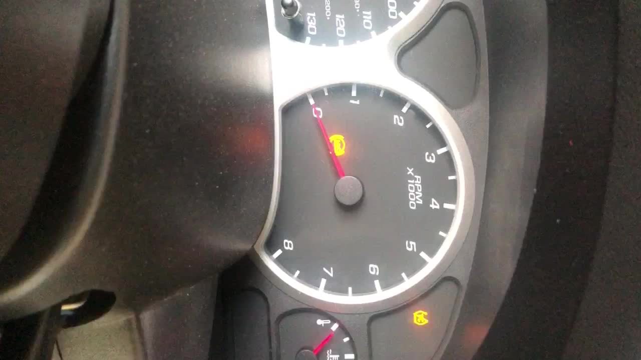

I tried all the steps you forwarded to me and they didn’t work. I left the battery disconnected overnight, still nothing. I turned the key in this morning and after just 2 or 3 minutes, it started doing this (see video). As of now, the security light is not on, but it still won’t turn over.
Jun 21, 2020 at 12:12 AM
Okay, I could not hear a thing. What was being done during that video?
Jun 21, 2020 at 12:16 AM
DANE DESPAW SR.
  • 75 POSTS
I was just sitting with the key in the on position. The security light and a couple other lights started flashing rapidly and then the security light turned off. It was staying on and solid (not flashing) before this occurred.

Okay, you need to go to the relay.
With the key on, remove the relay and test for power at one of the pins. You should have 1 pin with power.
Then have someone hold the key to the start position and there should be power to another pin.
I posted the wire diagram in my first response.
Jun 21, 2020 at 1:54 AM

Okay, the control side is working.
Go to the starter itself and the little wire on the solenoid. The little purple wire should have power in the start position.
If it does, you need a starter motor.
If it does not, then you have a wiring issue between the fuse block and the starter solenoid.
Jun 21, 2020 at 2:18 AM

If the relay energizes when you turn to start, the control side is working.
Did you verify no power to the purple wire at the starter solenoid?
Jun 21, 2020 at 2:51 AM
DANE DESPAW SR.
  • 75 POSTS
Relay has two pins energized in start and on position. No other pins energize when in start position.
Jun 21, 2020 at 2:55 AM
There should not be any power on the other 2.
We are beyond that now and working on the purple wire to the solenoid.
Again, if you have no power to the solenoid, and the relay is clicking, you have an open in the purple wire from the relay to the solenoid.

Yesterday after I got home from work, just for grins, I tried starting the car. All the warning lights in the dash came on as expected, including the security light. It went back out as it should. When I tried turning the key to start, the security light began flashing rapidly, just like it did in the video I sent you a couple days ago. I’m thinking the issue may still be with the security system. Thoughts?
Jun 23, 2020 at 3:23 AM
Yes, I agree.
Can you check for any codes set and did you try the reset for the system?

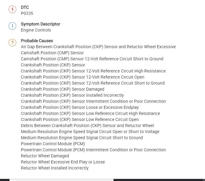

It was registering an engine misfire code. But I replaced the plugs and plug wires and that stopped that problem. Now it’s showing engine speed input circuit no signal (P0727) and crankshaft position sensor (P0335).
Aug 24, 2020 at 7:23 AM

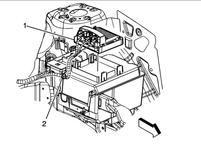

Okay, the 727 code has only 1 result. You need a ECM. It has failed. You need to replace that first before looking at the 335. The 727 could take care of that code as well.
It also take care of all you other issues.
Aug 24, 2020 at 7:31 AM
DANE DESPAW SR.
  • 75 POSTS
Ouch!! Okay, how difficult is it to program to the vehicle?
Aug 24, 2020 at 7:41 AM
You need an advanced scan tool with access to GM technical web site to download the software.
Otherwise, you need a shop to do this for you.
