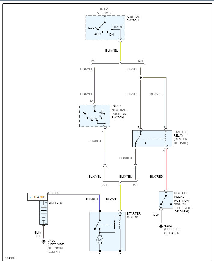

My vehicle (listed above) at times will not turn over, it has a clicking sound from the starter which is new and starts when it wants to. When it finally starts it does so more frequently and then chooses not to intermittently. could it be the crank angle sensor? that i cannot find on the NH model.
some answers would be appreciated.

Okay. We don't have a manual on this vehicle as it is not offered here in the USA but if you get a clicking noise from the starter then the starter solenoid is normally the issue.
However, there are other things that will cause this if the starter is new. Here is a guide that will help with getting us started:
What I would suggest you start with is going to the starter when this is acting up and check the voltage on both wires when you are trying to crank the engine.
You should have 12-volts on both wires.
I am attaching the wiring diagram from the version of this vehicle that is offered here in the USA as they should be pretty similar.
The most likely cause of this is a relay or clutch position switch in your case. So, you can also take the connector of the switch off and jump the terminals and see if the starter works at that point.
However, I suspect we will find the starter, even though it is new, is the issue or you have low voltage on one of the wires and that is going to be due to resistance or some other connection issue.
So, let's start with getting these voltages when this happens, and we will know what to do next. Thanks
