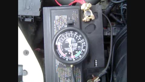

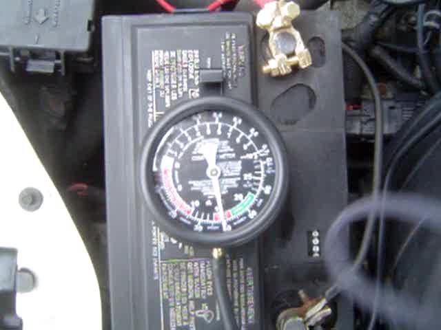

I ran some tests with the vacuum gauge and the only test that does not meet specs is it reads between 15 – 16 psi at idle. Further, I applied a ground to the EGR solenoid and the engine runs rough. I checked the EGR Valve with my vacuum gauge and it held a vacuum at -20 psi, I could also hear it close when I released the vacuum. I also checked the vacuum hoses from the intake manifold to the solenoids and fuel pressure sensor. Because I could not find the electrical diagram, I did not test the DPFE for the 4 volts when I applied the ground but switched it with the DPFE from the 2000 Ford Taurus VIN U that ran fine.

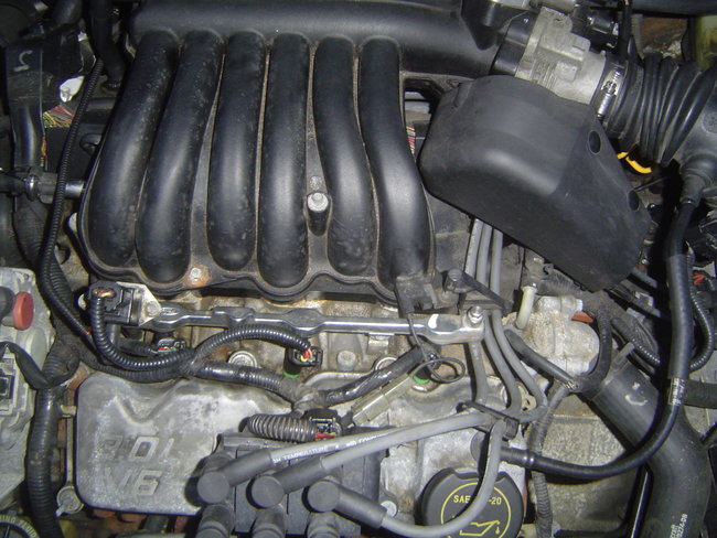

I was unable to compare the fuel pressure with the 2000 Ford Taurus due to the fuel inline connector being stuck and the 2003 does not have a Schrader valve on the rail nor the fuel pressure sensor. The inline fuel pressure before the fuel pressure sensor reads 17 psi which seems low but does not explain how the car can perform with no problems when on the highway. I changed the fuel filter but it made no difference.

Is the vacuum at idle steady or does it fluctuate? Can you upload a video of the vacuum reading?

Ref: Vacuum and Compression: I was unable to check the compression, but here is the video of the engine's vacuum at idle and I accelerated the engine twice. Please note, this car has plenty of power going up hills and the mountain.
Ref: Fuel Pressure: I do not have the proper adapter, my chrome rails (see picture) have plugs in them. I remove the plug and my adapter does not screw in properly, I believe threads are not the same. I did use it but it leaked when I checked the fuel pressure, 34-35 psi.

Okay, the vacuum is low. It should be at least 18.
