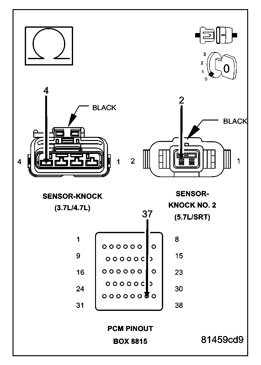

Here the the issue: it was crankshaft sensor codes do i change out the crankshaft and the cam sensor? po330 code. now there are no codes, but now when i turn on the key it turnover but will not start.
Also change out the spark plugs
My friend has check all fuse sand relays.
Dec 10, 2020 at 11:40 PM
  • 110,248 POSTS
I need to understand what is happening. The P0330 is related to the knock sensor. So, that is something different. Have you already replaced the crankshaft position sensor? If so, have you checked to see if there is spark to the plugs? If you have a live data scan tool, see if there is an RPM signal when cranking it. Also, the tachometer should move a bit as well.

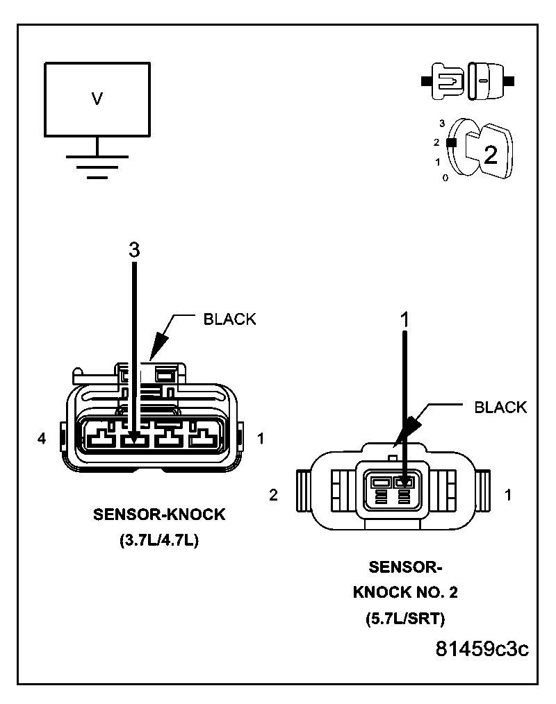

Here are the diagnostics for the P0330. The attached pics correlate with the directions.
___________________________________
2005 Jeep Truck Grand Cherokee 4WD V6-3.7L VIN K
P0330
Vehicle ALL Diagnostic Trouble Codes ( DTC ) Testing and Inspection P Code Charts P0330
P0330
P0330-KNOCK SENSOR 2 CIRCUIT
P0330-Knock Sensor 2 Circuit
pic 1
WHEN MONITORED
Engine running
SET CONDITION
The Knock Sensor circuit voltage falls below a minimum value at idle or deceleration. The minimum value is from a look-up table internal to the PCM and is based on engine RPM. DTC well also set if the sensor voltage goes above 5.0 volts. One Trip Fault. Three good trips to turn off the MIL. One Trip Fault. Three good trips to turn off the MIL.

2. (K242) KNOCK SENSOR NO.2 SIGNAL CIRCUIT SHORTED TO BATTERY VOLTAGE

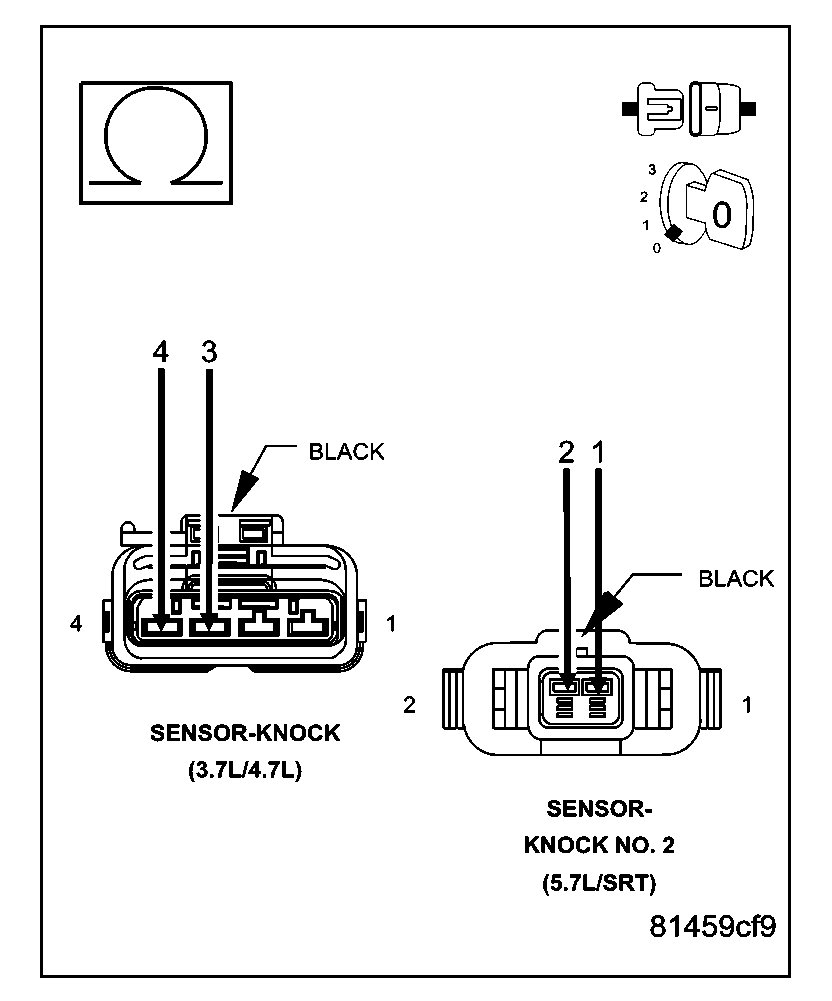

pic 2
Turn the ignition off.
Disconnect the No.2 Knock Sensor harness connector.
Disconnect the C2 PCM harness connector.
Ignition on, engine not running.
Measure the voltage on the (K242) Knock Sensor No.2 Signal circuit in the Knock Sensor harness connector.
Q: Is the voltage above 2.0 volts?
YES: Repair the short to battery voltage in the (K242) Knock Sensor No.2 Signal circuit. Perform the POWERTRAIN VERIFICATION TEST. See: A L L Diagnostic Trouble Codes ( DTC ) > Verification Tests > Powertrain Verification Test
NO: Go To 3

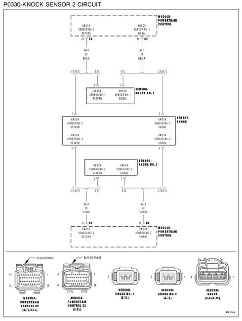

3. (K242) KNOCK SENSOR NO.2 SIGNAL CIRCUIT OPEN
pic 3
CAUTION: Do not probe the PCM harness connectors. Probing the PCM harness connectors will damage the PCM terminals resulting in poor terminal to pin connection. Install Miller Special Tool #8815 to perform diagnosis.
Measure the resistance of the (K242) Knock Sensor No.2 Signal circuit from the Knock Sensor harness connector to the appropriate terminal of special tool #8815.
Q: Is the resistance below 5.0 ohms?
YES: Go To 4
NO: Repair the open in the (K242) Knock Sensor No.2 Signal circuit. Perform the POWERTRAIN VERIFICATION TEST. See: A L L Diagnostic Trouble Codes ( DTC ) > Verification Tests > Powertrain Verification Test

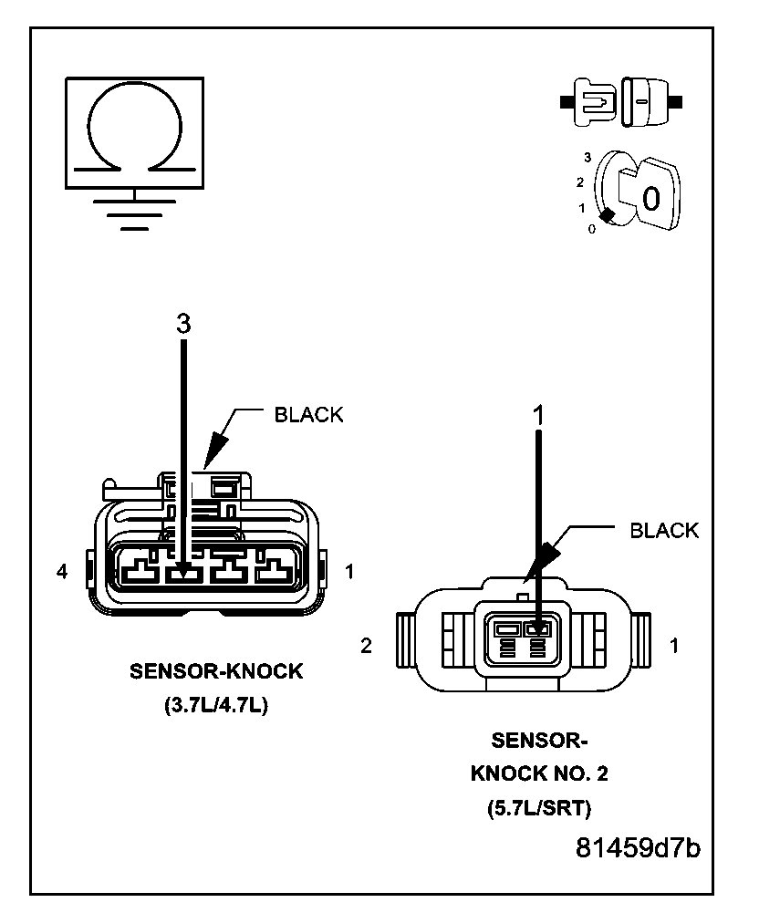

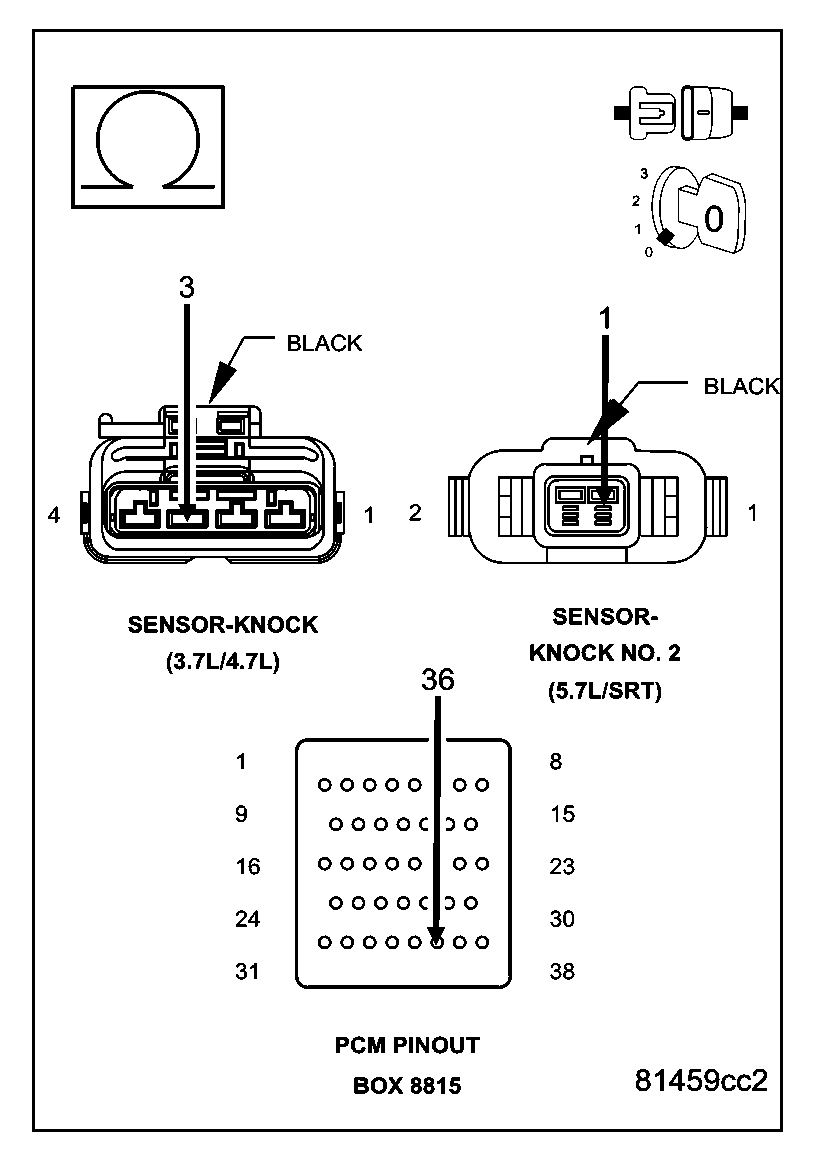

4. (K924) KNOCK SENSOR NO.2 RETURN CIRCUIT OPEN
pic 4
Measure the resistance of the (K924) Knock Sensor No.2 Return circuit from the Knock Sensor harness connector to the appropriate terminal of special tool #8815.
YES: Go To 5
NO: Repair the open in the (K924) Knock Sensor No.2 Return circuit. Perform the POWERTRAIN VERIFICATION TEST. See: A L L Diagnostic Trouble Codes ( DTC ) > Verification Tests > Powertrain Verification Test

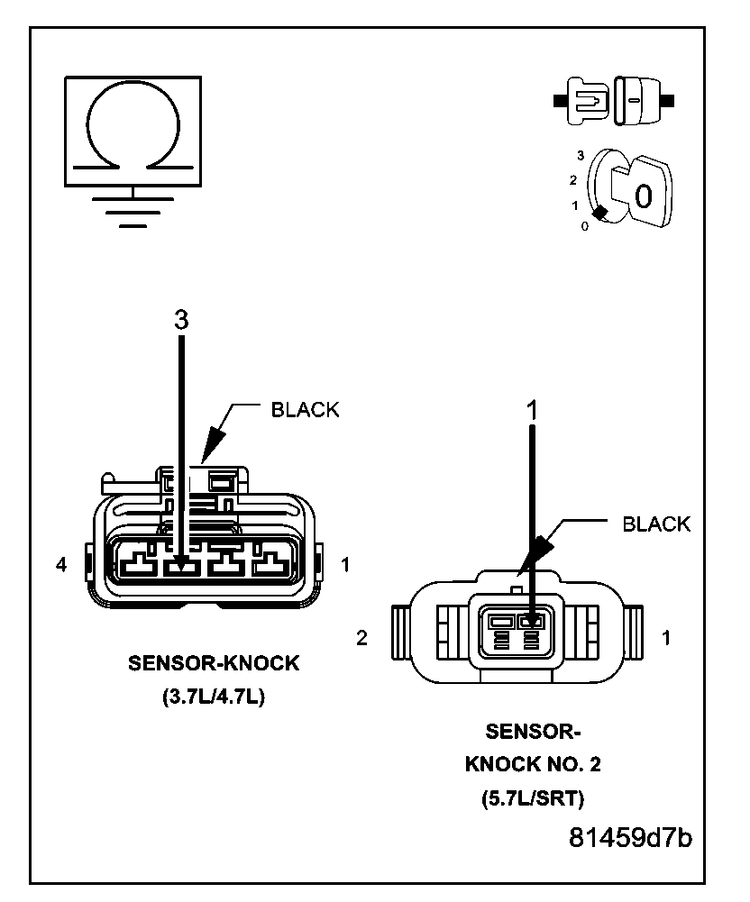

5. (K242) KNOCK SENSOR NO.2 SIGNAL CIRCUIT SHORTED TO THE (K924) KNOCK SENSOR NO.2 RETURN CIRCUIT
pic 5
Measure the resistance between the (K242) Knock Sensor No.2 Signal circuit and the (K924) Knock Sensor No.2 Return circuit in the Knock Sensor harness connector.
Q: Is the resistance below 100 ohms?
YES: Repair the short between the (K242) Knock Sensor No.2 Signal circuit and the (K924) Knock Sensor No.2 Return circuit. Perform the POWERTRAIN VERIFICATION TEST. See: A L L Diagnostic Trouble Codes ( DTC ) > Verification Tests > Powertrain Verification Test
NO: Go To 6

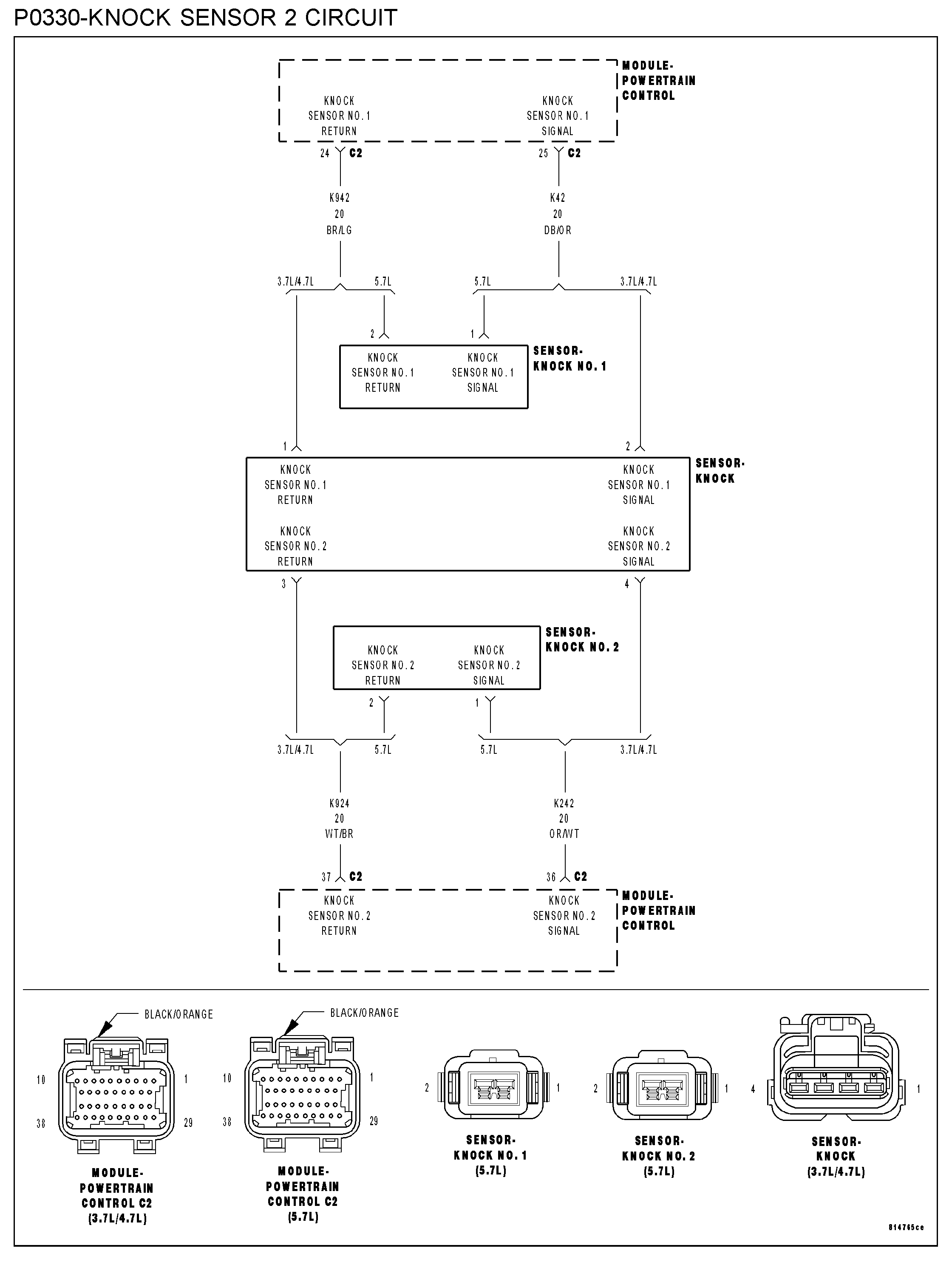

6. (K242) KNOCK SENSOR NO.2 SIGNAL CIRCUIT SHORTED TO GROUND
pic 6
Measure the resistance between ground and the (K242) Knock Sensor No.2 Signal circuit in the Knock Sensor harness connector.
YES: Repair the short to ground in the (K242) Knock Sensor No.2 Signal circuit. Perform the POWERTRAIN VERIFICATION TEST. See: A L L Diagnostic Trouble Codes ( DTC ) > Verification Tests > Powertrain Verification Test
NO: Go To 7

Got spark, got fuel smell when trying to start sprayed starting fluid no start. i replaced cam and crank sensor. knock sensor good. No codes.
Dec 12, 2020 at 8:42 AM
  • 110,248 POSTS
If you have spark and fuel, it should run unless there is a compression issue. It does have a lot of miles, but it wouldn't have happened all at once.
Do me a favor, after trying to start it, remove a couple of spark plugs and see if they are wet. If they are dry and you do have spark, then we need to check for an injector pulse. However, if you used starting fluid, it should have started at least for a second or two.
