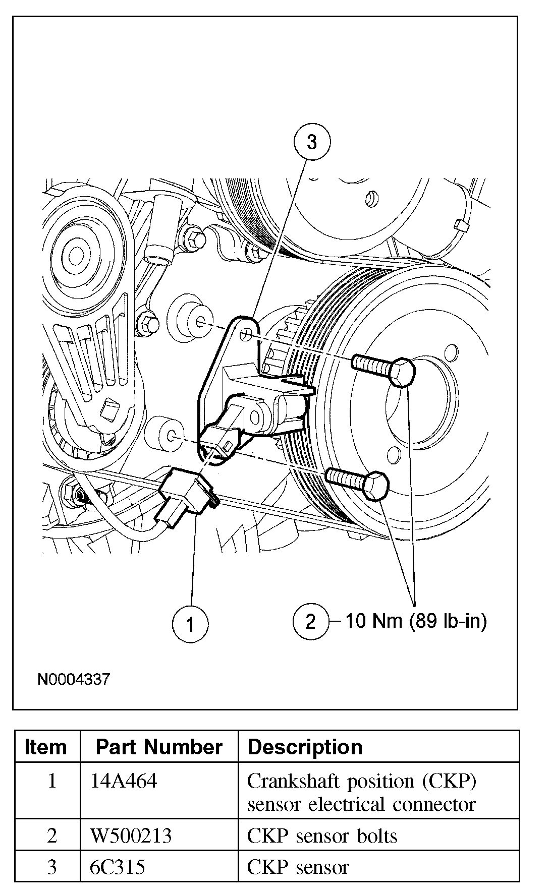

Hello, the vehicle shuts off any time on the express way. when this happens it won't crank at all if attempt is made. leaving the vehicle for some time, the engine might start and runs well but after sometime it shuts off. I have scanned it but no good codes that could be responsible is found. What could be the problem?

It sounds like it could be related to the crankshaft position sensor. When they start going bad, they are affected by heat. Once they cool off, they can work again. Interestingly, oftentimes they don't set a code.
Take a look through this link. It explains common symptoms of a bad crankshaft position sensor. See if anything mirrors what you experience.
If that seems like the issue, here is a link that explains how in general one is replaced. To confirm, check to see if there is spark to the plugs or if there is an RPM signal using a live data scan tool.
Here are directions specific to your vehicle. The attached pic correlates with the directions.

REMOVAL AND REPLACEMENT
CRANKSHAFT POSITION (CKP) SENSOR
Pic 1
Removal and Installation
1. With the vehicle in NEUTRAL, position it on a hoist.
2. Disconnect the crankshaft position (CKP) sensor electrical connector.
3. Remove the bolt and the CKP sensor.
- To install, tighten to 10 Nm (89 lb-in).
4. NOTE: Be sure the sensor wiring is routed away from the battery cable.
To install, reverse the removal procedure.
