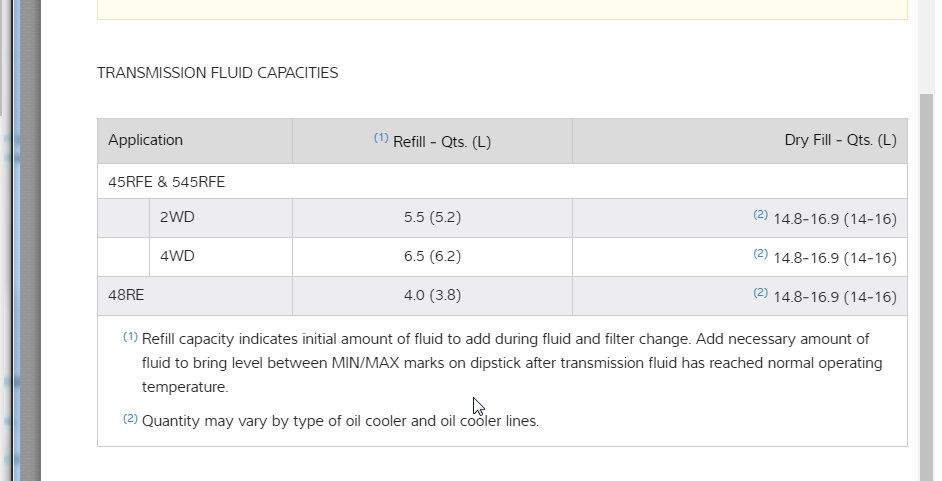

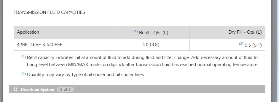

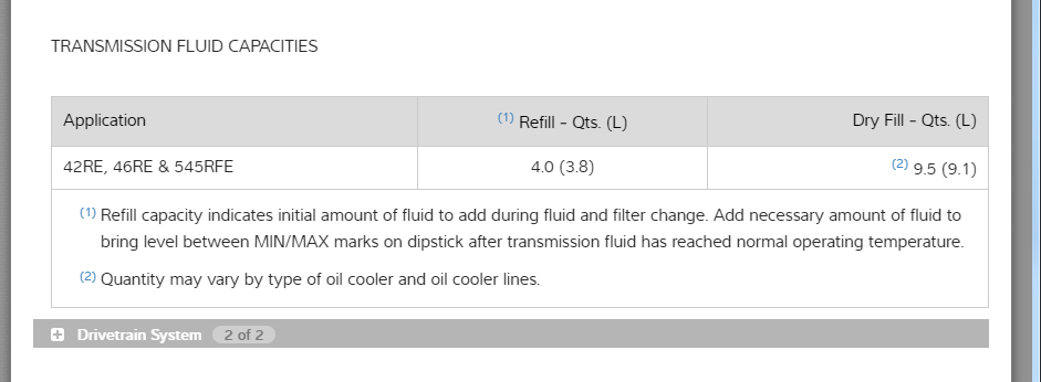

First, what transmission is in both units? If they are different then you will most likely have to account for that. They are both RFE transmissions but the cases could be different so the mounts are going to be different. Then you will have to deal with the different mounting locations for the engine.
