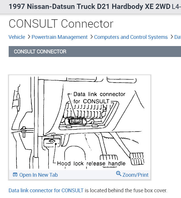

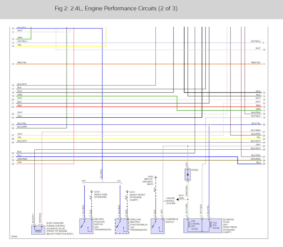

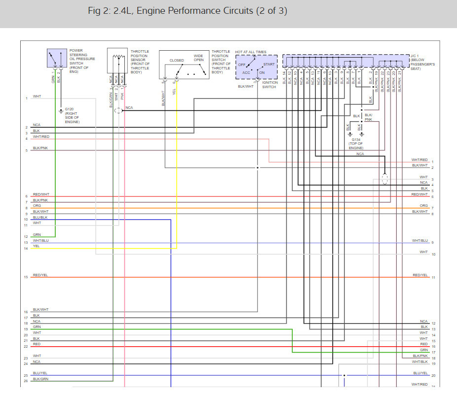

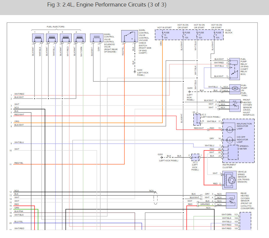

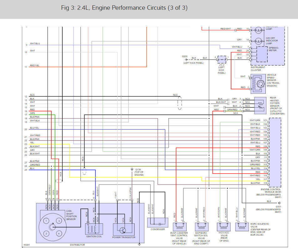

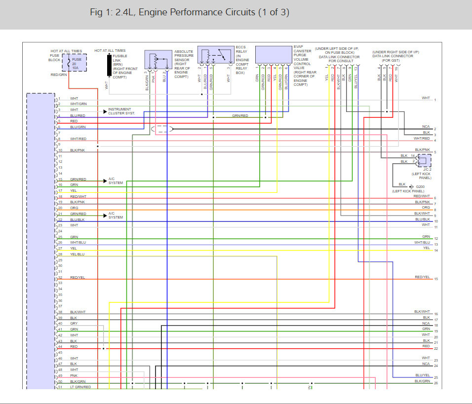

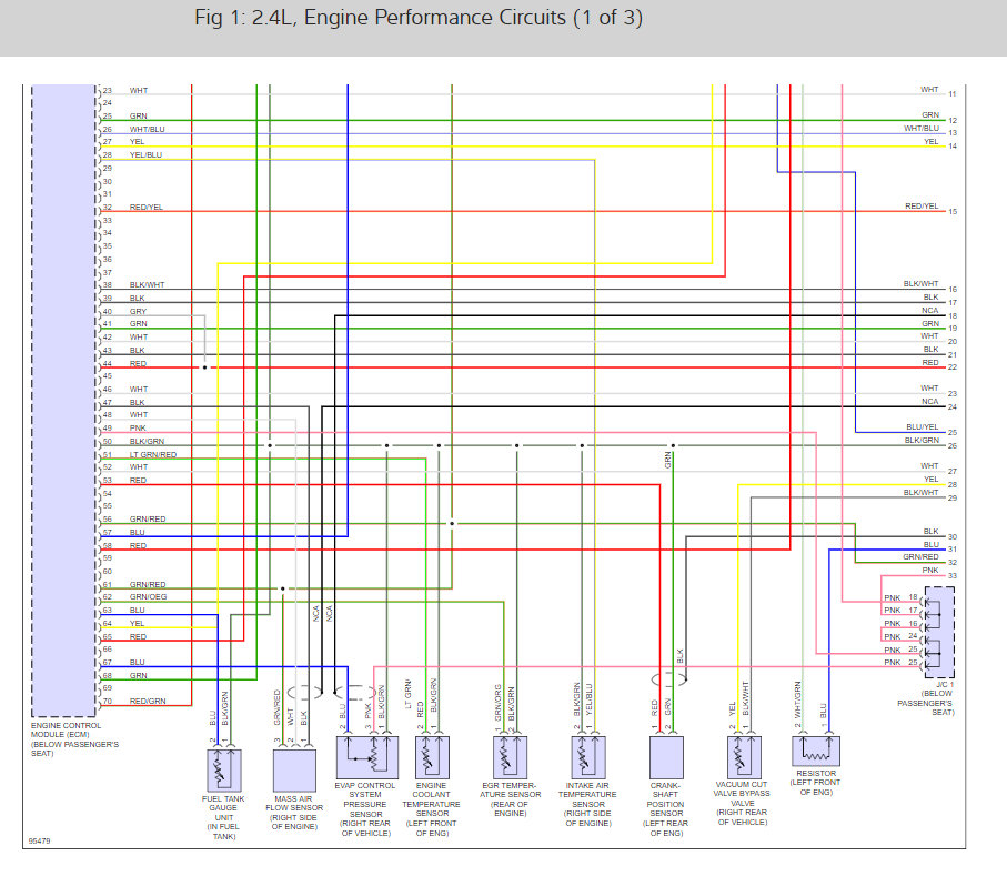

This sounds like you have a clogged catalytic converter or a bad map. Here is the location of the data link connector and the engine wiring diagrams so you can see how the system works. Please run the codes before you begin.

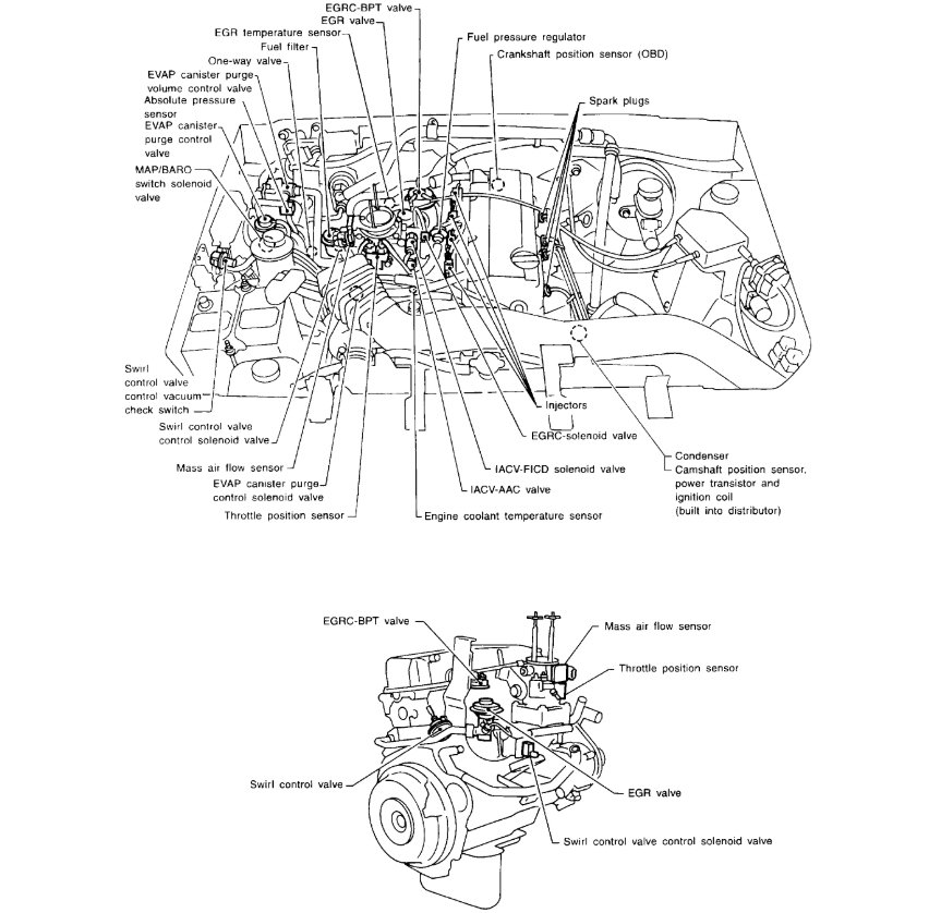

Thanks Ken I would be so happy if that's the problem. I've replaced everything you can think of and completely rebuilt this engine. But I just replaced all injectors and the distributor .All new. I put new plugs in as well what gets me is after 5 minutes of running the engine the plugs are very black but dry.No wet gas. Also a strong smell of gas when I turn the engine off. I have not loosened the pipe from the converter but it's very easy to get to. So that's my next job. And if that doesn't work I'll have to replace the Map. Where is it located???

Please do here is the location of the MAP sensor below.
