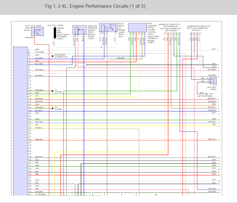

Okay, all prior issues resolved with one exception. I will describe.
1. Wiring harness issues. Fixed
2. Vacuum hoses all hoses connected.
3. Injector stuck open. Replaced.
4. Current problem I cannot resolve.
Engine surges at 2,500 rpm. idles perfect. Starts good. Runs smooth up to 2,500 rpm. I am going to replace all injectors with new ones. But have a feeling this is not the problem. I also replaced the distributor. Not the problem either. Everything is new on this engine inside and out.with the exception of some sensors. Cannot drive to a garage for diagnosis so I need help diagnosing from home. I do not own a diagnostic tool and cannot find one that fits this truck. 1997 Nissan pickup hard body XE standard shift VIN 1N6SD11S3VC335887. 2.4L.
Manufactured 11/97.16 pin diagnosis input.housing located next to hood latch handle under dash. Replaced spark plugs. And after start up run for five minutes plugs are completely black with smutt. Like an old fashioned smudge pot. I am assuming this is from gas as the engine is running very rich. That is it. If anyone can come up with any suggestions that will shed some light on my problem please do. It has been a year it has taken me to rebuild this truck and it runs so smooth and quiet until it hits 2,500 rpm then it runs horrible. I know one of you guys have encountered this problem before. So please if you read this post. Help!, JC

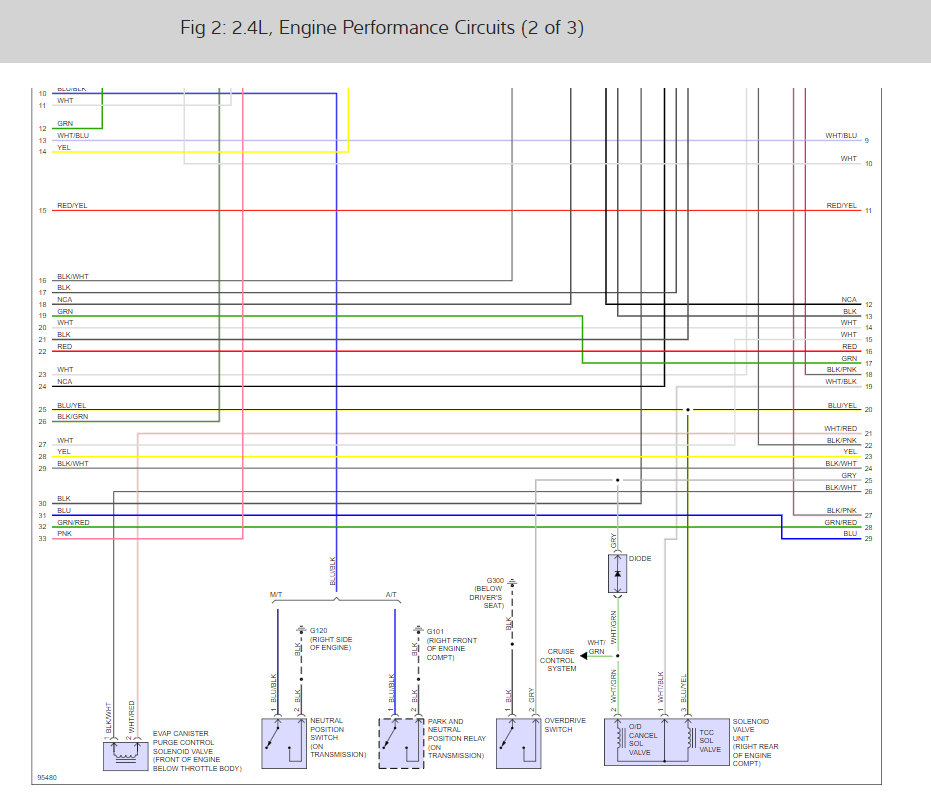

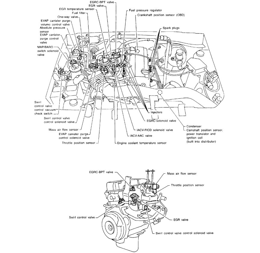

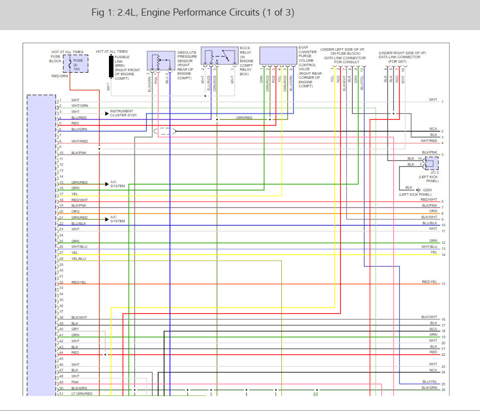

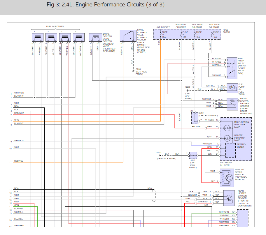

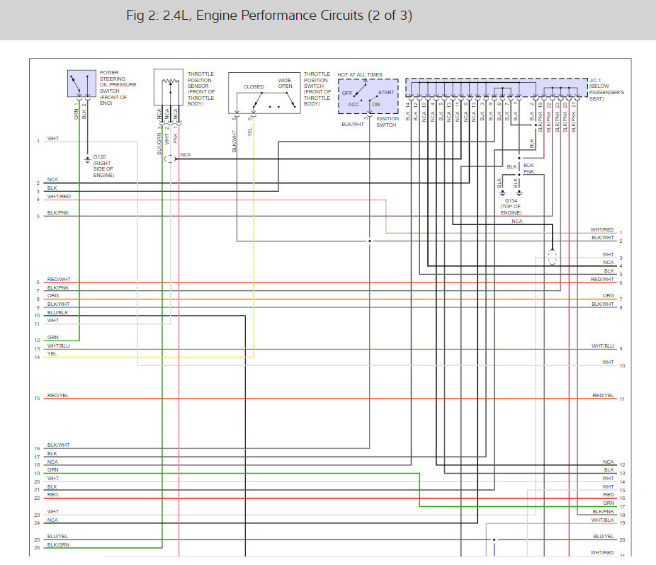

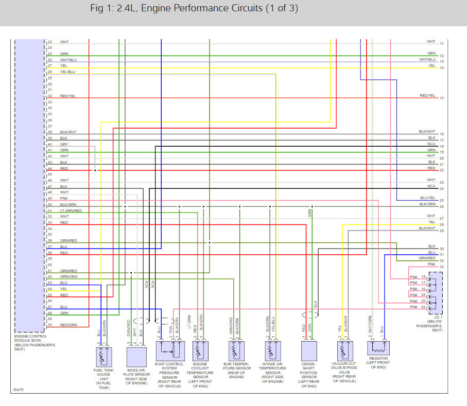

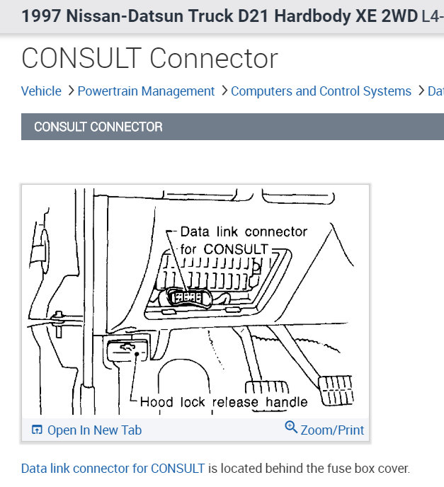

This sounds like you have a clogged catalytic converter or a bad map. Here is the location of the data link connector and the engine wiring diagrams so you can see how the system works. Please run the codes before you begin.
and

Thanks Ken I would be so happy if that's the problem. I've replaced everything you can think of and completely rebuilt this engine. But I just replaced all injectors and the distributor .All new. I put new plugs in as well what gets me is after 5 minutes of running the engine the plugs are very black but dry.No wet gas. Also a strong smell of gas when I turn the engine off. I have not loosened the pipe from the converter but it's very easy to get to. So that's my next job. And if that doesn't work I'll have to replace the Map. Where is it located???
Thanks Ken. I'll let you know tomorrow what I find. JC
Dec 8, 2018 at 9:50 AM
  • 55,214 POSTS
Please do here is the location of the MAP sensor below.

Were you able to run the codes?
Dec 10, 2018 at 3:58 AM
JCLEMO
  • 161 POSTS
No, I was not able to run the codes due to no tool. But I spoke with a mechanic locally. He is saying TPS. But I am not buying anymore parts until I get actron9185. Then I will see what it tells me. There are so many things it could be. I will spend $125.00 on the actron eBay and then run some tests and.go from there I guess. A Hitachi TPS cost almost $100.00 and if that is not the issue there is another $100.00. I have lost. I will keep you posted Ken. Thanks. JC
Dec 10, 2018 at 10:21 AM
  • 55,214 POSTS
Yes please do the scanner you can use for all cars so that is a good purchase. Please let me know.

Okay Ken. Jack here, finally I was able to get the engine scanned. And what I found was BAD MAF. Bad MAP. bad up stream O2 sensor, bad boost sensor. the loop does not close when checking the fuel and air on the MAF. I'm told whatever that means thus the smell of gasoline. The MAF when removed was burnt out the contact wires were missing completely. So it looks like I have to replace a lot of sensors. The guy who did the diagnostic's said I hooked the battery cables up in correctly. You put positive on first and the ground second. You remove the ground first and the positive second.So if that caused the short to my electrical system I guess I learned an expensive lesson. If that is accurate. thanks. Looking forward to hearing your opinion. JC

and map sensors would it not do the same with the ECU as well? Anyway, is there any simple way to test the boost sensor? And is the MAP/baro sensor detrimental to the engines power or can it cause your engine to surge? I would think the MAF controls the gas or air mix would be the main cause of the surging due to the mixed signals going to the ECU. Please advise me would you replace MAP/baro as well? Not a cheap part. Thanks. JC
Dec 18, 2018 at 2:09 AM
  • 55,214 POSTS
There is not an easy way to test the sensor which when in operation can change anyway. I would try used sensors to try and save money. Both MAP and MAF send feedback data to the computer for mixture.
