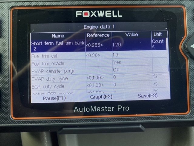

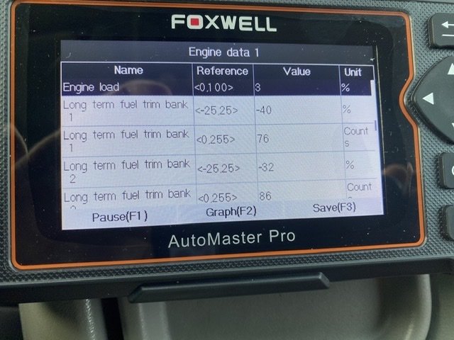

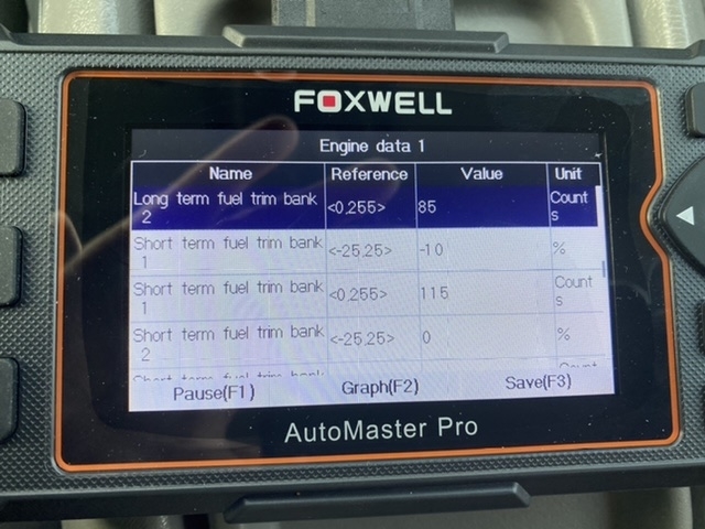

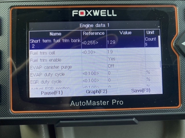

HVACTECH7
  • 21 POSTS
Here’s what it read while I was warmed up, in gear, brake pressed, at idle.

  • 109,885 POSTS
Hopefully that is part of the problem. As far as the fuel trims, I can see the computer is trying to lean the fuel mixture. In other words, the engine is getting too much fuel.
Have you checked fuel pressure and the regulator? Also, can you go back into live data and bring up the oxygen sensors. These sensors should fluctuate between.1v and.9v back and forth. Those are the extremes of the acceptable range. If they are not changing, either the sensor is bad or we have an issue with wiring. Note that if you find the sensor is reading a stagnant reading (not changing or far off from what is considered normal, pull a vacuum hose off the intake and see if it changes the reading. And yes, that can cause the STFT to be off and a rough idle.

  • 21 POSTS
I finally just ended up taking it in. I do AC work and we are swamped! It was the fuel pressure regulator causing the issue and it was even leaking, hence the fuel smell. Just glad it’s fixed. Engine is running absolutely smooth as butter. Thank you guys so much for your help! Really appreciate it!
Friday, May 29th, 2020 AT 6:00 PM
  • 109,885 POSTS
That is why it showed the computer trying to lean the fuel mixture. There was too much pressure.
