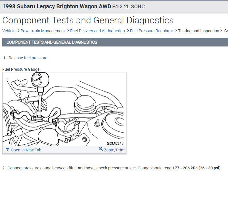

engine starts but then dies a couple seconds later
1998 SUBARU WAGON
255,000 MILES • 2.2L • 4 CYL • AWD • MANUAL
ZACKERYESHELMAN
I have started my engine and it cranks over and turns on but it won't stay running it dies after a couple of seconds and I've moved it ever since I got it started but then dies even though my foot is on the clutch so I would have to rectal it to be able to move it again plz help thank u

This issue can be due to lack of fuel or air.

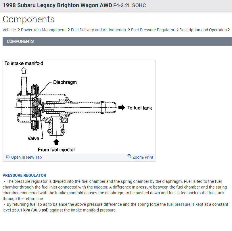

If the fuel pressure does not stay constant after startup the engine will stall, regardless of you pressing the throttle.

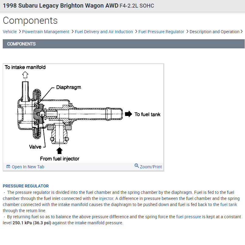

If the fuel pressure regulator cannot keep proper pressure to the injectors the engine might start but will stall afterwards.

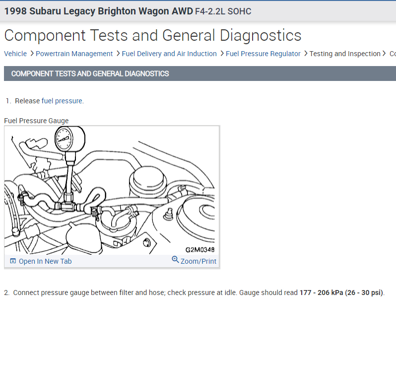

Check the fuel pressure at the rails. The pressure check port is located on the right hand side fuel rail. You should be able to rent fuel pressure test gauge from you local auto parts store.
This vehicle should have 26-30 PSI of fuel pressure.
Here is a helpful video:
https://youtu.be/aITQclp7zIE

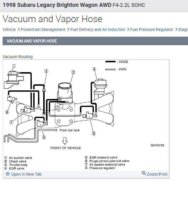

Also if you have a large vacuum leak the engine will not run as well. Check all the hoses under the hood for any damages or cracks.
