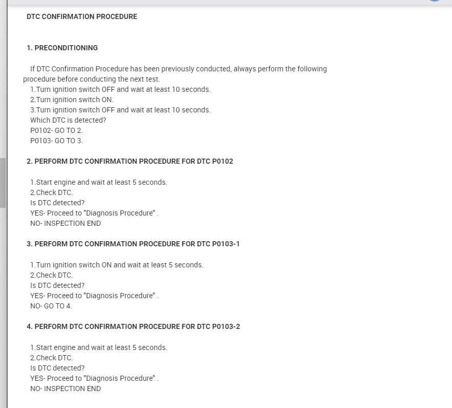

Hello, i bought the car listed above from a person. Firstly, my car will shut off while driving, i have to put it in neutral and start it again. Also, sometimes it will only crank and not start, i have to put fuel directly through the hose of the injectors before it will start. I have serviced the injectors, cleaned the injector mouth, cleaned the mass sensor, changed the fuel pump, checked all fuses, cleaned the cold start. Now it is starting on its own but won't rev up. It shuts off whenever i try to rev up. Please help me out. Thank you. I have also scanned the car.

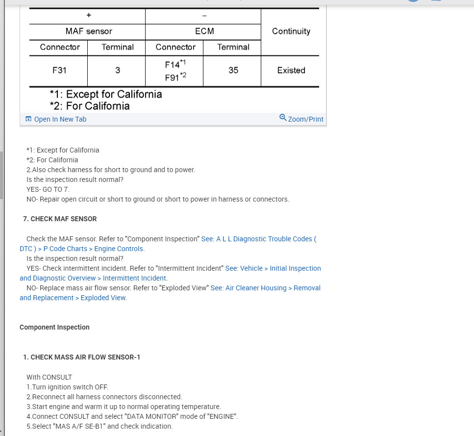

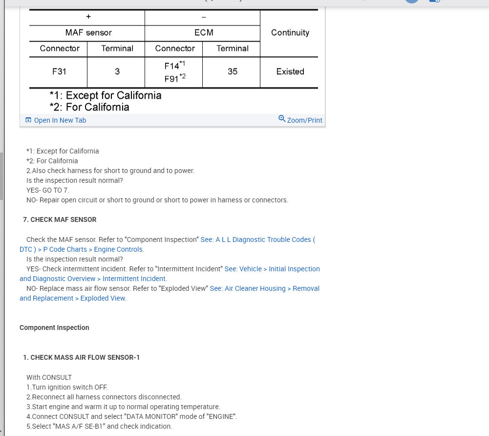

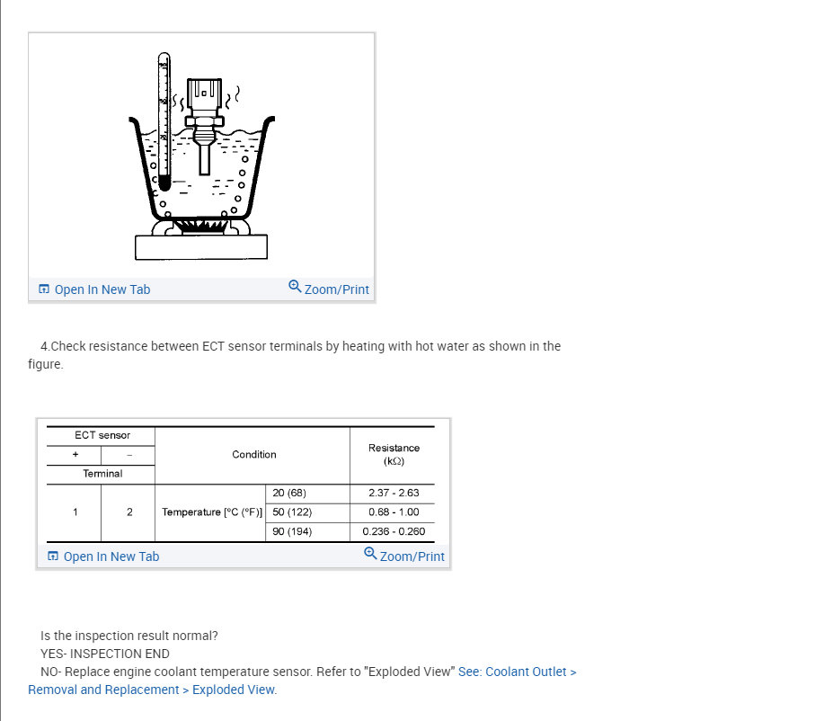

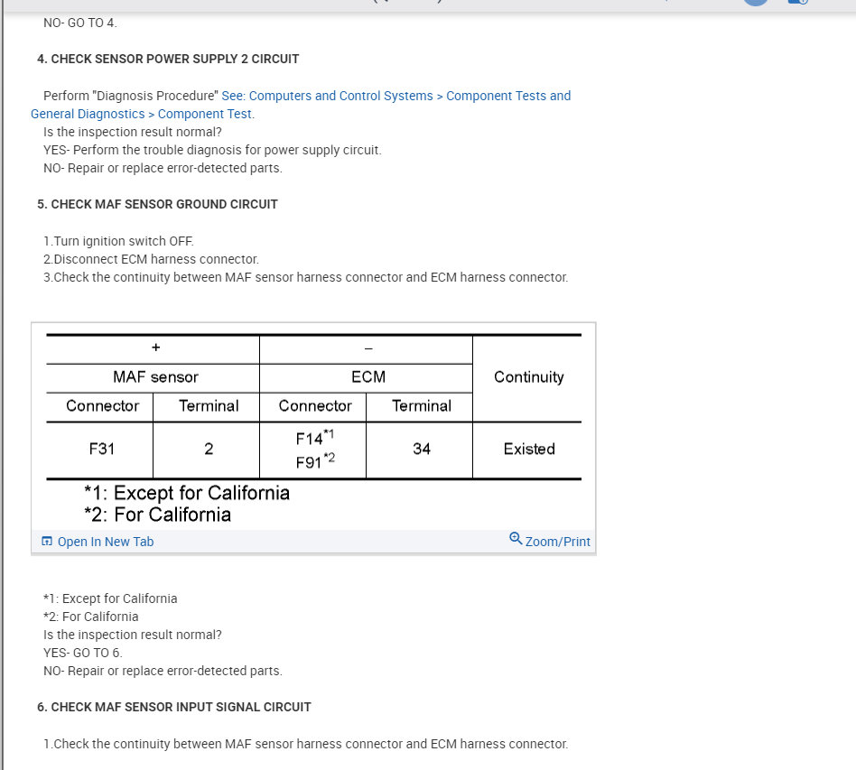

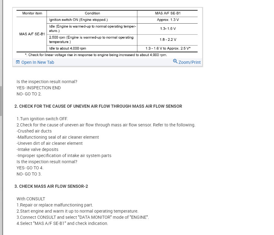

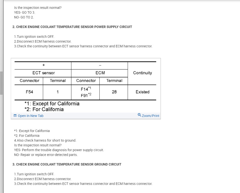

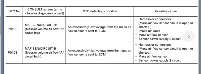

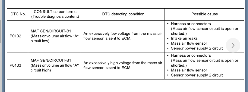

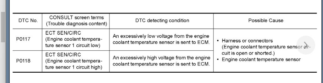

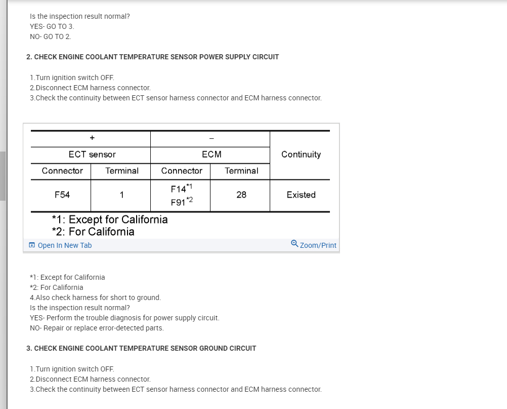

Thank you very much. Check engine light is on and after scanning it, it brought out the following codes:
P0102
P0118
P1111
P0123
P0705
I have changed the fuel pump and also looked at the fuel filter. Thanks
Jun 13, 2022 at 4:20 AM

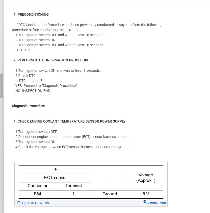

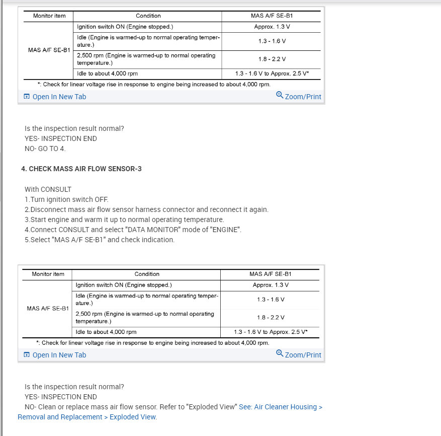

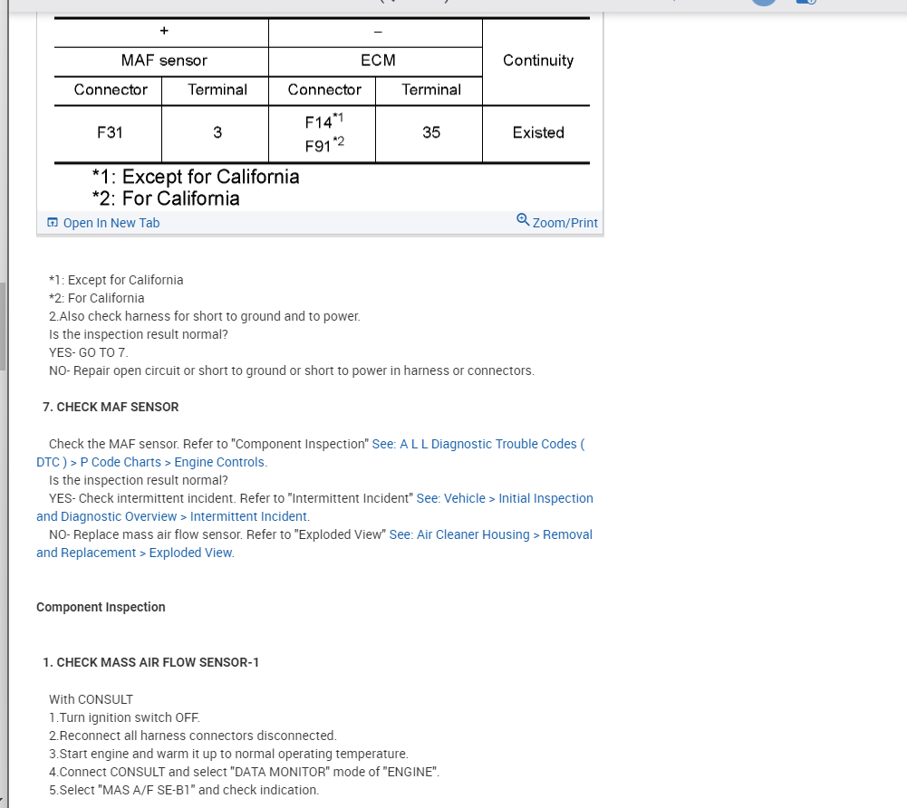

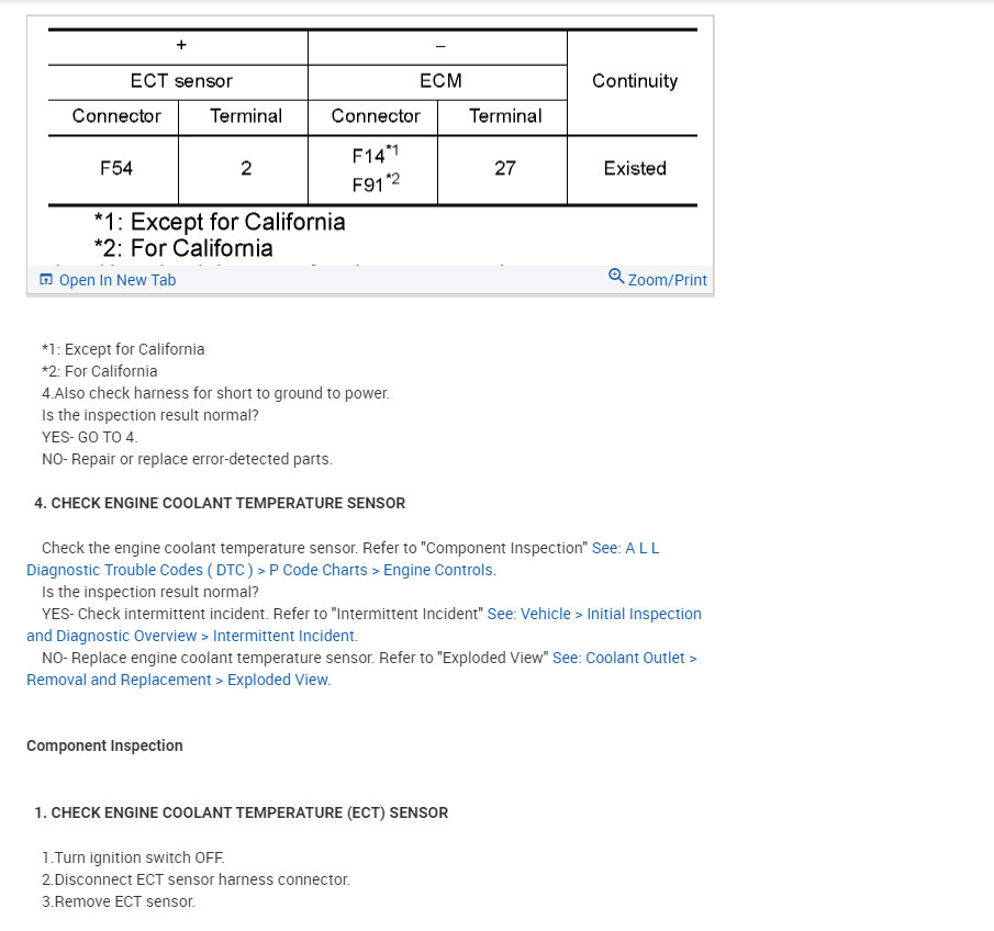

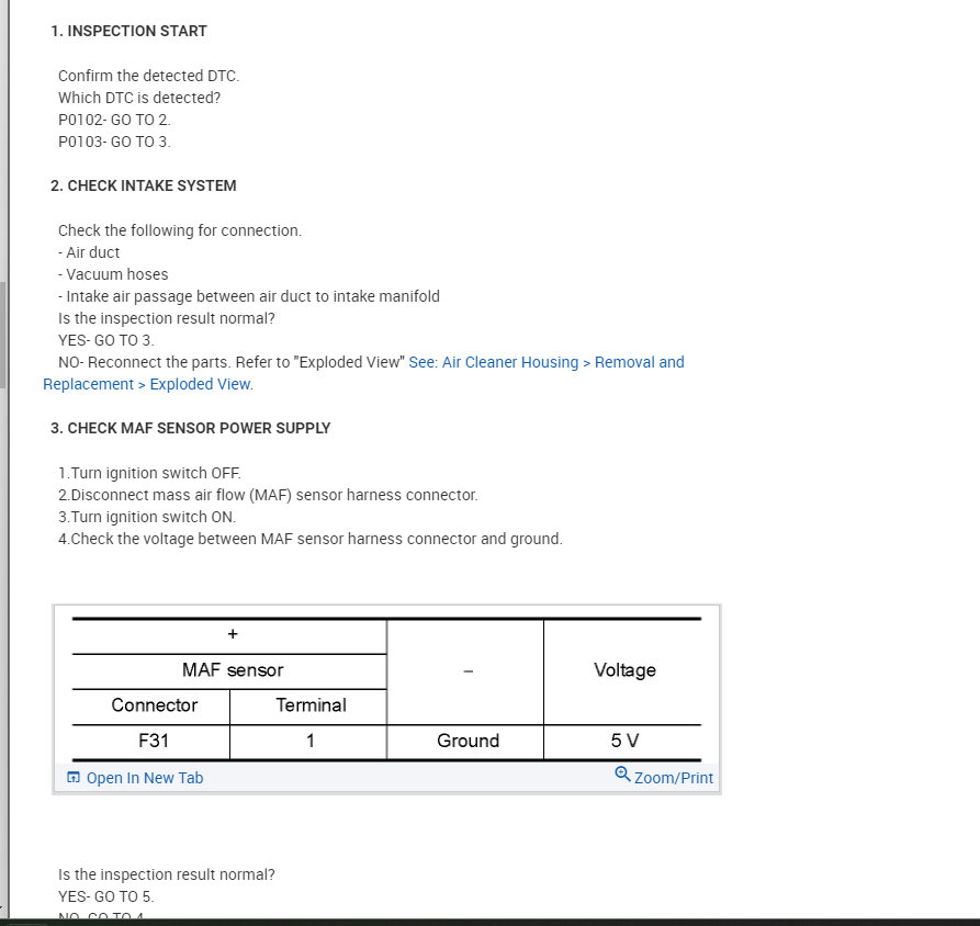

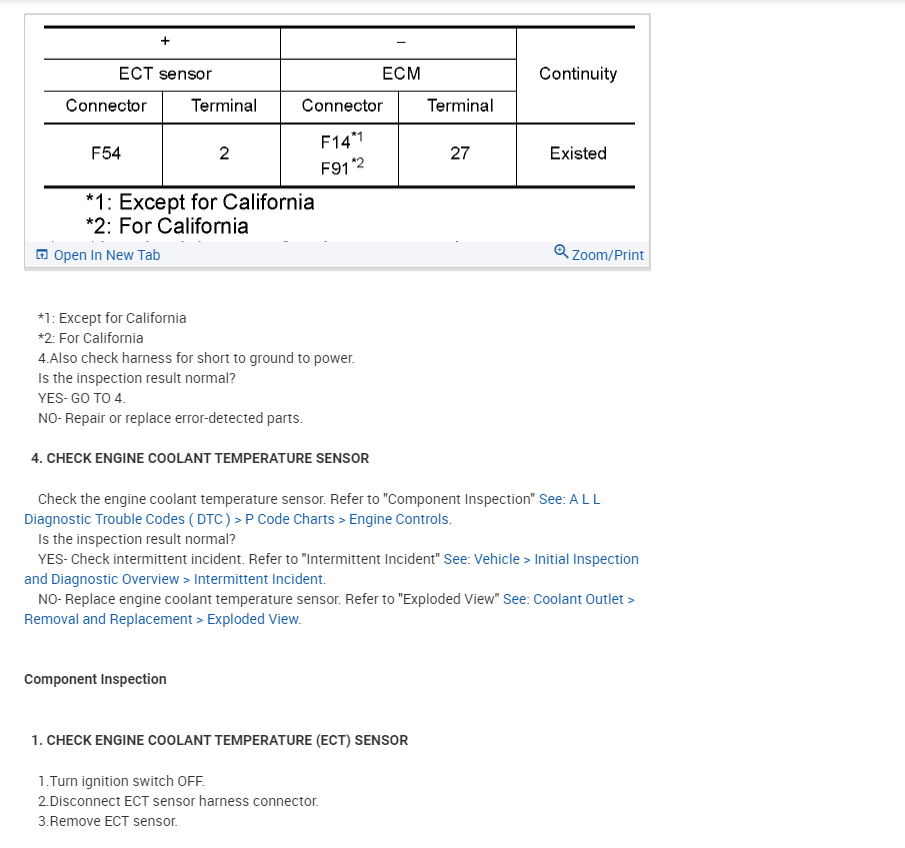

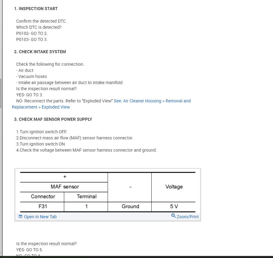

Now we are getting somewhere! Thanks for checking them.
I suspect you have a wiring issue or a control module issue.
Each of these codes are related to the 5-volt reference system.
So, we are going to have to run through this testing in order to find out what the possible issues are.
Here is a guide that will help with this:
Please run through this info and we can go from there.
