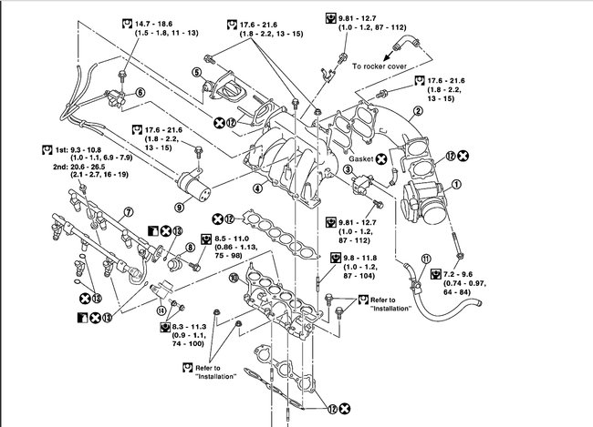

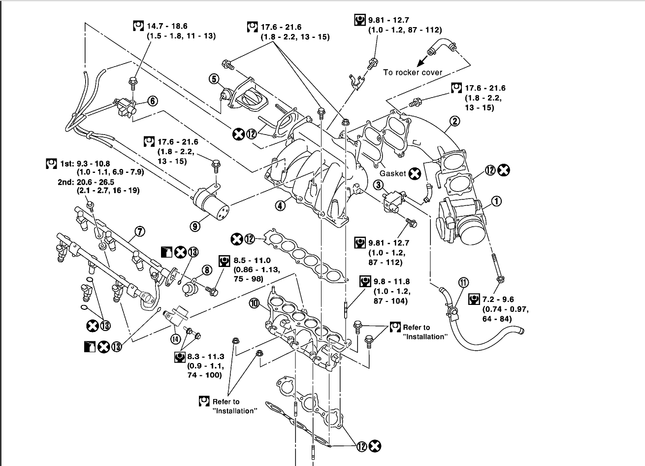

i have a 2004 Nissan almera 1.5 not accelerating. when diagnosed it gives me the codes p1122 and 1126. i have tested the throttle unit and the peddle on another similar car and both work fine. this problem started after i replaced the antenna ring on the ignition because it was faulty.
May 23, 2019 at 5:28 PM (Merged)
  • 54,837 POSTS
It sounds like you have a throttle actuator that has gone out and needs to be replaced. Here is a guide to help you see what you are in for when doing the job.
https://www.2carpros.com/articles/how-a-throttle-body-works
Here is what it will be like on your car (Below) Then clear the codes and you should be all set.
