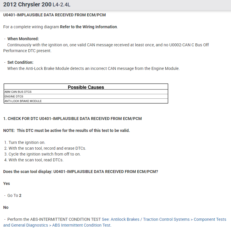

I am having an issue to getting the car started. I have changed the head gasket and put in new camshaft sensors. Cleared the codes but the check engine light won't come off and I see that I have a permanent code U0401 but don't know if that's the issue why my car won't start. I'm trying too see if it's my ECM. Any help?
Sep 18, 2021 at 12:55 PM
SQM
  • 6,383 POSTS

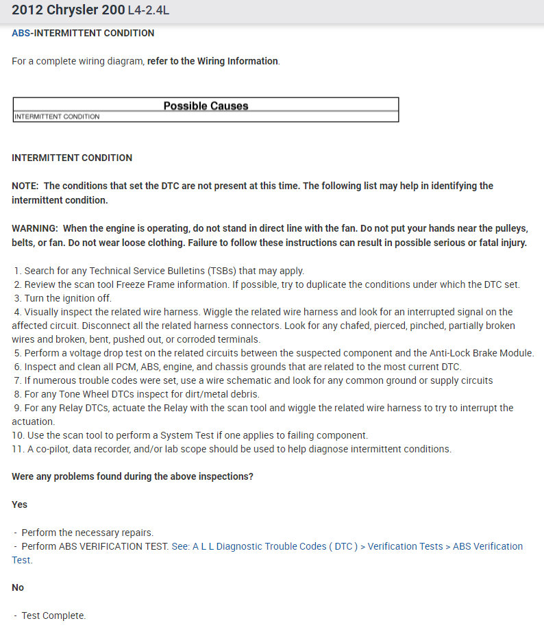

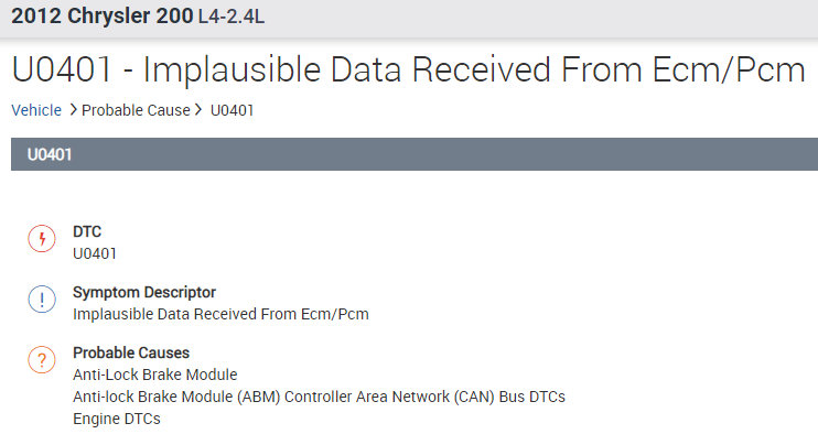

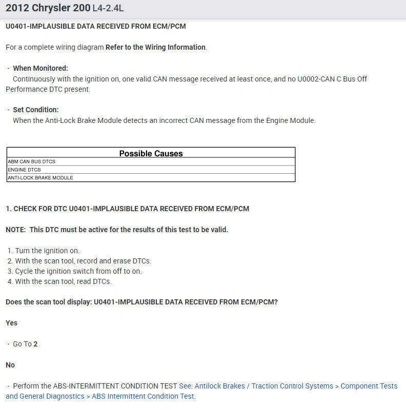

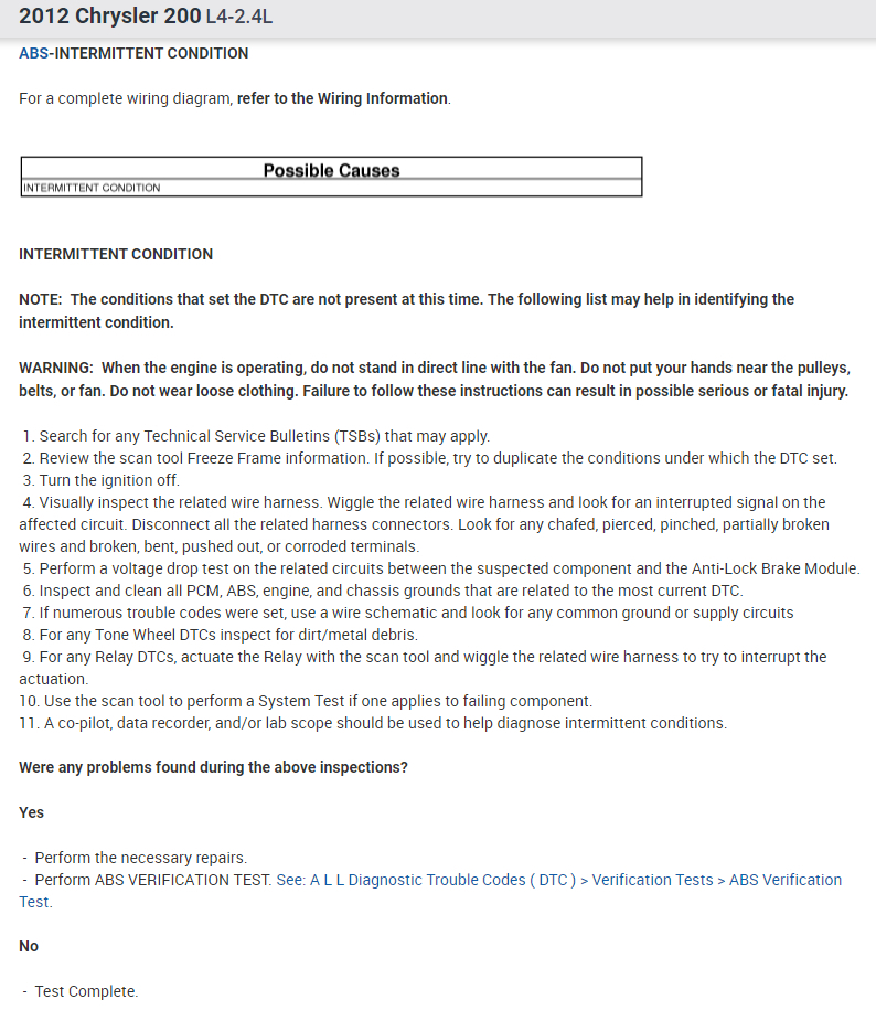

The code:
U0401-Implausible data received from ECM/PCM
This could be triggered due to the Anti-Lock Brake Module, the brake module controller area network (CAN) bus.
I have included the basic diagnostics for that code (look below).
As for no start what does it do? Does it crank? Are you getting fuel/spark?
Please let me know.

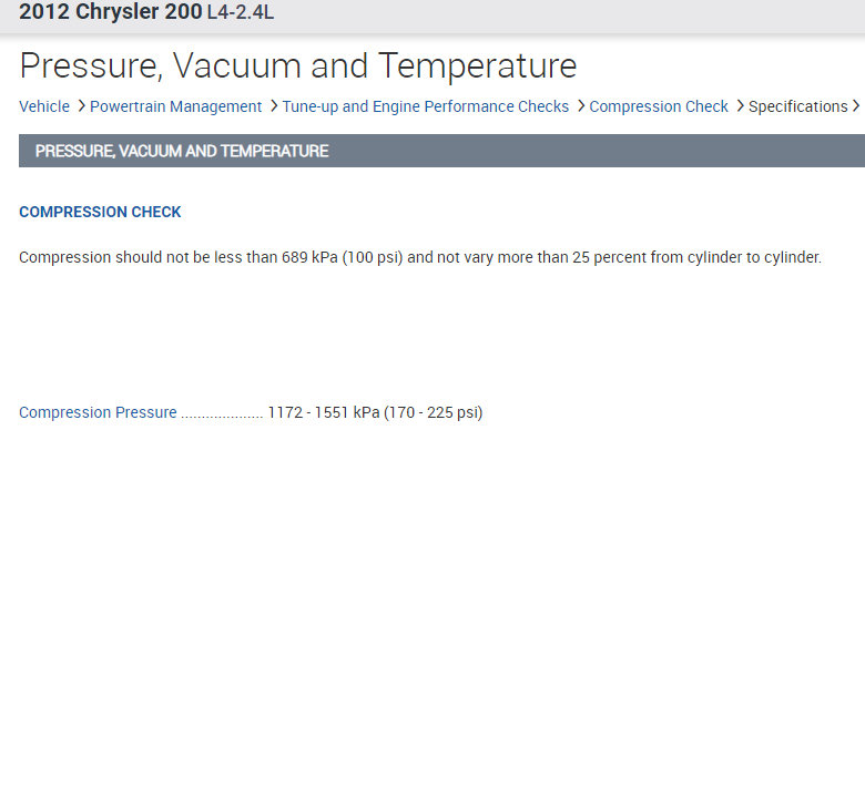

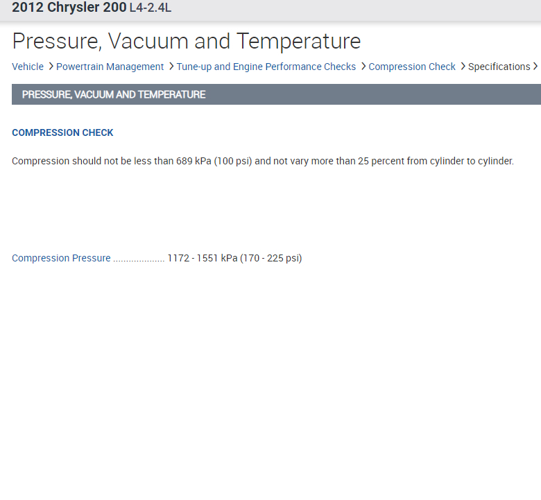

Fuel pump gave almost 51 to 55 PSI, but took the fuel rail out and did a quick test and saw piston 2 fuel rail Is clogged. Does this car have any switches to deactivate or bypass to start the car by any chance? Also, I did a compression test, I got 90 PSI on my first 60 on my second, 60 on my third, and 50 on my last piston.
Sep 25, 2021 at 1:12 PM
SQM
  • 6,383 POSTS
Well, the fuel pressure is good. But there is no way to 'deactivate or bypass' to start the engine.
The compression low. It should be in 170 PSI range.
Low compression is another piece of the puzzle in a non-start situation.
