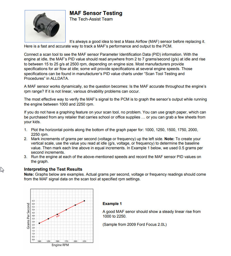

So those MAF readings are not out of line based on the number but the key is to know if it is reading correctly based on the RPM. So let's just prove that out because I am concerned of how it is changing.
Take a look at this attachment. Basically if you don't have a graph feature on the tool then you can do it as they show. Just idle the truck and note the RPM and MAF reading g/s. Then raise it slowly to around 2,500 RPM's and note the MAF reading at about 4-5 intervals.

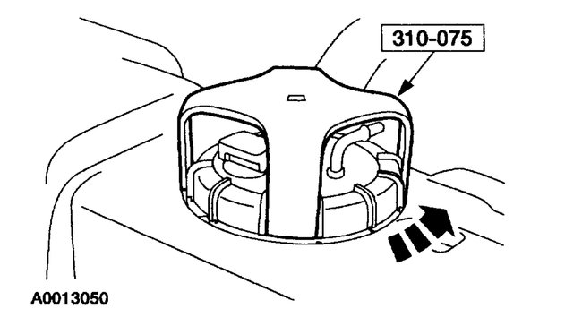

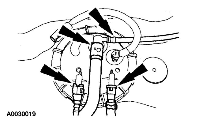

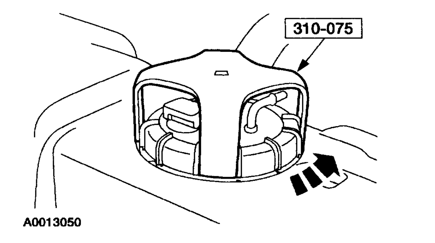

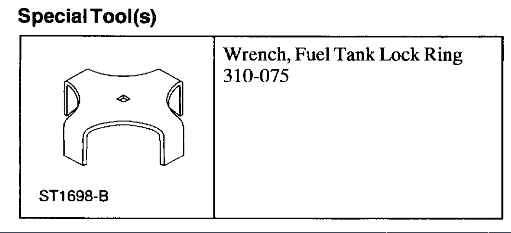

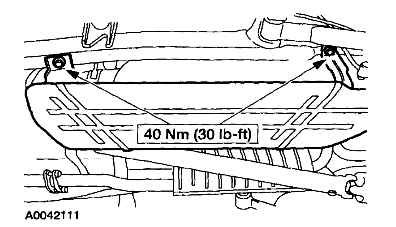

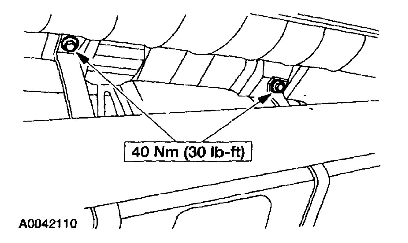

Fuel pressure is way too low.
Fuel Presure
Key on, engine off .................... 414-448 kPa (60-65 psi)
Engine running .................... 414-448 kPa (60-65 psi)
You need to replace the fuel pump to get the pressure correct.
https://www.2carpros.com/articles/how-to-replace-an-electric-fuel-pump
Wrench, Fuel Tank Lock Ring
SPECIAL TOOL(S)
REMOVAL
1. Remove the fuel tank.
2. Clean the area around the fuel pump mounting flange.
3. Using the special tool, remove the fuel tank pump assembly locking retainer ring.
4. Remove the fuel pump assembly.
CAUTION: The fuel pump assembly must be removed and handled carefully to avoid damage to the float arm and filter.
5. Remove and discard the fuel pump mounting gasket.
Removal
Warning:
Do not smoke or carry lighted tobacco or open flame of any type when working on or near any fuel-related component. Highly flammable mixtures are always present and may be ignited, resulting in possible personal injury.
fuel in the fuel system remains under high pressure even when the engine is not running. Before repairing or disconnecting any of the fuel lines or fuel system components, the fuel system pressure must be relieved to prevent accidental spraying of fuel, causing personal injury or a fire hazard.
1. Relieve the system pressure.
2. Disconnect the fill pipe main hose.
Loosen the fill pipe main hose clamp.
Disconnect the fill pipe main hose from the main fill tube.
3. Drain the fuel tank.
4. Remove the four bolts (two each side) and remove the skid plate, if equipped.
5. Support the fuel tank.
6. Remove the bolts and pivot the fuel tank support straps away from the fuel tank.
7. Disconnect the fuel pump connector.
Lower the fuel tank slightly.
8. Disconnect the fuel supply and return line push-connect fittings, the vapor tube and fill tube vent hose fittings at the fuel pump.
9. Disconnect the vapor line fitting at the rear of the fuel tank.
10. Lower the fuel tank.
INSTALLATION
1. To install, reverse the removal procedure.

MAF data from scan tool showed MAF kind of erratic. I am going through frame by frame and at one point the rpm was at 2219 and the MAF gm/s was at 16.99 and a few frames before it read 14.23 at the same rpm.
While at 2192 rpm the gm/s was at 15.06 and a few frames later it read 13.89. I think I can upload the data but I will have to check.

Also tested my MAF according to this website: https://easyautodiagnostics.com/ford/4.9L-5.0L-5.8L/maf-sensor-tests-2
And everything passed when tested at start up.

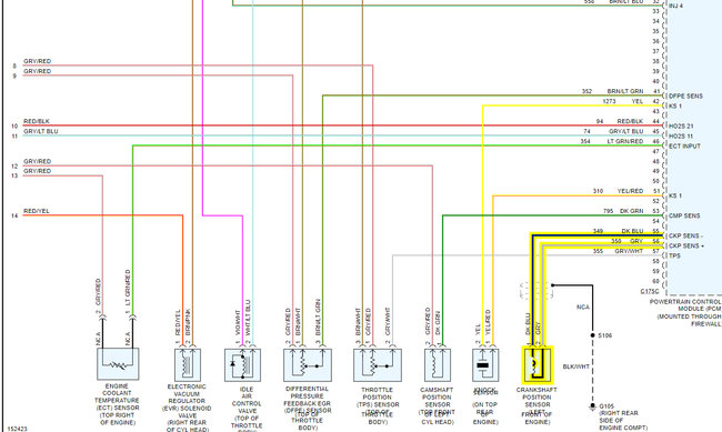

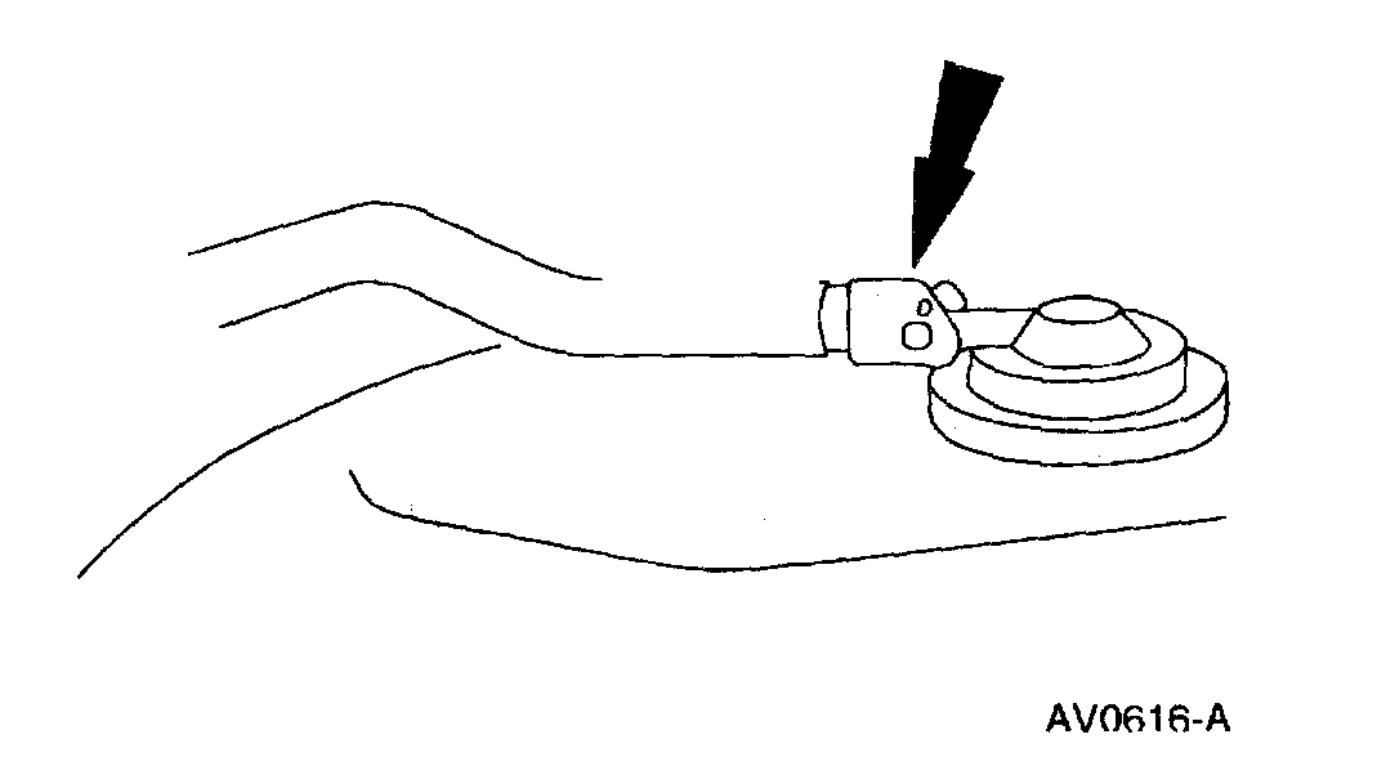

Alright I looked through all of the monitors on the scan tool and couldn’t find anything labeled CPS. Does it have another name that it goes by that you know of?
Nov 13, 2020 at 10:20 AM
Engine speed sensor.
You should have it somewhere that will read engine speed.
The Crankshaft Position (CKP) sensor is a magnetic transducer mounted on the engine block adjacent to a pulse wheel located on the crankshaft. By monitoring the crankshaft mounted pulse wheel, the CKP is the primary sensor for ignition information to the powertrain control module (PCM). The trigger wheel has a total of 35 teeth spaced 10 degrees apart with one empty space for a missing tooth. The 6.8L ten cylinder pulse wheel has 39 teeth spaced 9 degrees apart and one 9 degree empty space for a missing tooth. By monitoring the trigger wheel, the CKP indicates crankshaft position and speed information to the PCM. By monitoring the missing tooth, the CKP is also able to identify piston travel in order to synchronize the ignition system and provide a way of tracking the angular position of the crankshaft relative to fixed reference (Figure 25).
The crankshaft position (CKP) sensor (Figure 54) is a magnetic transducer mounted on the engine block adjacent to a pulse wheel located on the crankshaft. By monitoring the crankshaft mounted pulse wheel, the CKP is the primary sensor for ignition information to the PCM. The pulse wheel has a total of 35 teeth spaced 10 degrees apart with one empty space for a missing tooth. The 6.8L ten cylinder pulse wheel has 39 teeth spaced 9 degrees apart and one 9 degree empty space for a missing tooth. By monitoring the pulse wheel, the CKP sensor signal indicates crankshaft position and speed information to the PCM. By monitoring the missing tooth, the CKP sensor is also able to identify piston travel in order to synchronize the ignition system and provide a way of tracking the angular position of the crankshaft relative to a fixed reference (Figure 54) for the CKP sensor configuration. The PCM also uses the CKP signal to determine if a misfire has occurred by measuring rapid decelerations between teeth.
Nov 13, 2020 at 10:29 AM
RANGERSHANE
  • 46 POSTS
I have vehicle speed sensor (mph) monitor but nothing labeled engine speed sensor or CKP. Would you recommend troubleshooting the sensor/wiring to the sensor?
Nov 13, 2020 at 10:55 AM

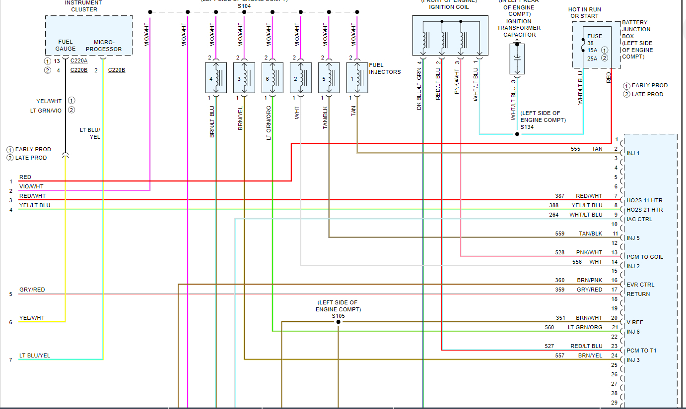

I attached the wiring for you to view.
Check for the reference voltage to the sensor.
Nov 13, 2020 at 11:04 AM
RANGERSHANE
  • 46 POSTS
I have not checked my sensor to computer yet but I got reference same reference voltage on both connectors and the same ohm value on each connector as well. This means that there is a short if I’m not mistaken... Checked the camshaft position sensor as well and got 1 Ohm in one pin with 98ohms on the other.
Nov 13, 2020 at 11:48 AM
You should have resistance between the 2 wires. The resistance comes from the ECM.
It is voltage that counts. When toy test for voltage use the connector. Red lead in one terminal and black on the other and tell me the voltage.
Nov 13, 2020 at 7:56 PM
RANGERSHANE
  • 46 POSTS
Last night when the engine was warm with ignition on I was getting 5v on both by grounding one test lead and testing the terminals. Today when I haven't cranked the truck over yet I am getting 1.5v on both terminals. When I test the terminals without grounding a test lead I get no voltage reading.
Nov 13, 2020 at 11:15 PM
Okay, did you test it the way I suggested? I need that reading.
If you do not have the reference voltage at the connector, that comes directly from the ECM.
Nov 13, 2020 at 11:17 PM
RANGERSHANE
  • 46 POSTS
Oh yes I did forgot to mention. It was 0v on both terminals.
Nov 13, 2020 at 11:20 PM
I do not think you understand.
Do not put the black lead to a body ground.
Put the red lead in one terminal and the black lead in the other terminal and give me the reading.
Nov 13, 2020 at 11:22 PM
RANGERSHANE
  • 46 POSTS
Yes, with the ignition on I checked my multimeter reading with one test lead in one terminal and the other test lead in the other terminal. The CKP was not connected. The reading was 0V DC.
Nov 13, 2020 at 11:24 PM
Okay, that indicates a short circuit with the wires. If you had ghost voltage or voltage all over the place, that would indicate an open circuit.
You should read 5 volts with that check.
Nov 13, 2020 at 11:34 PM
RANGERSHANE
  • 46 POSTS
When I pulled my engine apart that CKP wire ran between my pulley mounts and the block. May have routed it wrong when it was reinstalled and it got sandwiched. Going to pull that mount because that's probably where my issue is, but I will keep updating. Thank you very much for your unwavering help.
Nov 13, 2020 at 11:43 PM
