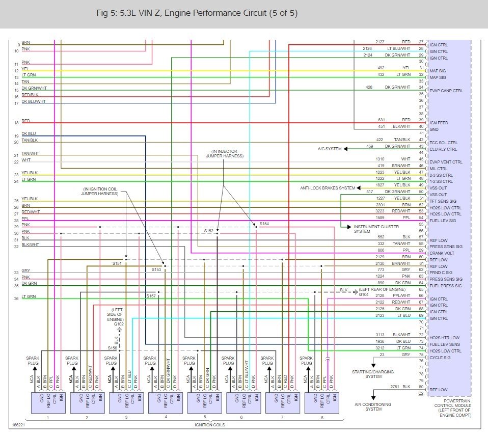

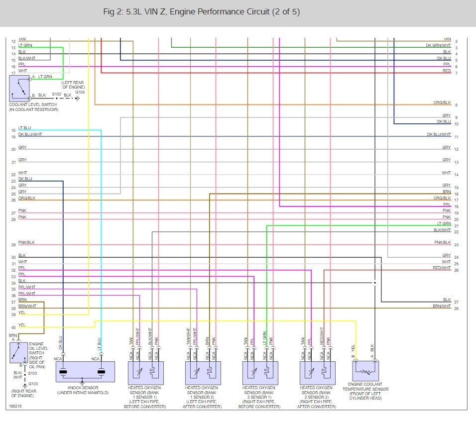

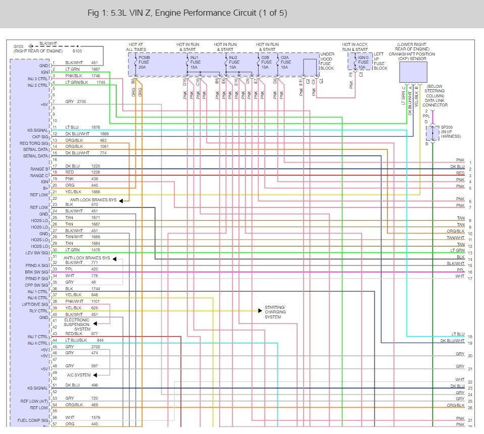

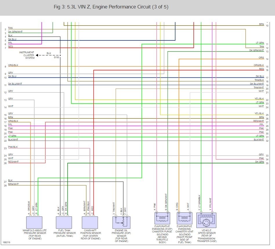

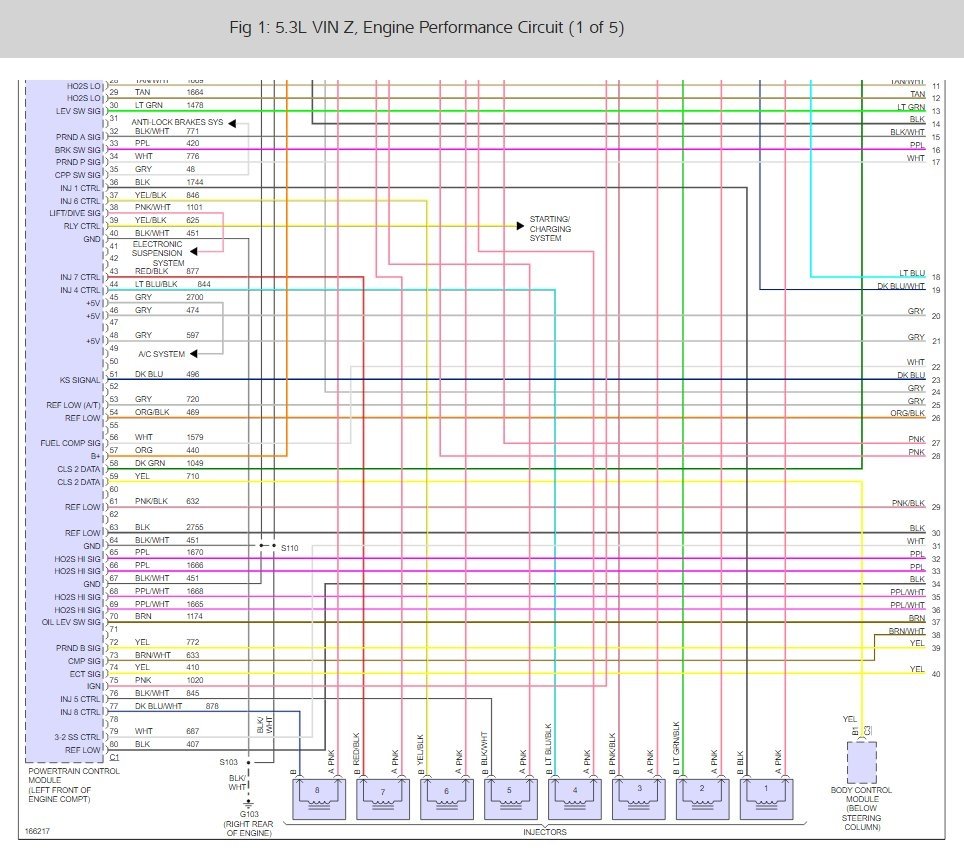

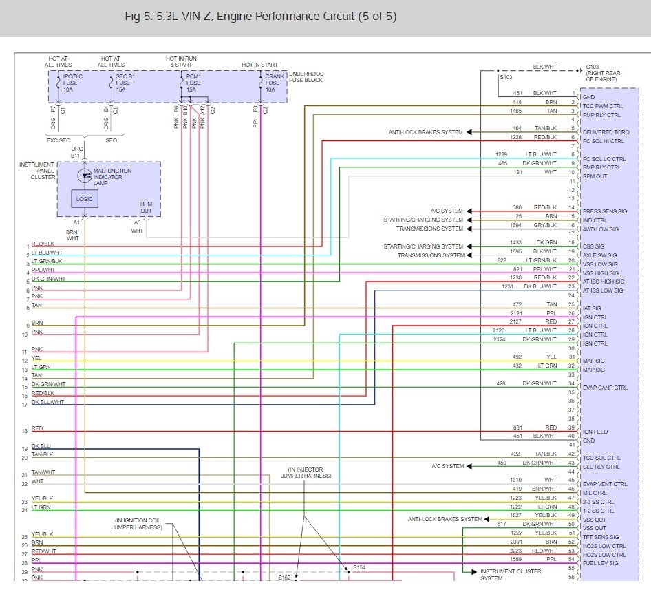

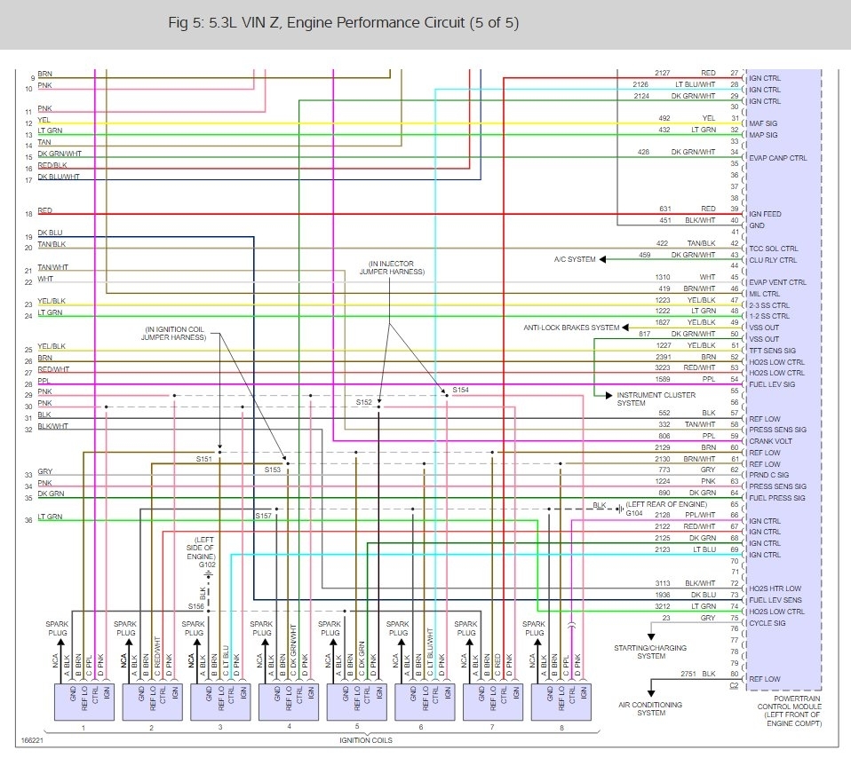

OK, it stalled after this sensor change and after a few days of it working great it sat for 24 hours and now it won't start at all. I am not getting any spark at all 8 plugs using a smart tester. Juice is getting to the coils tho. I also have 55psi fuel pressure and all inspectors are pulsating the noid testers. Any other ideas?
Thursday, July 9th, 2020 AT 1:54 PM (Merged)
KEN L
  • MASTER CERTIFIED MECHANIC
  • 47,807 POSTS

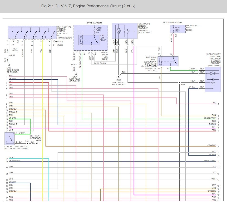

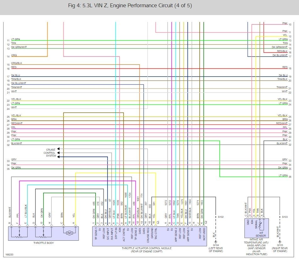

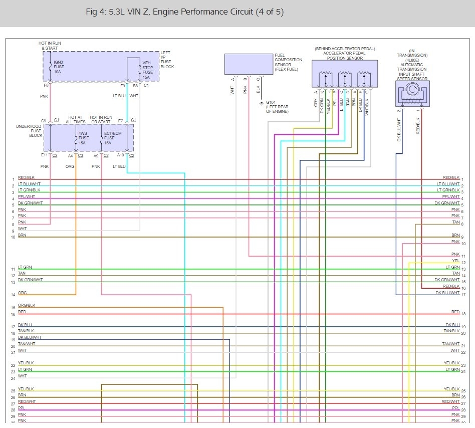

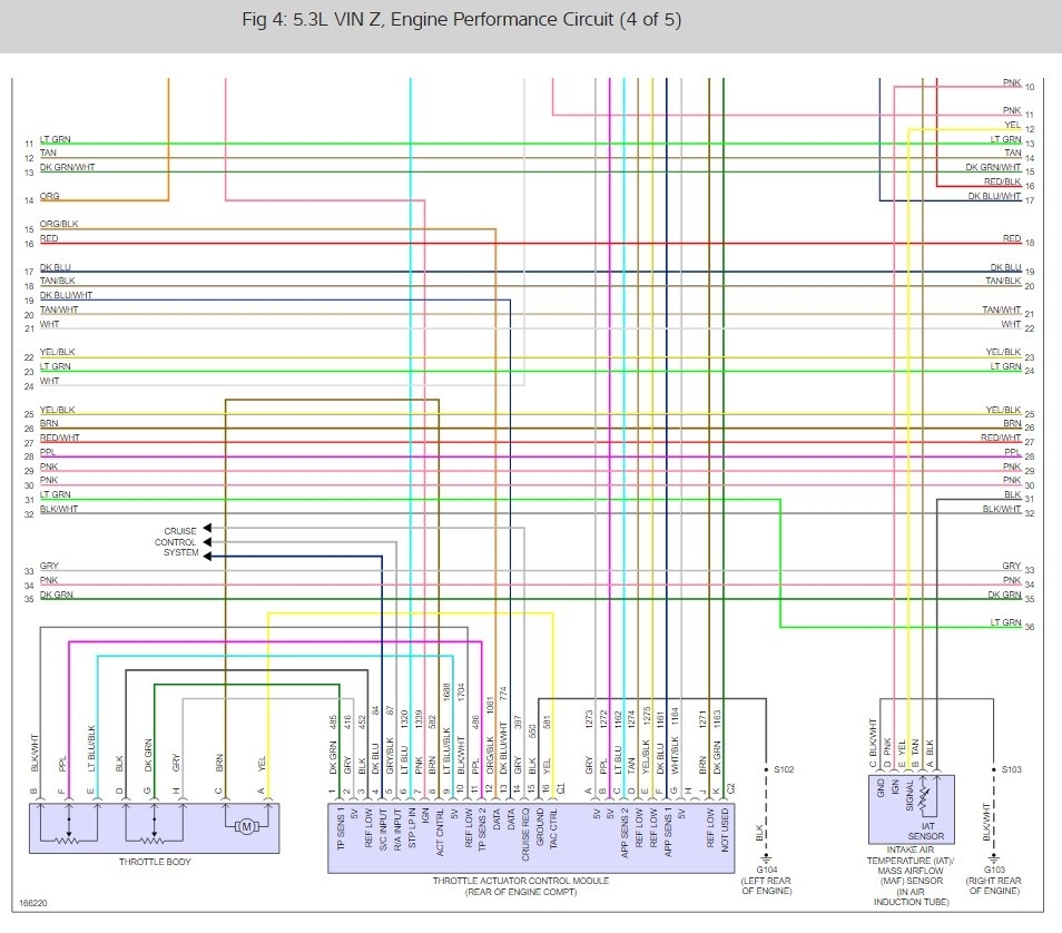

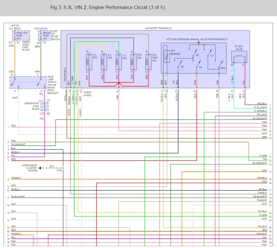

A couple things come to mind, first is an oxygen sensor that can be shorting out, please disconnect all of them and try to start it.
Here is the engine wiring diagrams (below) and some guides to help you test for power in the system
and
Please run some tests and get back to us we are interested to see what it is.
