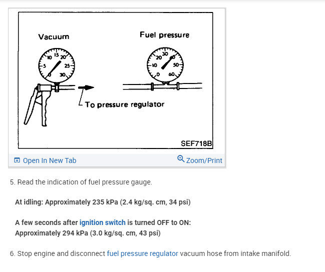

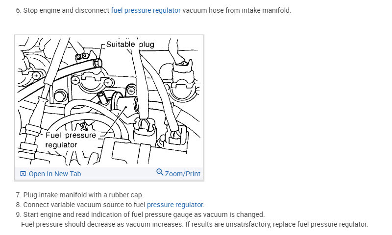

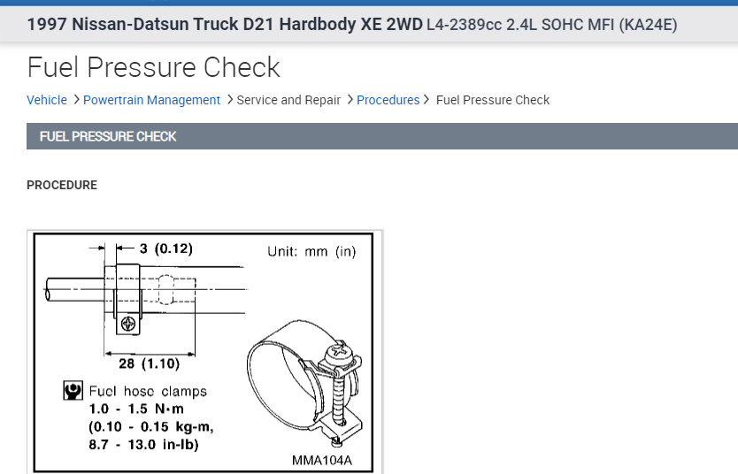

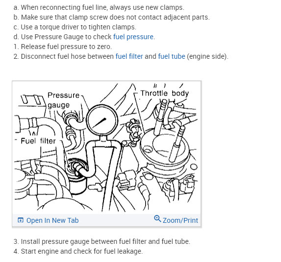

Will crank and I'll find after driven about 5 miles it will stall like starving for gas but will still idle and accelerate after a second and then we'll stall again.
Feb 4, 2023 at 7:24 PM
  • 110,194 POSTS
Based on your description, the first thing I would recommend is checking the fuel pressure. It sounds like you are running out of fuel.
If you look below, I attached the direction specific to this vehicle.
