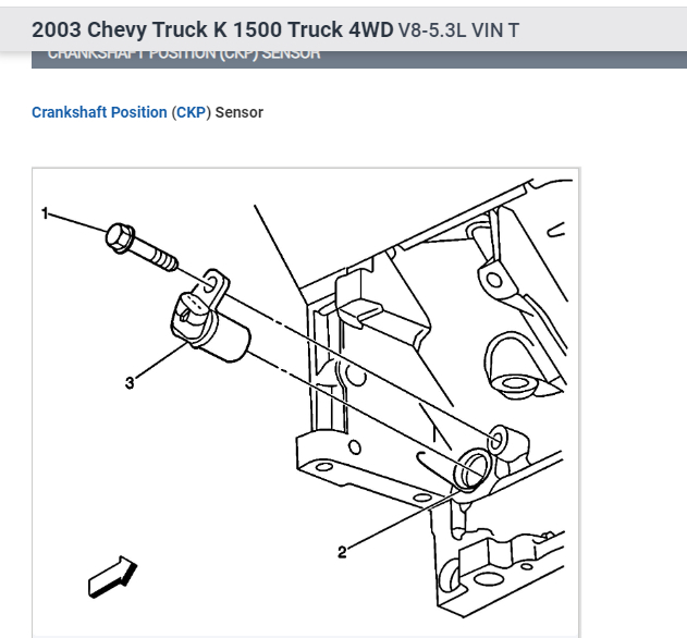

I have the truck listed above 1500. I recently replaced the water pump. After driving for a few minutes, the steering locks and the engine shuts off. I disconnected the battery and reconnected it after 40 minutes. It ran fine on my way home from work. As soon as I got home it shut off on me again. Any idea on what could cause my truck to do such a thing?

When it stalls, does it restart immediately, or do you need to wait? If you wait, my first suspect is the crankshaft position sensor. But because of its physical location, I don't see how you would have been in contact with it. See pic below. It is behind the starter motor.
Take a look through this link and let me know if it mirrors what you experience:
See pic below.

I have not run a scan for codes. It started doing it after I replaced the water pump. After the vehicle shuts off, I can start it back up.

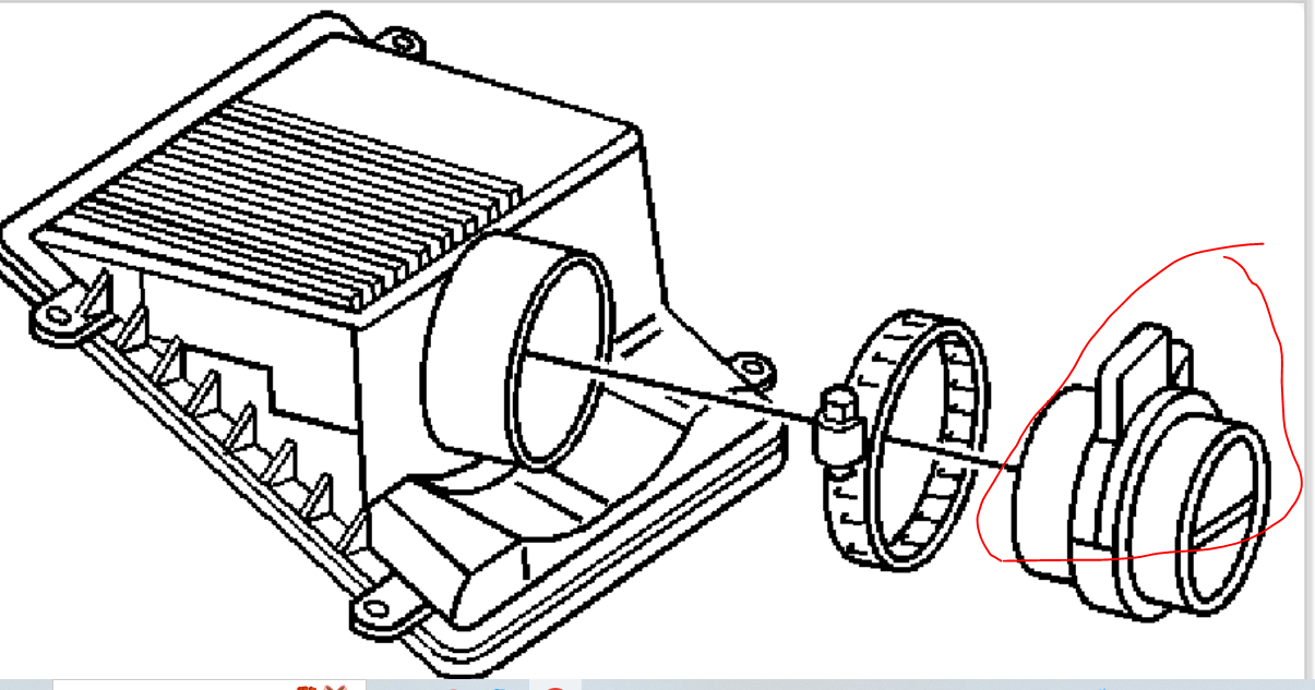

Also, make sure the MAF/IAT sensor on the air intake tube was reconnected. It is the tube that runs from the air filter box to the throttle body. See pic 1 below.
See pic below.

I work at a auto parts store. There were no codes and the MAF was never disconnected.

At the front of the engine, I can't think of anything that would cause this. The CKP is behind the starter, which was my first thought. Also, the removal of the air intake tube which includes the MAF would have made things a lot easier. LOL So, I assumed that would have been disconnected.
