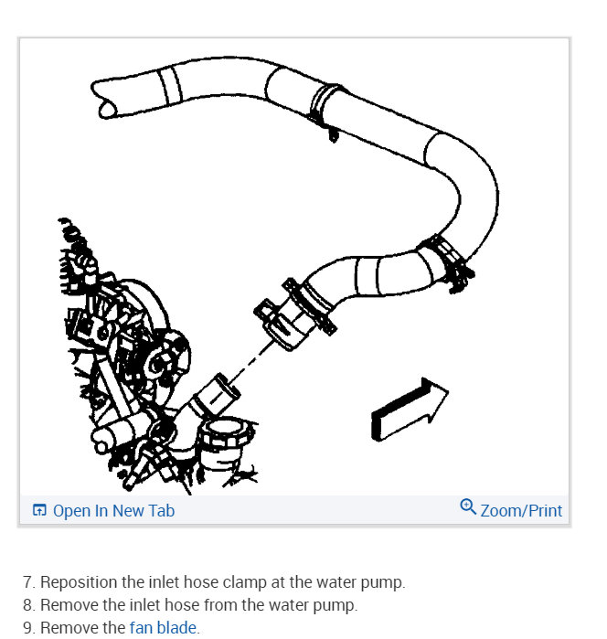

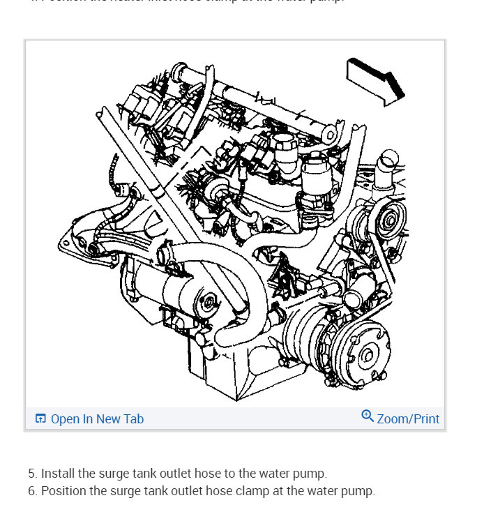

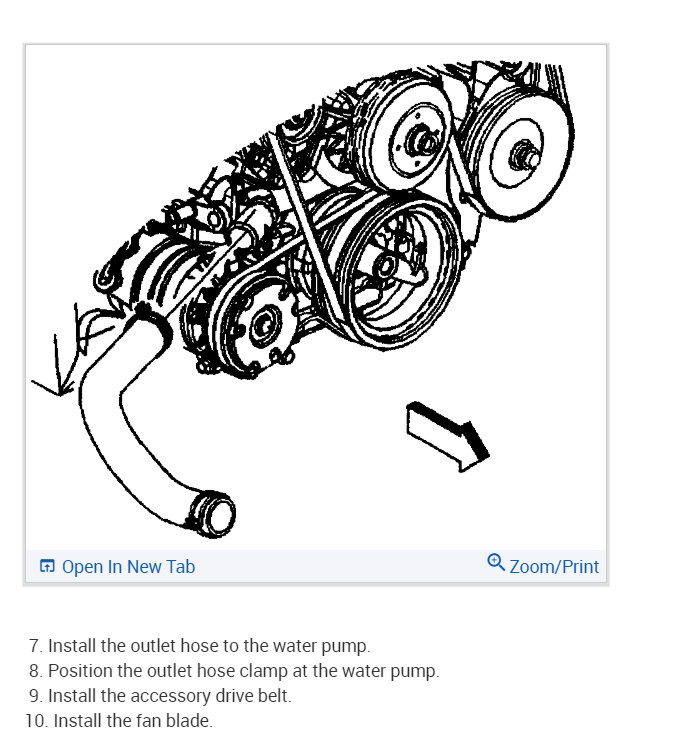

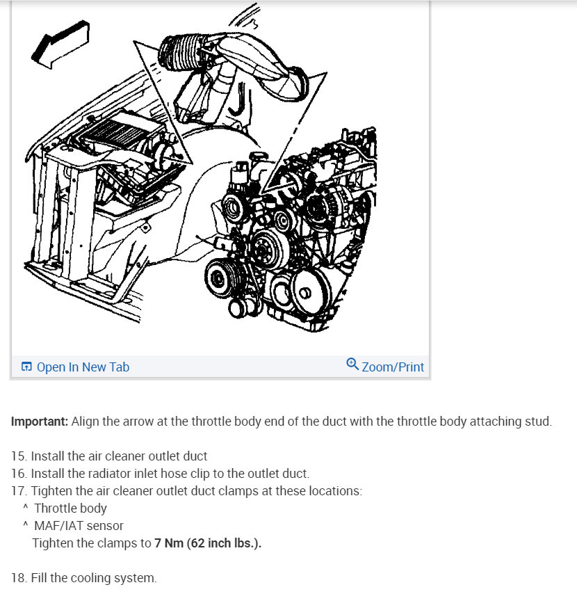

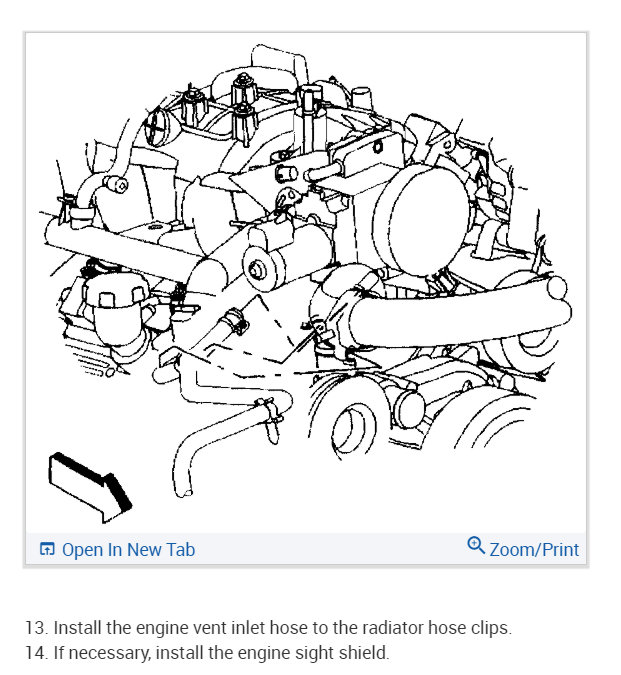

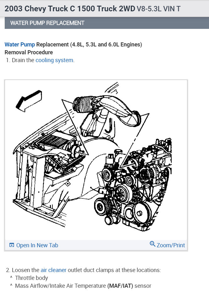

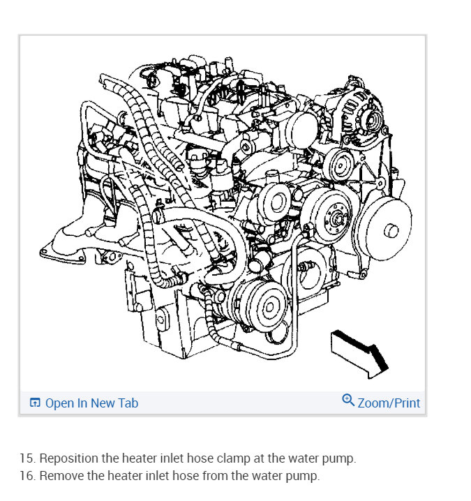

truck is losing coolant at a slow rate, tends to run hot, noticed coolant on driveway underneath vehicle this morning. I need to replace the water pump can you help me please?
Nov 29, 2009 at 3:48 AM
  • 110,244 POSTS

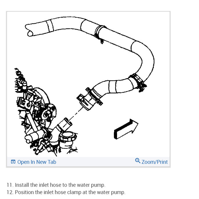

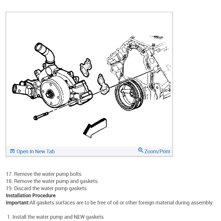

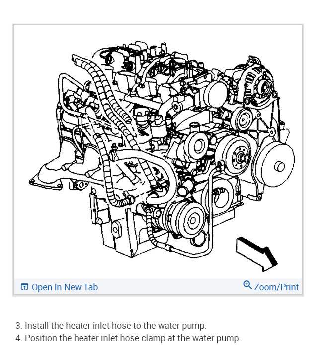

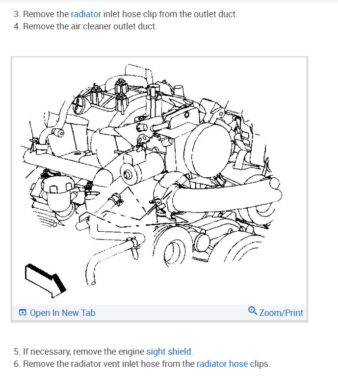

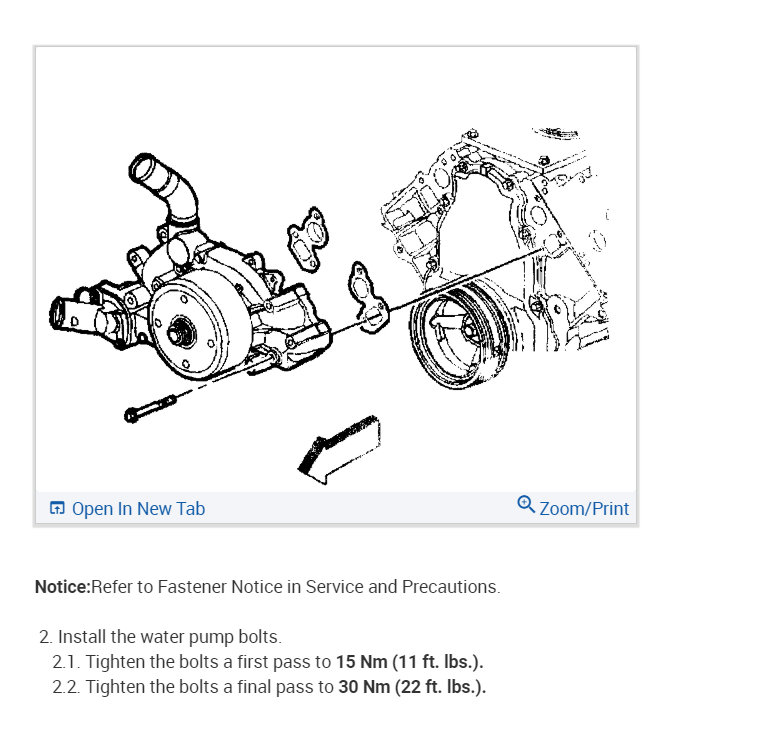

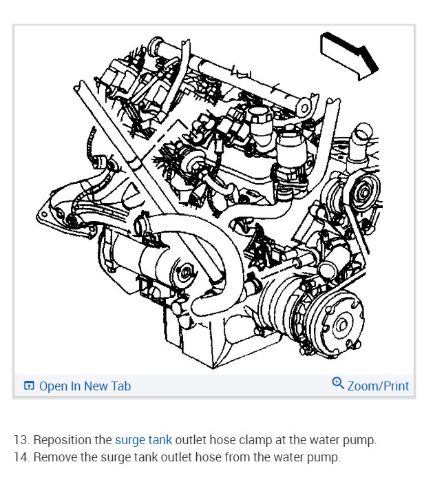

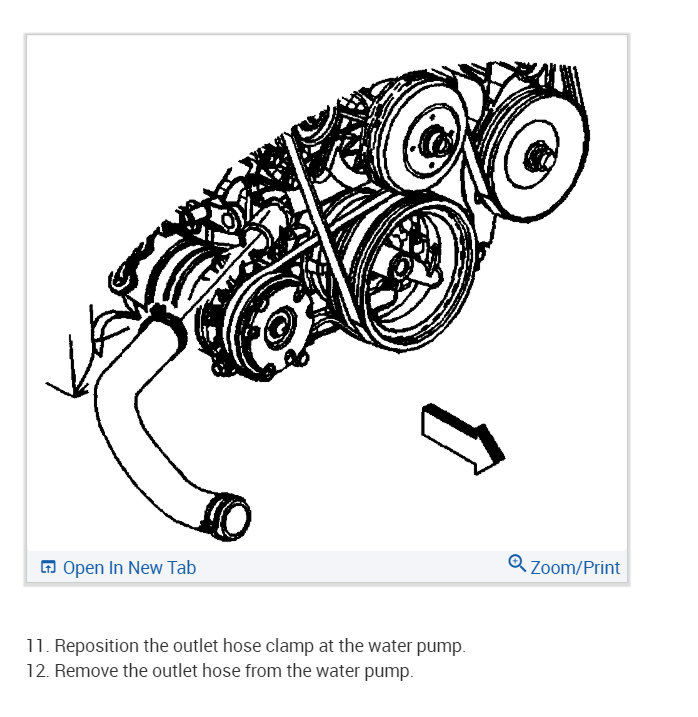

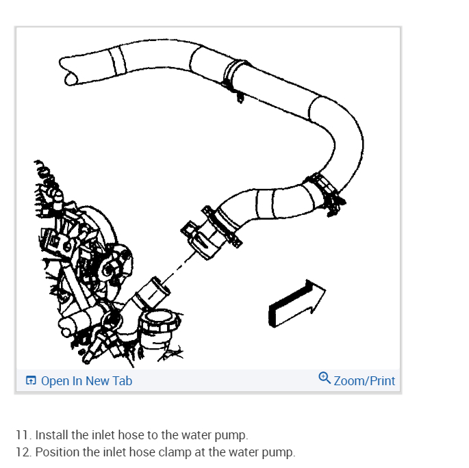

Here is a guidet hat will walk you through the repair on a similar car with diagrams below with the instructions in the diagrams to show you how to do the job on your truck. Starter by draining the coolant.
https://www.2carpros.com/articles/water-pump-replacement
the part on 83.00 from Amazon (AC DELCO)
You will need to remove the fan clutch this video will help.
https://youtu.be/N_-MLVlBHk8
