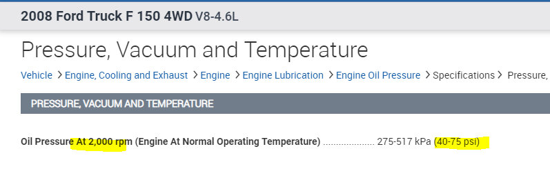

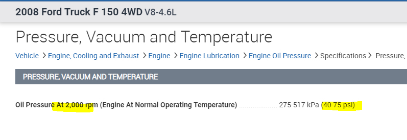

Also, even though there is no light coming on, you may want to consider borrowing a mechanical oil pressure gauge from a parts store and check the pressure using it. It will screw into the same location as the electrical one does.
I attached the pressure specs below.
