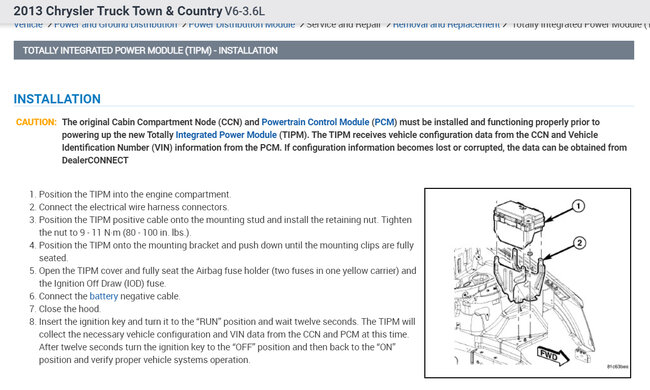

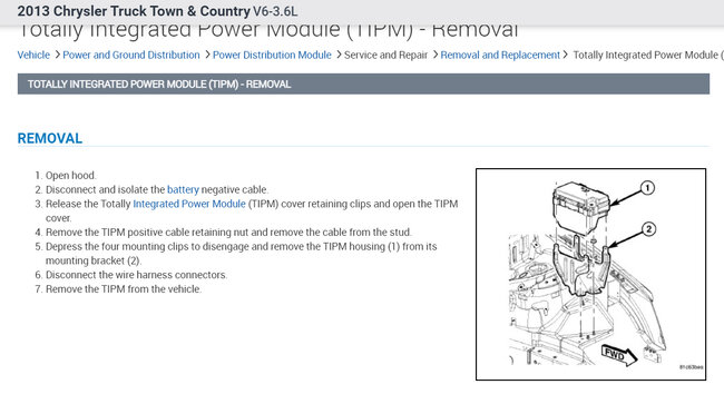

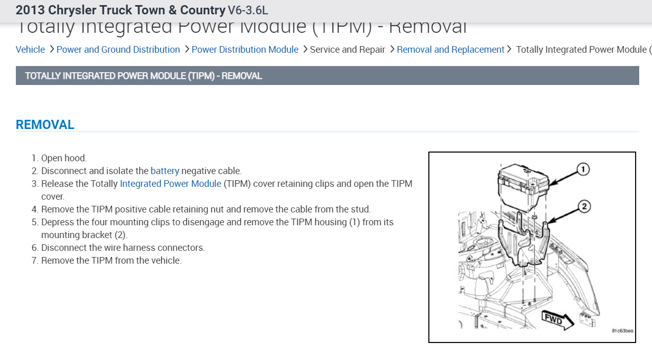

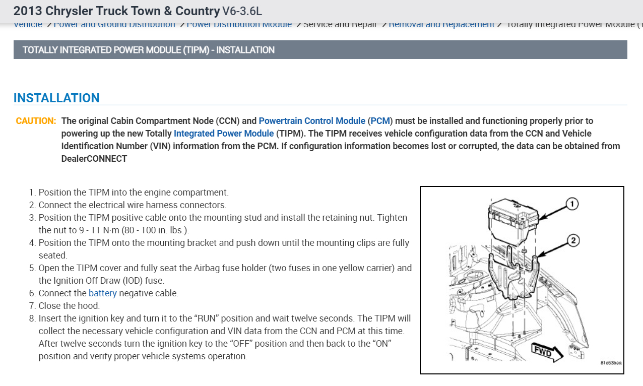

These vans had a big problem with the TIPM (totally integrated power module) which will cause this issue but to be sure we can perform a CAN scan (computer area network) which is easy and not expensive at all. you can get a CAN scanner (Controller Area Network) from Amazon from about $32.00. Below is a video to show you how. Also replacing the TIPM is easy as well because it-self learns which I have included the location and instructions on how to replace it in the images below.
https://youtu.be/u-4syLc-ifQ
and
Amazon CAN scanner link:
https://amzn.to/3sX8MCX
Here is the TIPM location. Check out the images (below). Let us know what happens and please upload pictures or videos of the problem.
