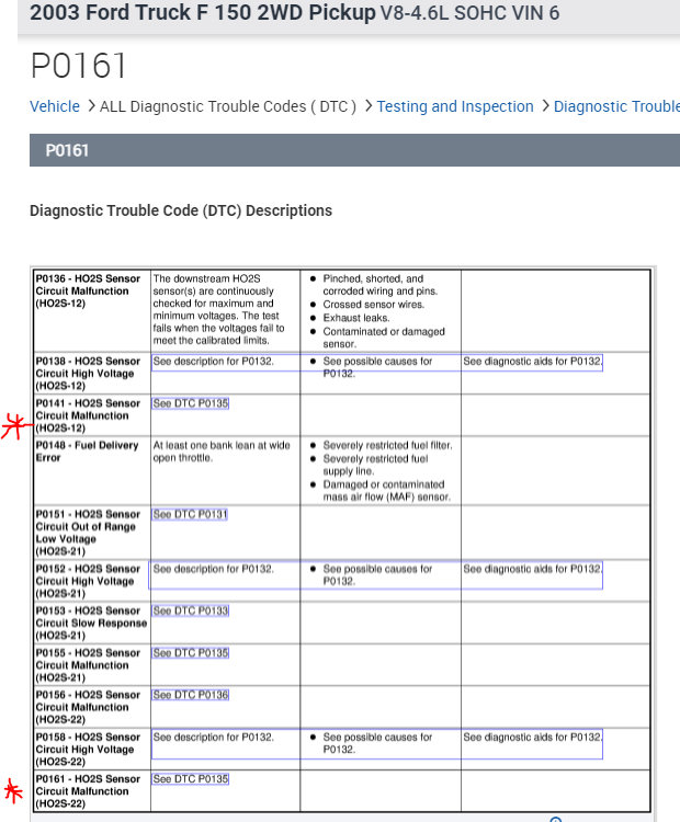

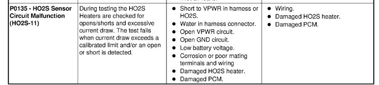

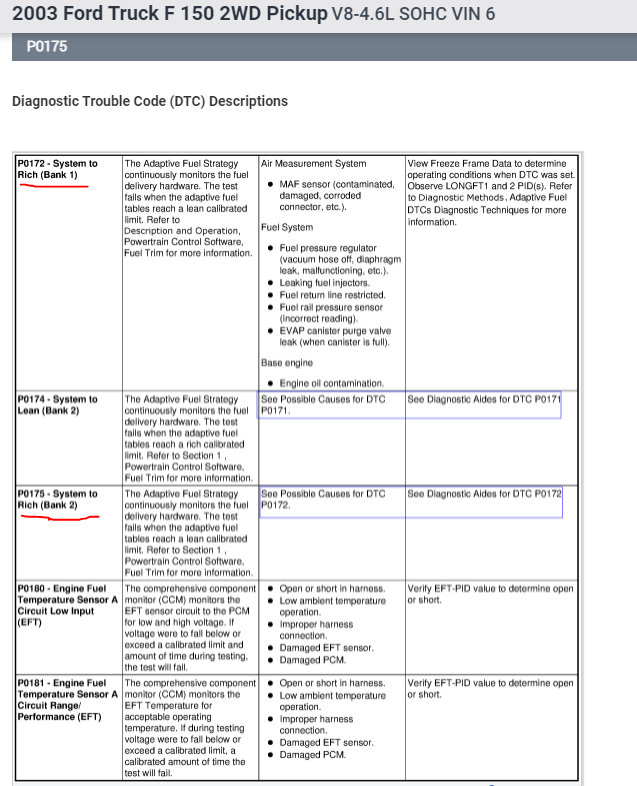

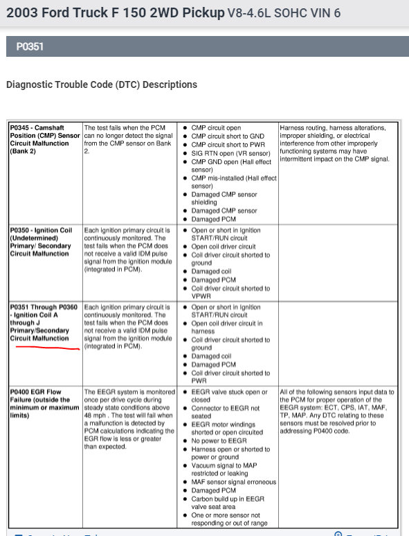

So, these are the codes:
P0141 - Oxygen sensor circuit malfunction
P0161 - Oxygen sensor circuit malfunction
P0172 - System Rich Bank 1
P0175 - System Rich Bank 2
P0351 - Ignition Coil circuit malfunction
Just about all of these are fuel / oxygen sensor related.

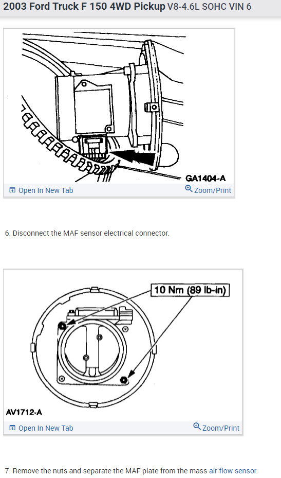

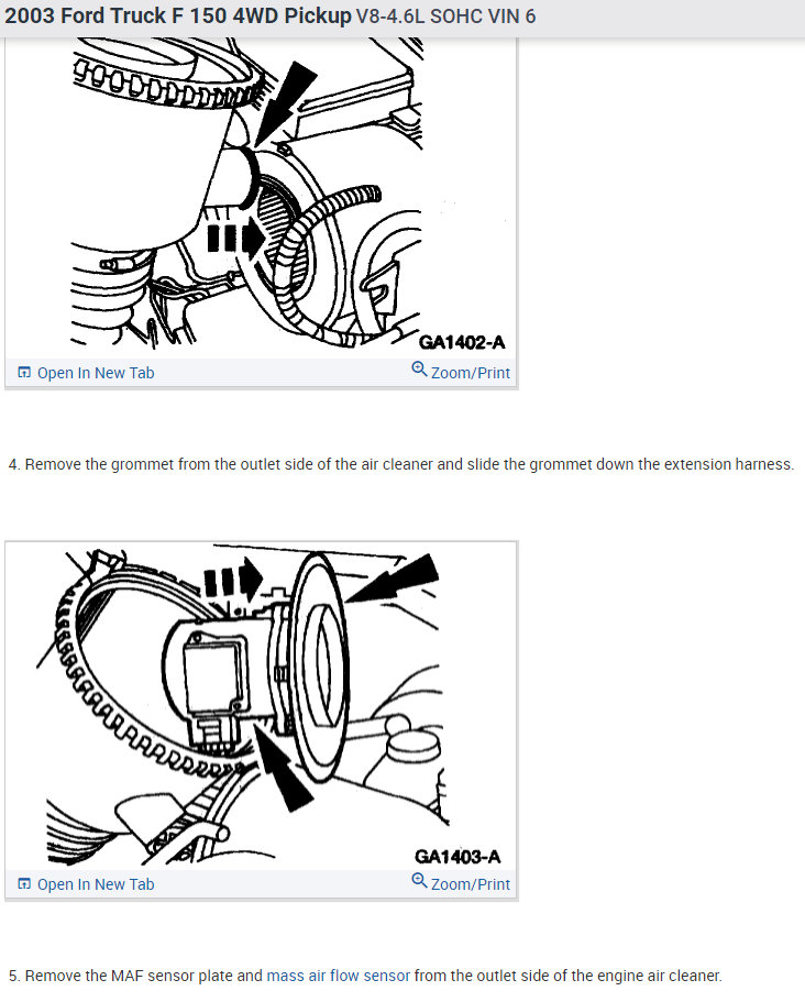

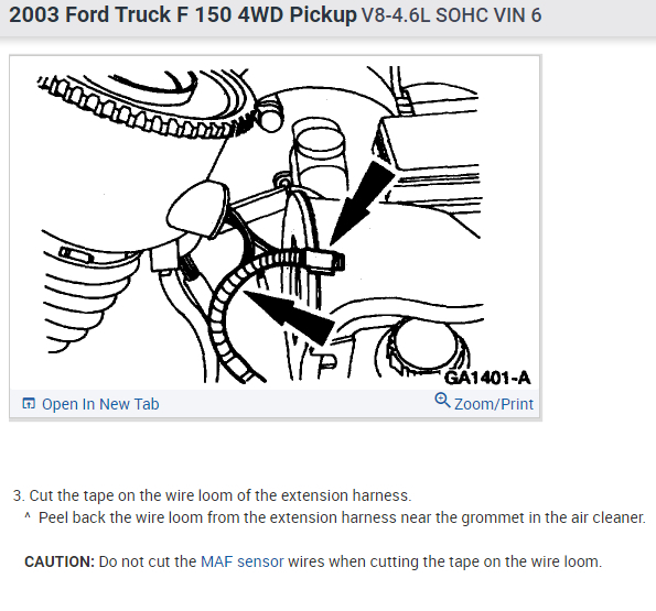

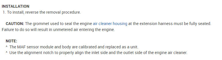

Possible causes are contaminated mass air flow sensor, faulty fuel pressure regulator, Leaking injectors, EVAP canister purge valve leak, vacuum leak, faulty oxygen sensor etc.

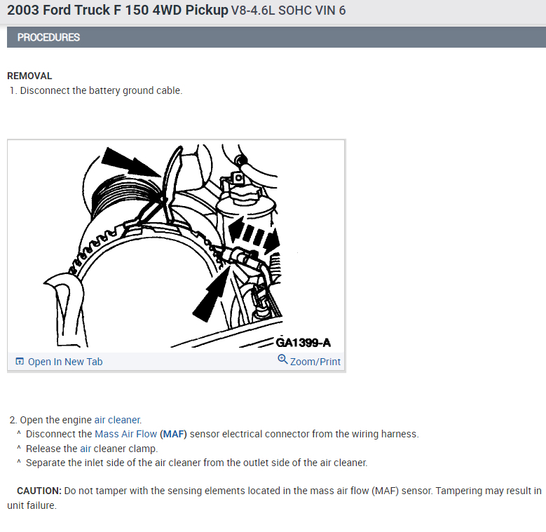

I think the best course of action would be to do a thorough inspection under hood for any fuel and vacuum leaks. Check all the vacuum lines as well as fuel lines. Inspect the fuel pressure regulator.
Do a thorough cleaning off the mass air flow sensor and the throttle body. Check the plugs for fouling. Replace if necessary.
https://www.2carpros.com/articles/mass-air-flow-service
After that you should clear the codes and run the truck and see what all code still exists.
This way you will be able to narrow down the possible issue.
I have attached more details on those codes below.
Let me know of any questions.

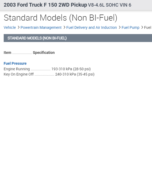

I checked everything I can think of. The only thing I haven't checked is the fuel pressure. I can check that to see if it has proper pressure and check for leaks at the same time. I will also check the fuel pump driver module. Everything I checked so far check out. I replaced the oxygen sensor. It was full of black soot so I'm sure it wasn't functioning properly.
Oct 18, 2021 at 12:02 AM
SQM
  • 6,383 POSTS

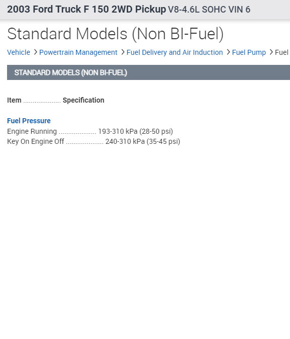

Here are the fuel pressure specifications:
Engine Running: 193-310 kPa (28-50 psi)
Key On Engine Off: 240-310 kPa (35-45 psi)
Let me know how it turns out.
Oct 18, 2021 at 4:24 AM
SWEETIE1965
  • 180 POSTS
I wasn't getting any fuel pressure at all but yet the engine would start and run. That's a new one to me. I think maybe the Schrader valve is bad or something. Well anyway, I found the fuel pump relay was not in the proper place, so I put it in its proper place. It started up easy the first time. Ever since then it's back to the same thing. Hard to start. It still idles rough but not quite as bad. I know there is gas in the oil or at least gas fumes in the engine oil. I have some brand new oil I will change it tomorrow. Now I'm leaning towards the fuel pump is weak.
Oct 18, 2021 at 8:00 AM
SQM
  • 6,383 POSTS
What was the fuel pressure?
Oct 18, 2021 at 11:52 AM
SWEETIE1965
  • 180 POSTS

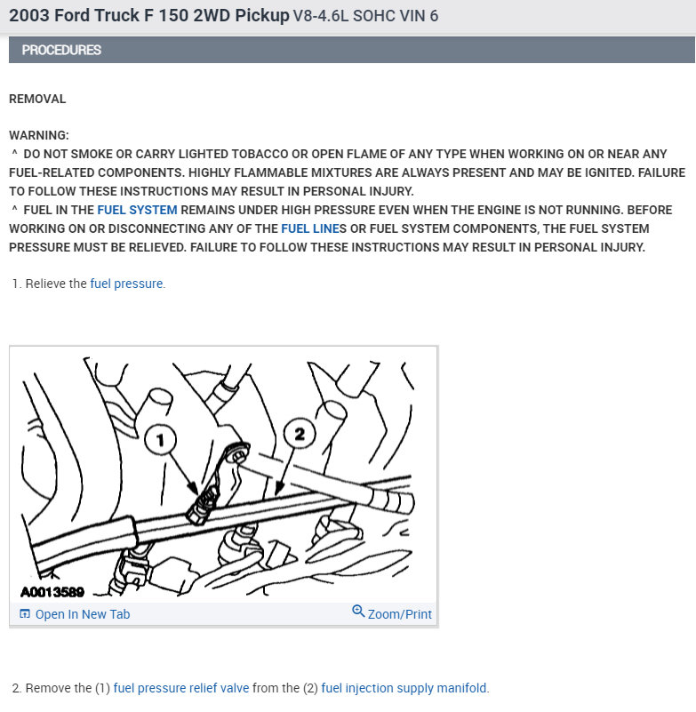

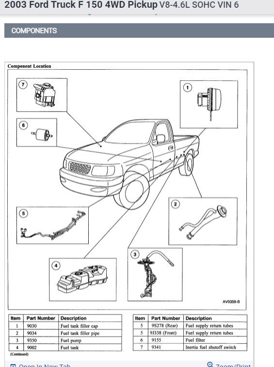

The fuel pressure gauge was not reading anything at the fuel rail. I had all the proper fittings connected and all that. It wasn't picking up anything. So, I guess the Schrader valve on the rail is either worn out or just stuck. The fuel pressure gauge was brand new. I rented it from a local parts store. So, to answer your question, I have no idea what the fuel pressure was.
Oct 18, 2021 at 12:14 PM
SQM
  • 6,383 POSTS
Got it.
Knowing the pressure sure would have helped you.

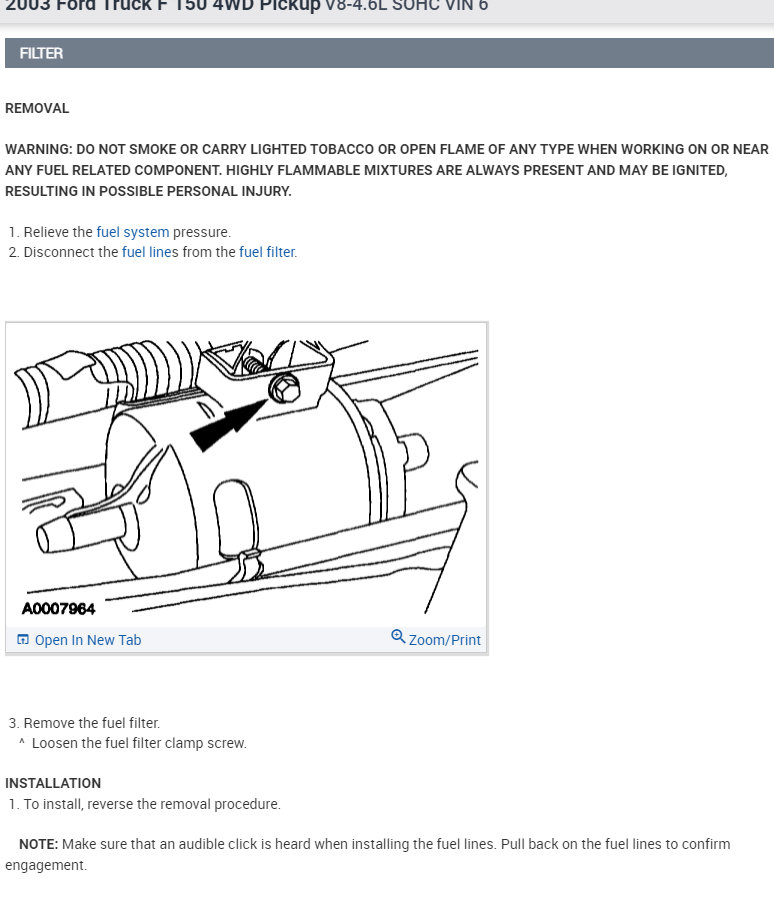

You should be able to get a new shredder valve from the parts store. This way you are not just replacing the fuel pump without being sure. Also, if you have not yet changed the fuel filter.
Also, a clogged fuel filter can reduce the fuel pressure. Has that been replaced?
Oct 18, 2021 at 12:20 PM
SWEETIE1965
  • 180 POSTS
I will check the fuel filter tomorrow. I will also get a new Schrader valve tomorrow then recheck the fuel pressure.

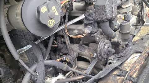

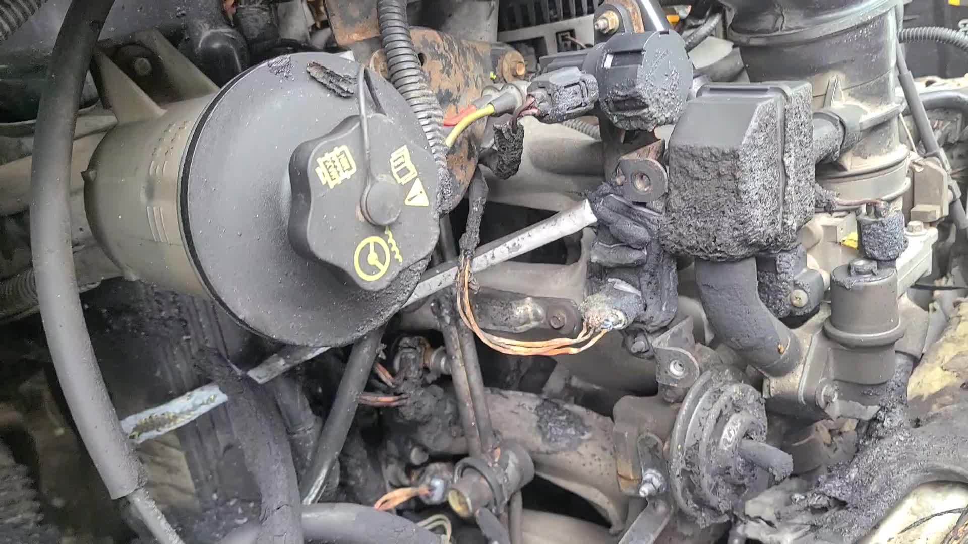

Good morning. I received the new fuel injectors. Then I had to have emergency surgery or lose my foot. Well. While I was in the hospital, my stepson said he knows someone who can change the injectors. I said okay that's great. Well, when I got home from the hospital yesterday, I popped the hood on the truck to check things out. I was very seriously shocked to say the least. Almost the entire driver side of the engine was burnt!! Now this guy isn't answering my stepson's calls or anything. My question is, what would be a good, educated guess of repairs needed now? I know these for sure: coil packs, fuel injectors, hoses, EVAP solenoid, mass air flow. When I am able, I will take a few pictures to send you so you can see the damage done. And can I force him to pay for the repairs.
Oct 28, 2021 at 10:30 PM
SQM
  • 6,383 POSTS
Wow, that is crazy with the truck. I wonder what he did.
I hope you are doing well though.
As for the burnt parts, can you upload a video of what you can see is burnt?
Oct 28, 2021 at 11:41 PM
SWEETIE1965
  • 180 POSTS
Here's a video.
Oct 29, 2021 at 12:10 AM
SQM
  • 6,383 POSTS
That is quite something with all the damages. I think it will be the best option, as you mentioned in the video, is to go to a junk yard and take off all those components from a truck. All the harnesses and lines and any other burnt components.
From the video it looks like all those plastic components got burnt.
Did he install the injectors on this side?
Oct 29, 2021 at 3:24 AM
SWEETIE1965
  • 180 POSTS
Yes. They were installed on both sides.
