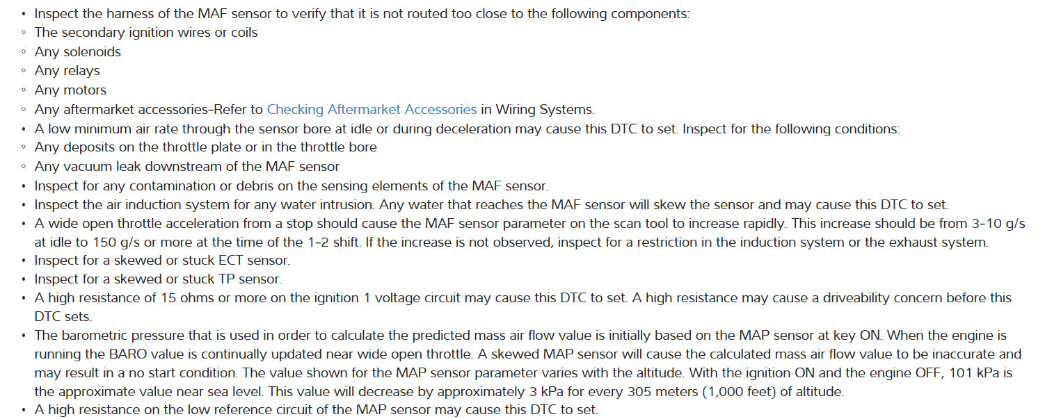

Hi I swapped my 3.8l motor for a 3.8l supercharged motor. The car will shut off while driving. The gas gauge doesn't work anymore. It will read full for about 10 sec then read empty. I replaced the sending unit/fuel pump, gas lines, Mass air flow sensor, and throttle position sensor. I get a p0101 code was talks about my MAF. Please help.
Jan 20, 2021 at 2:38 AM (Merged)
HMAC300
  • 48,601 POSTS
if you put a supercharged motor in it you need to update the computer to same . check the following items in pic but a pro should do some of them. also check to make sure duct work form maf to throttle body has no holes in it or is installed correctly

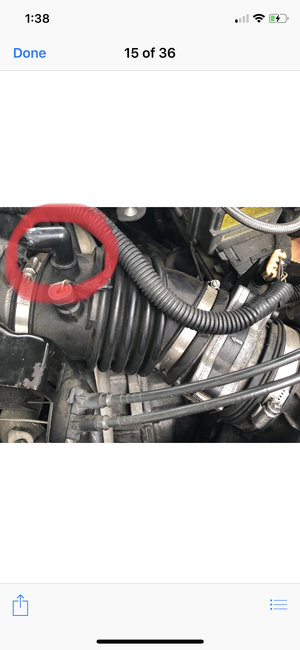

GUY WILSON
I’m having the same Problem what is this that broken off
Jan 20, 2021 at 2:40 AM (Merged)
That is a breather tube.
Feel free to start a new question and we will be glad to help you.
