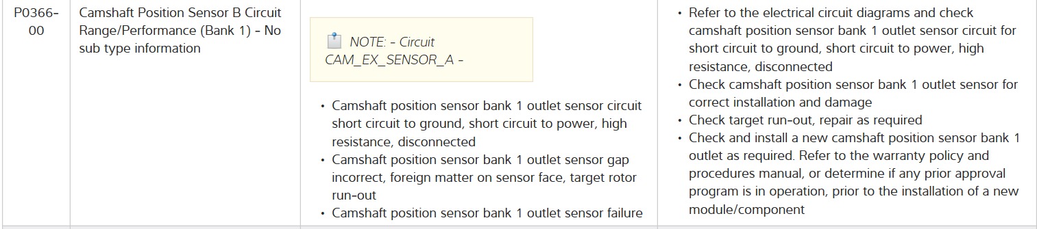

I have a 2011 jaguar xjl with 24,000 miles. Starts and run ok except when idle, and I am getting 2 codes p0016 and p0366, I checked timing, chains and tensioner, replace cam sensors in bank 1 and crankshaft sensor. Codes are still there and restricted performance. What could possibly be wrong and how to fix it.

on0016 the cam shaft timing plate may be screwed up or jumped due to a timing chain problem which you said you checked. see pic for code 0366, however a pro has to use his scanner to fix the correlation to adjust it after it's fixed. It may be a pcm problem as well.
