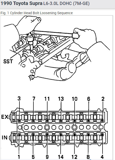

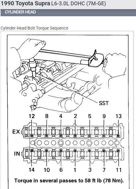

I just replaced the head gasket , and all top end gaskets. What is the correct head bolt torque ? I have two manual s and other information on the torque, from 54 lbs to 72 lbs .l know that you tighten the bolts in 4 rounds? Can you provide the process? Thanks.
Jul 4, 2016 at 8:34 PM
SQM
  • 6,383 POSTS

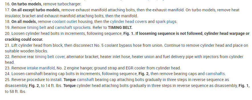

The torque specification for you vehicle is 58 ft lb.
I have attached replacement procedure for the cylinder head including torque specifications and sequence.
