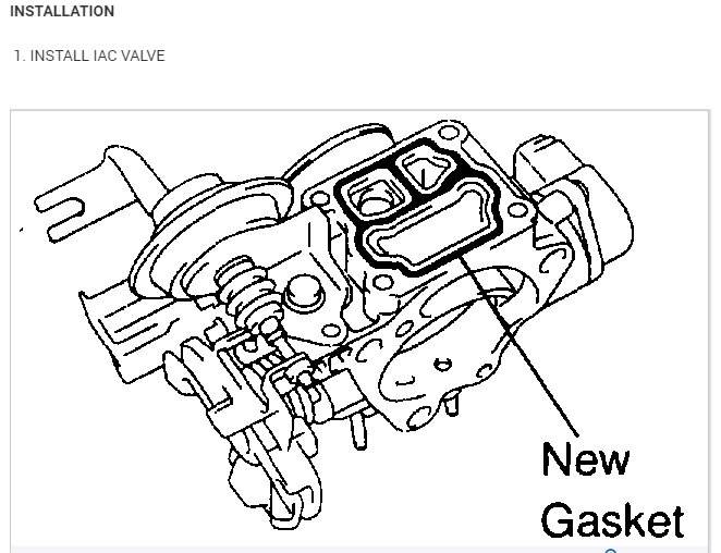

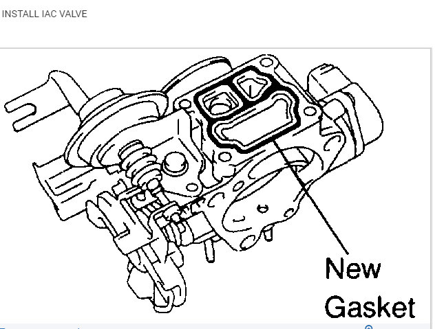

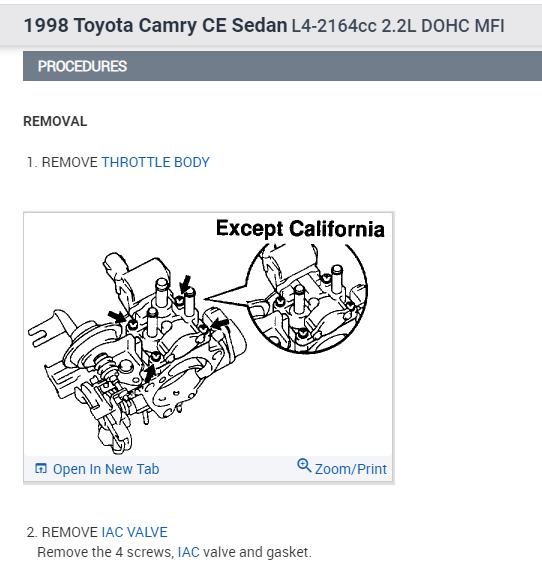

The issue is likely related to the idle air control valve (IAC). The IAC is what is responsible for maintaining engine idle speed.
The IAC is located on the throttle body and can be serviced.
Here is a link that explains how to service one:
https://www.2carpros.com/articles/idle-air-control-valve-service
If you service it, make sure the airway ports in the throttle body where it mounts are not carboned.

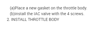

I attached the directions below for removing and replacing the part.

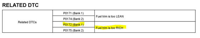

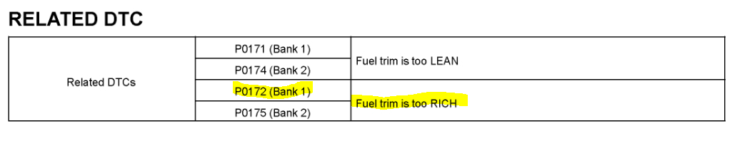

Next morning when I started the car it started misfiring and didn't want to move, I checked the codes.
They were po120, po 505, po172, and po301.
I really don't understand I change fuel injectors spark plugs spark plug wires coil fuel filter fuel pump.
I went in manually to increase the RPMs to 1,500 and drive 4 to 5 miles. It was running okay. But, I am afraid to go for a long test drive.
Please tell me what and where I am making a mistake.
Or some type of Karma which is on my head not allowing me to do anything right.
Thank you all.
Oct 29, 2022 at 2:04 AM
  • 110,251 POSTS
The new codes seem related. See pics 1 and 2 below. The engine is running too rich which is likely the cause of the misfire and problems you are experiencing.
So, I have a few questions. First, are you located in CA? Also, have you checked the fuel pressure to make sure there isn't an issue with the regulator?
