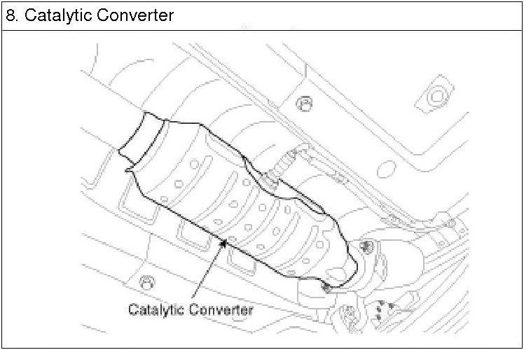

My car is a Kia Optima 2011 turbo and I notice that my car hesitated to crank up and the engine began to rattle.when you try to accelerate It barely wants to catch speed? What do you think is wrong ?

Many things can cause this issue, but based on your description, it sounds like the catalytic converter internal components may have come loose. If that happens, you will hear it rattle. Also, if it moves in a position that causes exhaust flow to be restricted, you will loose power. Take a look through these links.
https://www.2carpros.com/articles/catalytic-converter-replacement
Now, since you hear a rattle, what I want you to do is this. Take a rubber mallet and tap on the exhaust system to see if you can recreate the sound. If you can, have a helper determine where the noise is coming from.
If you can't recreate the noise, then follow the directions in the aforementioned link that discusses how to test one.

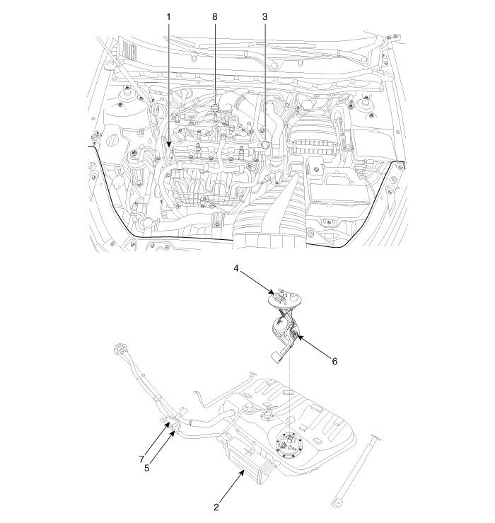

If you find the converter is bad, I attached a link that shows in general how one is replaced. Pictures 1 - 3 show location.
