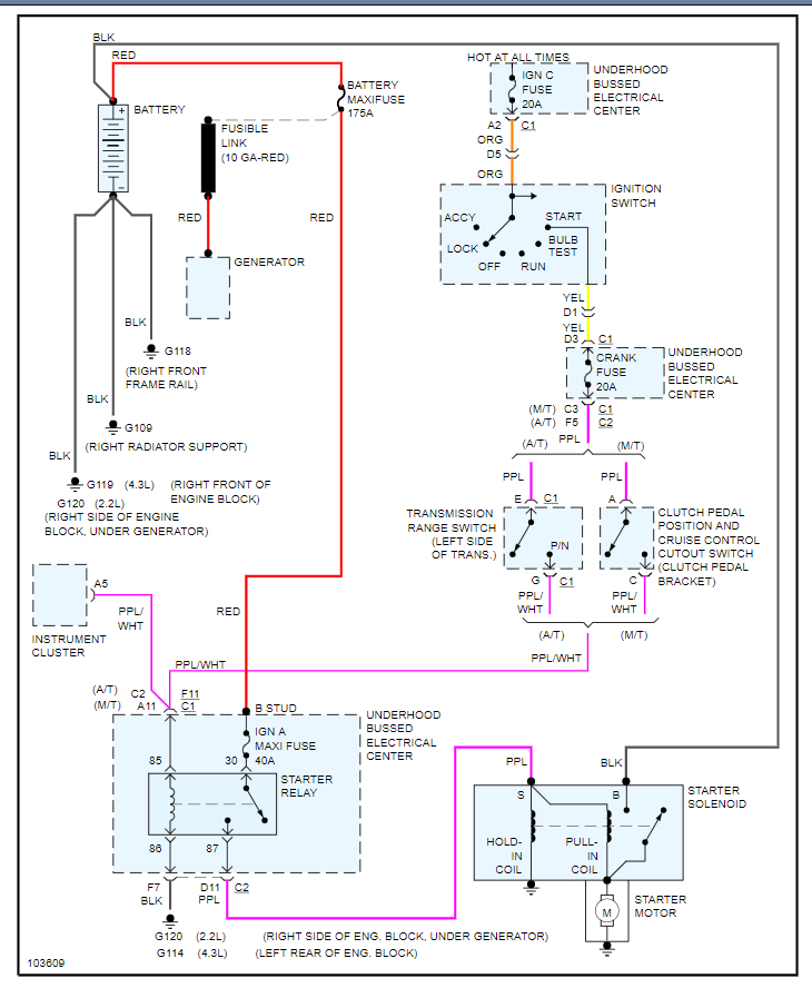

I don't know why when i start my vehicle it runs fine but after driving it for a bit it won't start unless i wait for 15 to 20 minutes. I used an obd2 meter and it read that the MAP sensor had to be replaced. so i replaced it and it still does the same thing. Also, when i start the car sometimes it starts but the headlights are real dim for a couple of seconds then it like kicks in and they light up normal as if the battery has to warm up or something. Why is this happening? Thank you

Okay, I understand. Is there any stalling when you drive? Meaning can you drive it as long as you want but just cannot shut it off? If you do it won't start until you let it cool down? Or will it shut off and then not restart?
Also when it will not restart, does it crank and not start or when you turn the key, does it not do anything?
The first thing that I am thinking if this just cranks and does not start if it is stalling then it could be a crank sensor.
If it is not stalling then this could just be a relay issue for the starter that is causing the starter to not come on.
When this happens, let's check voltage at the starter if it is not turning over and that will help us confirm this.
Below is the wiring diagram that will help with this as well.
Thanks
Aug 13, 2021 at 12:21 PM
BRIBRI4275
  • 24 POSTS
I changed the crank sensor and it still does the same thing. I'm thinking maybe the fuel pressure regulator? because it seems like it wants to start but it just shuts off. Would I be wrong to think this way?
