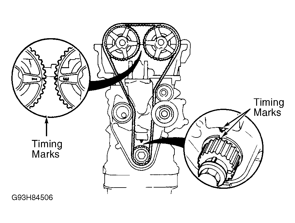

Timing belt timing marks
2001 MAZDA 626
43,000 MILES • 2.2L • 4 CYL • FWD • MANUAL
GREYMOYO87
Hard starting and popping back as well as no power I need to replace the belt can you help me with the marks?

if it pops back through intake then check for a worn cam or valve not opening. timing on ignition is not set.
This guide will help you install the timing belt
https://www.2carpros.com/diagrams/mazda/626/2001

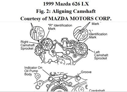

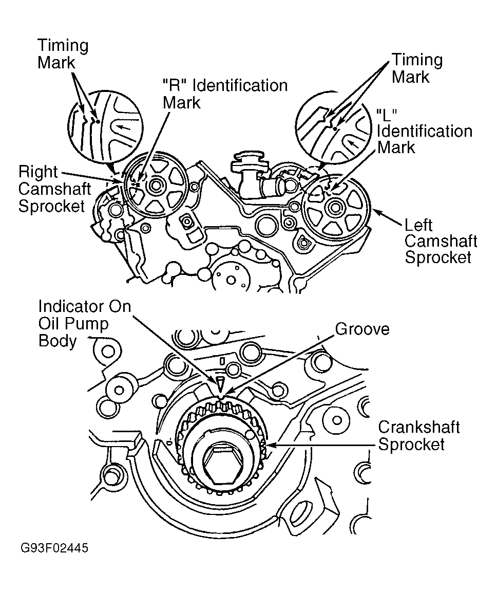

ED002
Engine Mechanical problem
1999 Mazda 626 6 cyl Two Wheel Drive Automatic
Hi, could you help me to locate the correct marks or images of double´s overhead camshaft? the R side and the L side. images I know what is the timing marks (the crank pulley and timming Sprockets, but I don´t know how to align inside) thanks
Aug 2, 2019 at 4:57 PM (Merged)
MHPAUTOS
  • CAR REPAIR CONTRIBUTOR
  • 31,937 POSTS
Hi there,
these should be fairly quiet, i will have to look up the engine and see hoe it is set up and i will re post with any advice
Mark (mhpautos)
MHPAUTOS
  • 31,937 POSTS
Hi there, The V6 is a single cam (per head) engine the 4 Cyl is a twin cam, so i have added both just in case.
https://images.2carpros.com/forum/automotive_pictures/61395_Capture_43.jpg
https://images.2carpros.com/forum/automotive_pictures/61395_Capture_1_3.jpg
Mark (mhpautos)
ED002
well, I have that marks, nice! but the inside is the trouble. Inside the head, what is the correct alignment with the intake and the exhaust camshafts
MHPAUTOS
  • 31,937 POSTS
The cam gears will only fit on one way, place the cam gear on the shaft and lay the cam in accordance to where the alignment mark should be, you have a margin to work with at this point, so it dose not have to be exact until the belt is on, a few degrees at this point is not an issue, i hope that is a bit clearer.

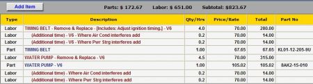

TSAUER
The car was making weird sounds and i took it in they told me i needed a new waterpump and timing belt and quoted me $1000. I looked up the price of the parts online and it only came out to about $165. Even if they're charging $70 an hour for labor it comes out to almost 12 hours of work. Is that actually how long it will take or are they trying to take me for a ride.
Thanks for your help
Aug 2, 2019 at 4:58 PM (Merged)
BLUELIGHTNIN6
  • 16,542 POSTS
1k is slightly higher than what it should cost..
https://images.2carpros.com/forum/automotive_pictures/261618_Noname_1051.jpg

WRENCHTECH
  • 20,761 POSTS
https://www.2carpros.com/images/external/84982368.gif

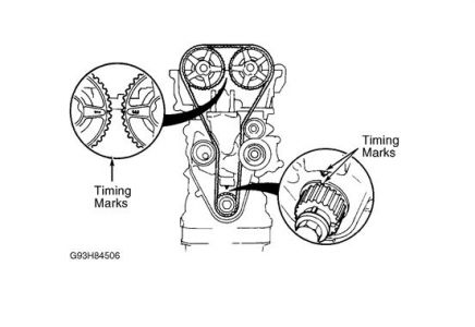

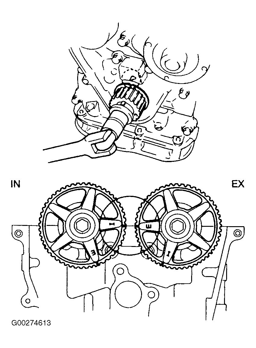

TWEETYROSE
Which timing marks on the camshaft sprockets do I align with each other. Do I align E with I or I with E or E with E or I with I.
MWHITNEY
  • 63 POSTS
on the cam for the exhaust side the first lobe should point to the exhaust manifold. the intake cam first lobe should point to the intake manifold. this should almost align two little marks on the spockets. then it is in time. let me if any more questions.
COSMO
  • 347 POSTS
The I on the intake cam should line up with the E on the exhaust cam in the middle. They are a pain to hold still while you line up the cams and the crank sproket. I have a tool that fits in the sprokets to hold the cams still while lining up the crank.
Cosmo....Mazda Tech
