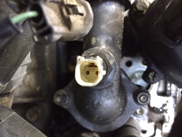

I have the car listed above BASE engine. The car had overheat problem. Temperature gauge indicated normal condition (middle between H and C) for a while. Then, it certainly raised to H (hot) in manner of minutes. Water was seen boiling from radiator water container. I noticed that the cooling fan did not run at that time. Issue is not seen during freeway driving.
I replaced thermostat and coolant temperature sensor but issue was still there.
Fuse for fan was good. I have located thermo fan switch. If I left ignition switch on (engine is off), and removed the connector from the thermo fan switch, the fan worked. The thermo fan switch is shown in the first picture.

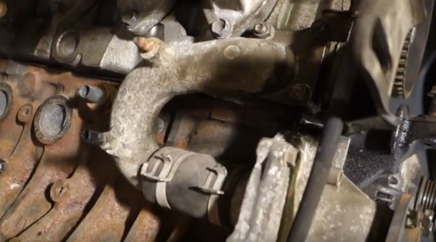

I was about to replace this unit. But I ran into another article about different "fan sensor" located in the left side of the engine, below the exhaust manifold as in second picture (viewed and captured from YouTube video). I am not sure if second picture is applicable to my engine. It is not easy to reach.
Could you give me advice on what steps I should take to narrow down the problem in order to replace the right component?

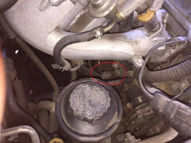

I just took a picture of second possible "fan sensor" in my car below the exhaust manifold. What is it called? Could you point me to the link of this part? Thanks,

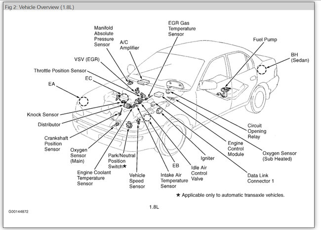

The fan sensor is in the thermostat housing the one in the last picture is the coolant temperature sensor for the gauge i believe.
Here is a guide below that shows the sensor locations but I don't see the location in which you are showing here now.

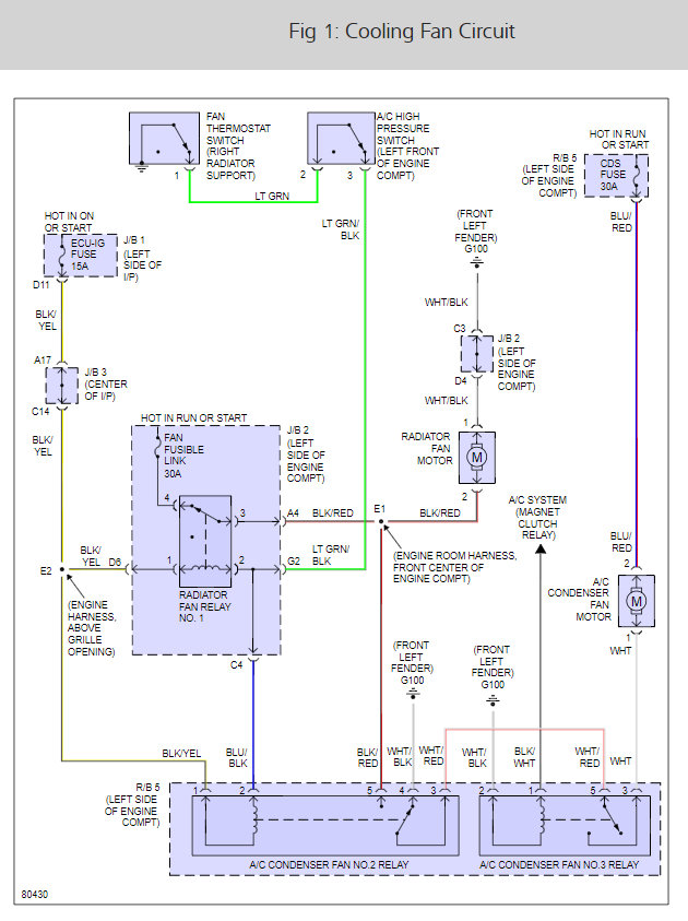

The diagram does not include fan switch sensors. So, I am confused. What do you think?

Here is the cooling fan wiring diagrams you can see the two sensor/switches that work the system. If you ground the sensor wire at the thermostat housing with the key on the fan should run can you do this test please?

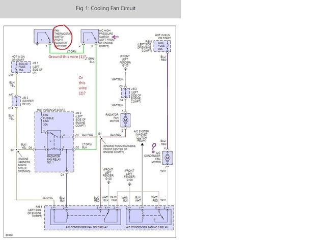

Thank you. I edited the diagram and added in text to wire. Could you confirm that is the sensor wire you want me to try?
As I mentioned in the initial report, if I removed the socket out from sensor as in 2nd attached picture, the fan ran. The wire to this socket is "light green"

. Here is attached edited diagram with 2 texts on "light green" wire: (1) and (2). Which one you want me to try?
I don't know if light green wire from my car (in previous picture) is (1) or (2). My best guess is that it is (1) as it is on engine block, far away from A/C unit.

The fan thermo switch is the one I would replace. You say once you remove the wire the fan runs correct?
