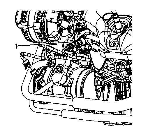

engine oil light comes on ,even after oil & filter change ,location of sending unit, to test?
107,000 MILES • 3.6L • V6 • 2WD • AUTOMATIC
FJRDC
Oil light came on , checked oil was at the full level, oil mileage was at 3,000 miles , changed oil & filter (Castrol 5w-#30 & ac /del co PH48 ) , car ran fine ,reset oil life ,4 days later light come on again, would like to find the location of the sending unit to troubleshoot it/ replace it.
Jul 16, 2014 at 11:10 AM
CARADIODOC
  • 34,412 POSTS
Just so you're clear, the warning light refers to oil pressure, not level. The sending unit is usually near the oil filter. Professionals would check the actual pressure with a mechanical gauge first, then replace the sending unit if the pressure was fine. Since most people don't have a pressure gauge, and since sending units aren't very expensive, buy the new one, then you'll know what you're looking for. If the light still turns on while you're driving, have the pressure checked by a mechanic, or you should be able to borrow a pressure gauge from an auto parts store that rents or borrows tools. The hose for the gauge screws into the same port as the sending unit is in.
Jul 16, 2014 at 2:32 PM
  • 110,248 POSTS
The switch is behind the alternator mounted on the engine block. See pic attached.

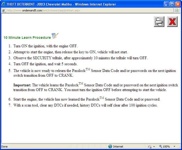

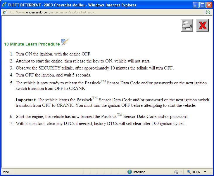

My 2003 chevy malibu won't start. It registers low fuel, but there is a half a tank or better in there. I tried resetting the theft system, but that didn't help. Also the battery light, and oil light are not coming on when its in the acc or on position. My husband also recently replaced our car battery. Any ideas what it could be?
Jan 3, 2020 at 10:25 AM (Merged)
SATURNTECH9
  • 30,869 POSTS
Is the security light on?Do you power door locks and keyless entry work if you have them?Is the starter turning the engine over?Did you make sure the battery cables are clean and tight?Did you have the battery tested even though it was recently replaced doesnt mean its good.
HEATHERANDSTACY57
  • 11 POSTS
Yes the security light is on.the door locks work and the starter is turning over the engine and the battery is good and the terminals are clean.
SATURNTECH9
  • 30,869 POSTS
Sounds like you could have a bad body control module.How did you try to reset the security light?
HEATHERANDSTACY57
  • 11 POSTS
first i unhooked the battery when that didnt work i put the key into the auxillary setting for fifteen min. security light is still on

the security light is off but the car still wont start
HEATHERANDSTACY57
  • 11 POSTS
the fuel gauge is reading empty but their is more than half a tank of gas in it
SATURNTECH9
  • 30,869 POSTS
Because of the no start and the fuel gauge inop i suspect a bad bcm.Anyway you can rent a scanner and see if you have any codes?
