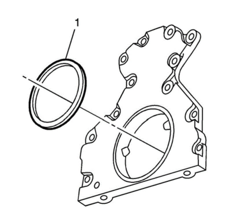

How do I repair this?
Nov 5, 2021 at 12:01 PM
  • 110,194 POSTS
If the leak is truly the rear main oil seal on the engine, the only way to fix it would be to replace the rear main seal. This can be a big job.
I'm not sure what engine you have in the vehicle, but if it is the 6.0L, it is a one-piece seal and will require the removal of the transmission and flex plate/flywheel. See pic below.
Let me know the engine size, transmission type, and if it is 4w.
See pic below.
