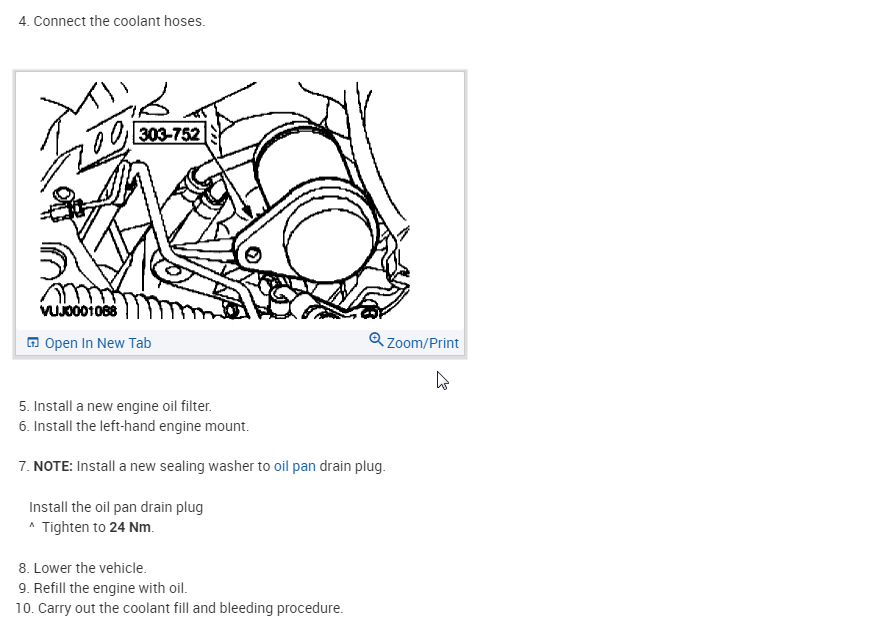

My car isn't overheating and hasn't ever and does not run poorly. Any other than I had my water low light came on and I added maybe a half a 2 liter bottle and maybe a mile or so same thing and it never overheated. so I go home raise hood check water and it's low same not a lot but half of a 2 liter. so I checked the oil and noticed that it was milky does this mean my engine oil cooler is bad or worse than that?
Aug 21, 2019 at 3:23 AM

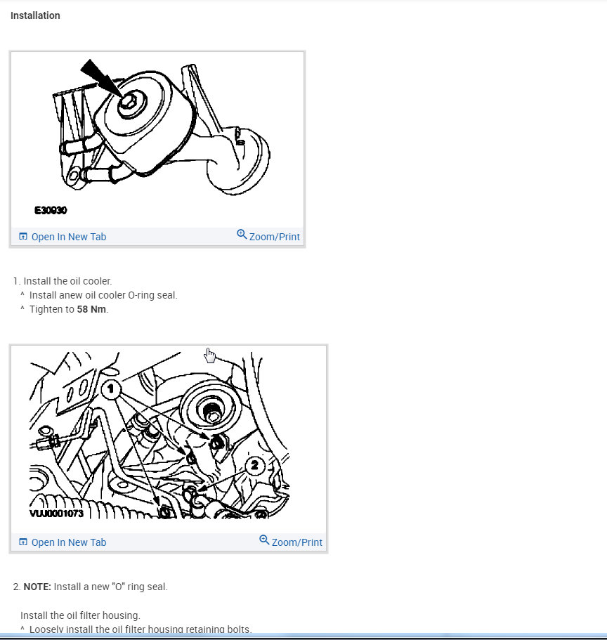

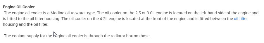

It is very possible that this is you issue. However, it could still be the head gasket. Just because it is not overheating doesn't mean it is not going to overheat. I would suggest performing a head gasket test, guide below, just to make sure it is not a head gasket. If it is not, then the oil cooler would be the next likely cause.
https://www.2carpros.com/articles/coolantantifreeze-in-the-engine-oil
