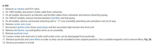

If you have spark and fuel, it should run. However, low compression can prevent it from starting. Did you remove the valves? Have you set valve lash?
If possible, could you record it cranking and upload it for me to hear? If not, I need you to check the engine compression. Here is a link that explains in general how to do it:
Here is a link that covers the most common causes of a crank no start. Take a look through it as well.

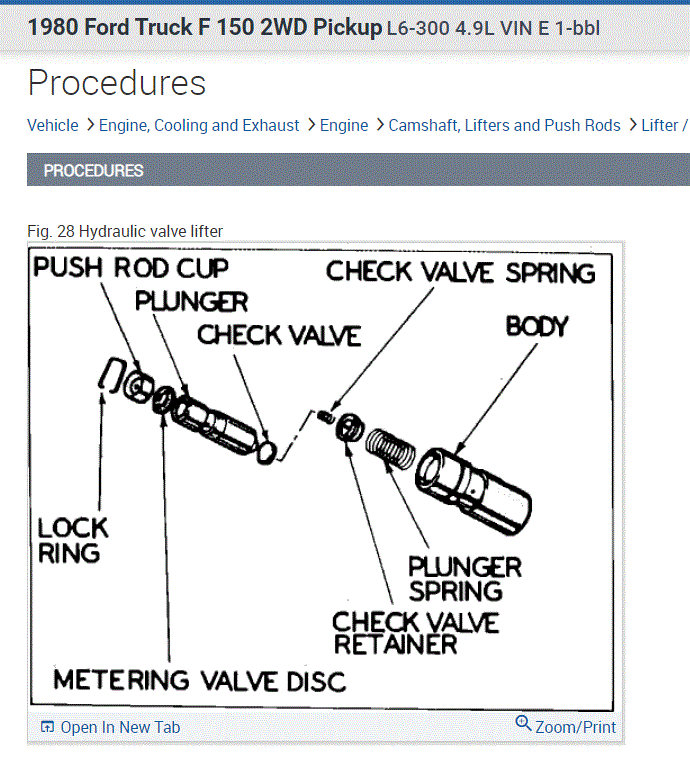

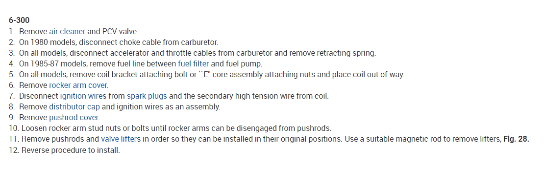

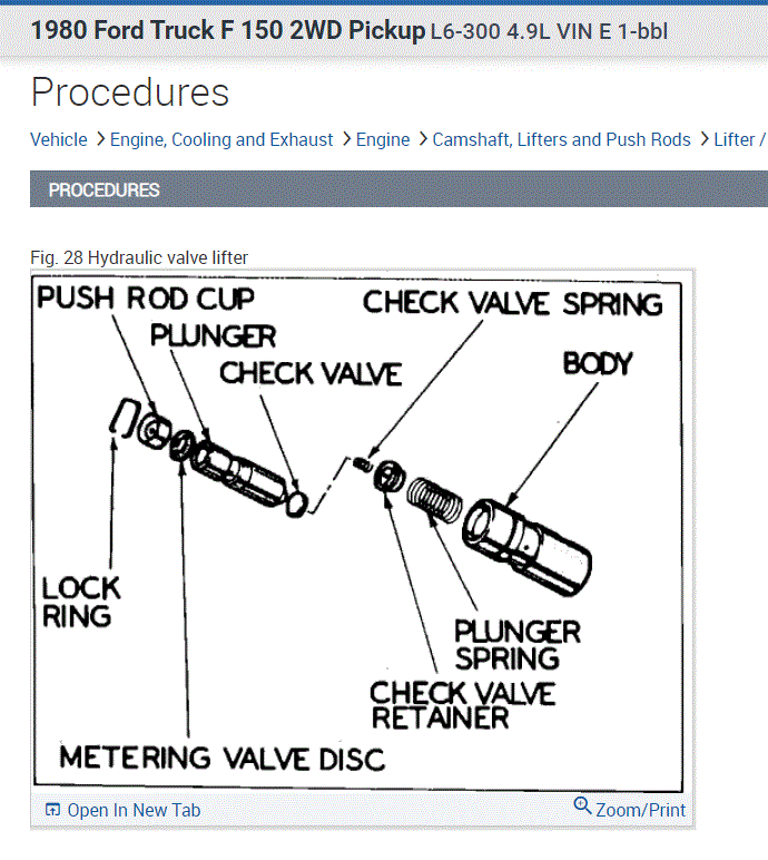

If you look at the attachments below, I found directions for adjusting valve lash. The oldest one I could find was for a 1980, but the engine is the same.
I'm attaching those directions because if they aren't properly adjusted, it can cause valves to not fully close. As a result, compression is lost and the vehicle won't start. Also, when you reinstalled the head, did you place the pushrods back in the same positions?
