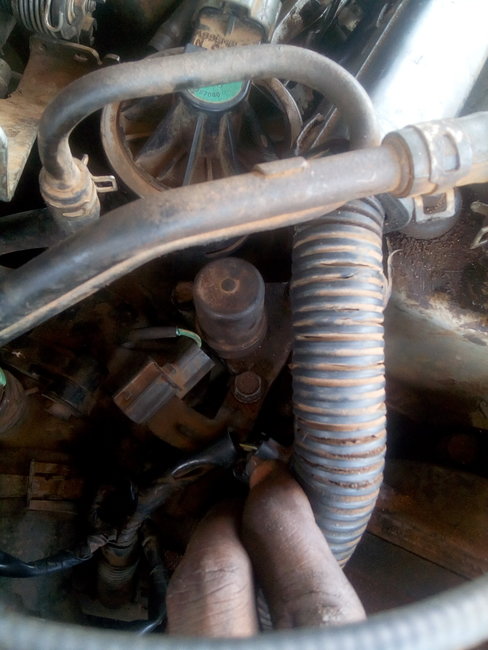

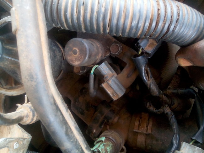

I tested the solenoid show below by battery, I could hear the sound clicking sound. while the engine was running. I tested for voltage at the solenoid but there was no power. It is supposed to have power while the engine is working?

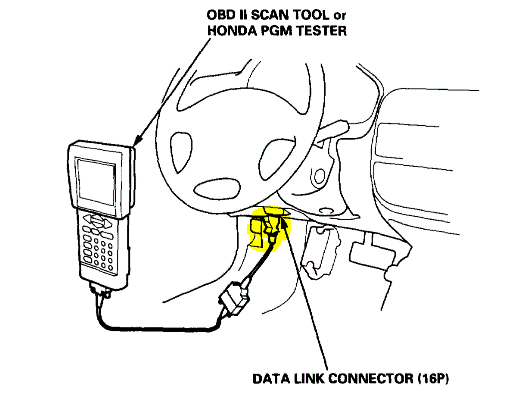

For the codes, I can't find the OBD port.
Apr 21, 2021 at 1:50 PM
  • 110,240 POSTS
It should be right below the steering column (approximate center). See the attached pic for the location.
Let me know if you find it.
Apr 22, 2021 at 11:51 AM

Thank you sir, it supposed to be there, but the OBD PORT is not there and I have searched for it other places I can't find it.
I have given up on the vehicle, I am no longer interested. Thank you
