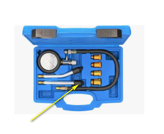

I am unable to use my compression tool on cylinder 3 due to the fact its mis threaded I'm unable to fit the tool on there

As you have tested all required components, I would suggest getting yourself a push on compression tester. see image below.
Cheers, Boris
