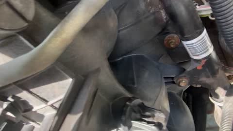

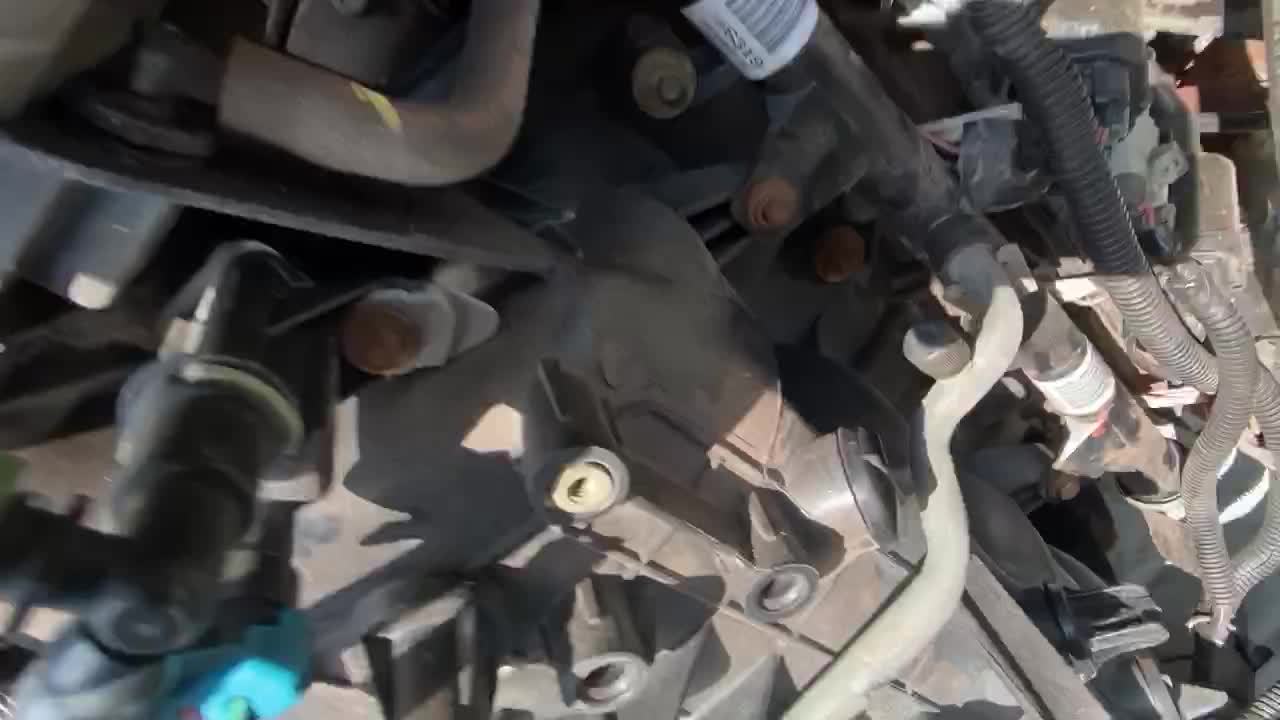

This does not sound too good. it’s coming from passenger side of the engine. any idea what it could be? Lifters, valves, springs?
May 5, 2021 at 6:44 AM
  • 110,240 POSTS
The sound in the second video sounds like an exhaust manifold leak. Does the warranty cover it? Also, I understand your frustration going up the hill. Wow.

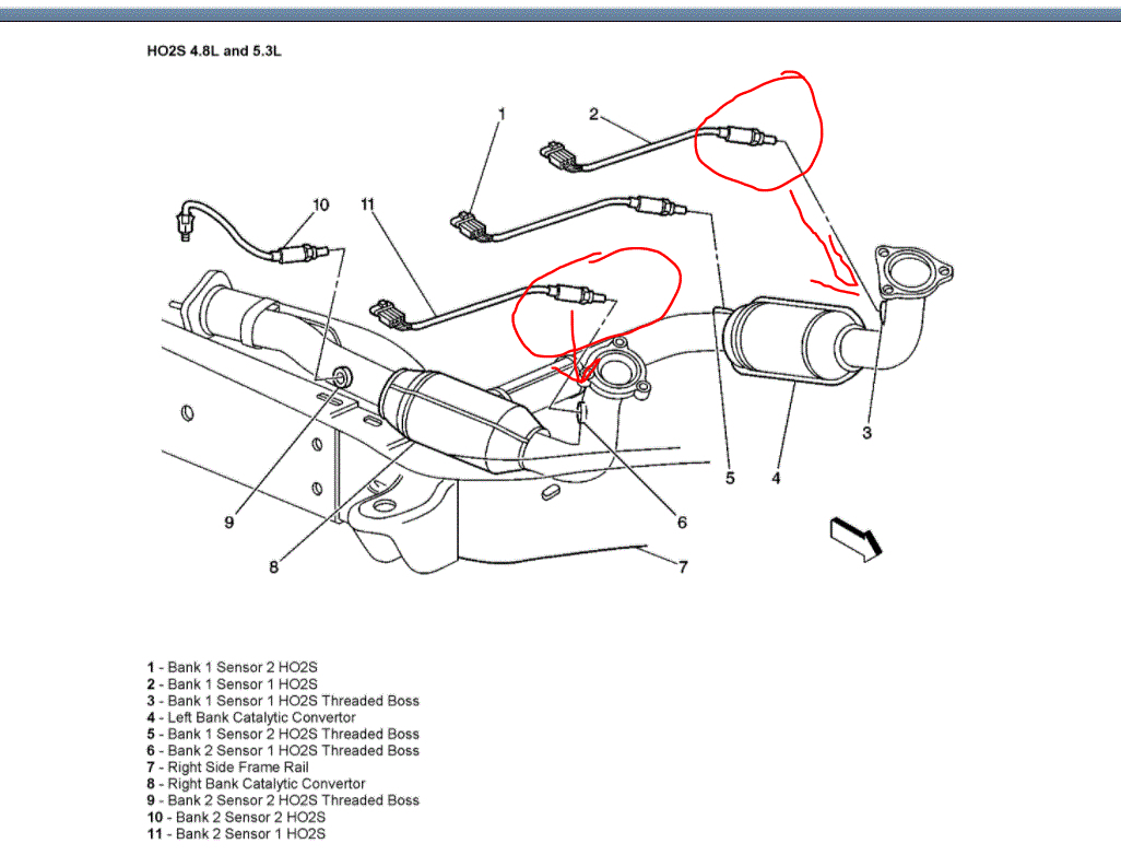

When you went up the hill, I really couldn't hear what the engine was doing. Here is what I want you to try. Remove the oxygen sensor before the catalytic converter. If the converter is plugged, you should notice a difference simply because you are adding a small area for the exhaust to exit. Here is a link that explains how to test one, but it suggests removing the entire converter:
I attached a pic of the exhaust system and circled the two sensors I'm referring to.
Let me know if it makes any difference. Also, since you purchased a warranty, has a dealer checked it out for you?
