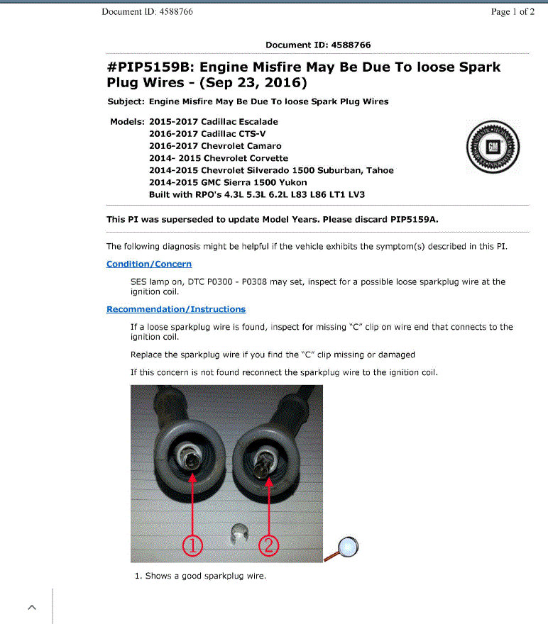

This guide should help us fix it it
There is a technical service bulletin (TSB) related to a misfire concern. It seems the spark plug wires retainers can come off and cause a misfire.
Since this TSB exists, I would recommend checking the number 7 spark plug wire. Take a look at the pic attached.
Let me know what you find.

I just put new plugs and wires. I'll check #7 tomorrow and let you know. thanks

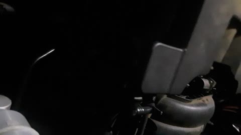

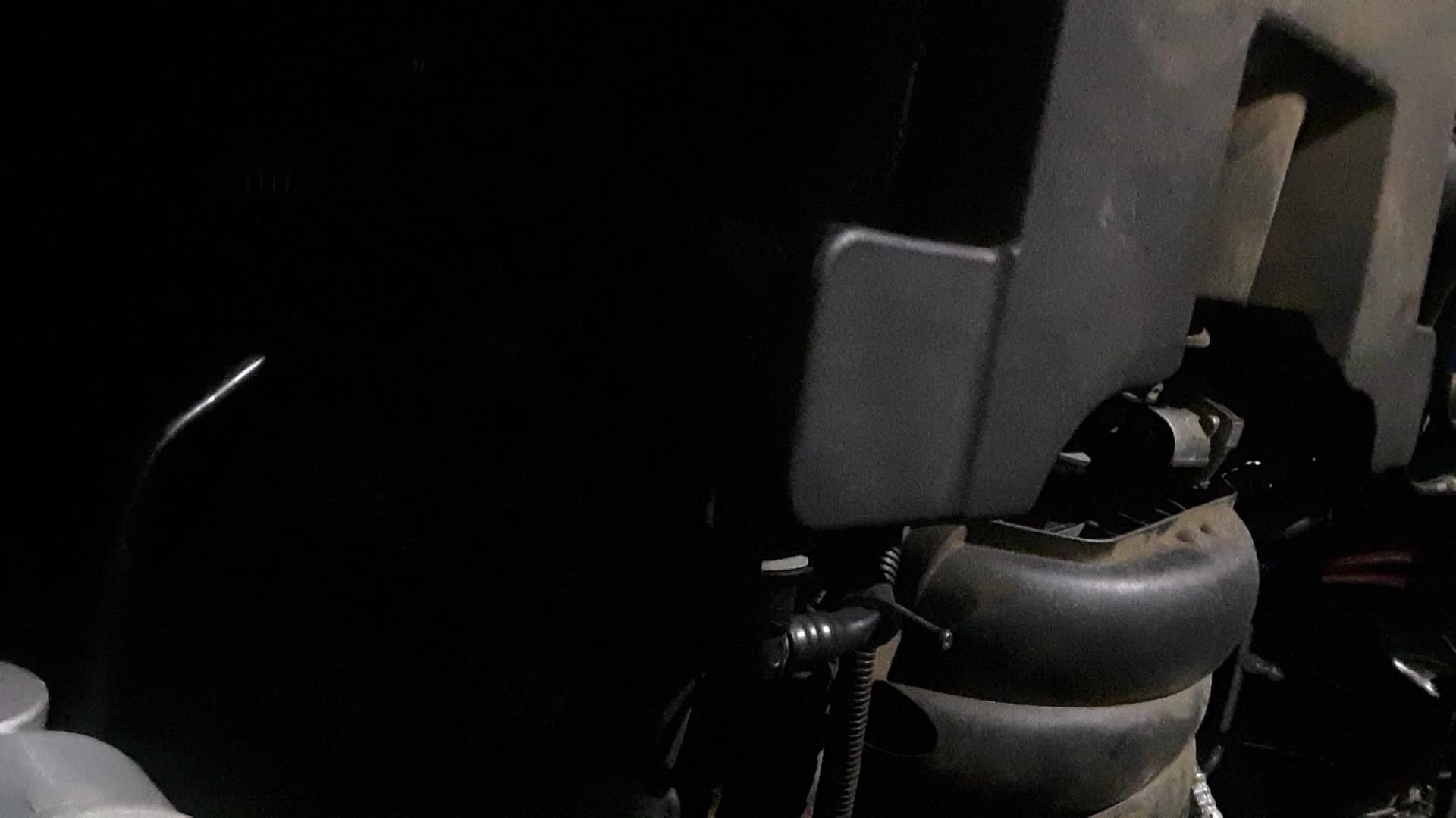

Does the chirping sound change with engine speed? Is it loud enough for you to record it and upload it for me to hear? Are there any new codes?

Could the sound be coming from the transmission area? If not, we need to rescan the computer. There are several valves this could be referring to. I would scan the CAN system. CAN stands for controller area network. It ties all the modules/computers together. Here is a video:
https://youtu.be/InIlnsjOVFA
Still, record and upload the sound. With a little luck, I'll be able to recognize it. I'm starting to question if it is related to the cylinder deactivation system which can get involved.

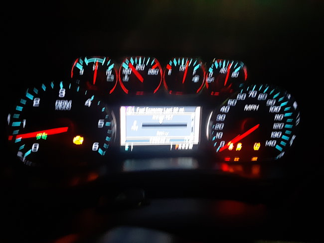

When I crank my truck this morning both lights came on and it sounded like my fan kicked on but it was something else.
Dec 10, 2020 at 8:01 PM
JASON SISTRUNK
  • 11 POSTS
Flashing engine light and stability trak.

Thanks for the videos. I listened but can't identify it over the computer. I was hoping I could. Do me a favor, we need to scan the CAN BUS to see how many codes are actually hidden that we don't know about.
Is that something you could have done?
