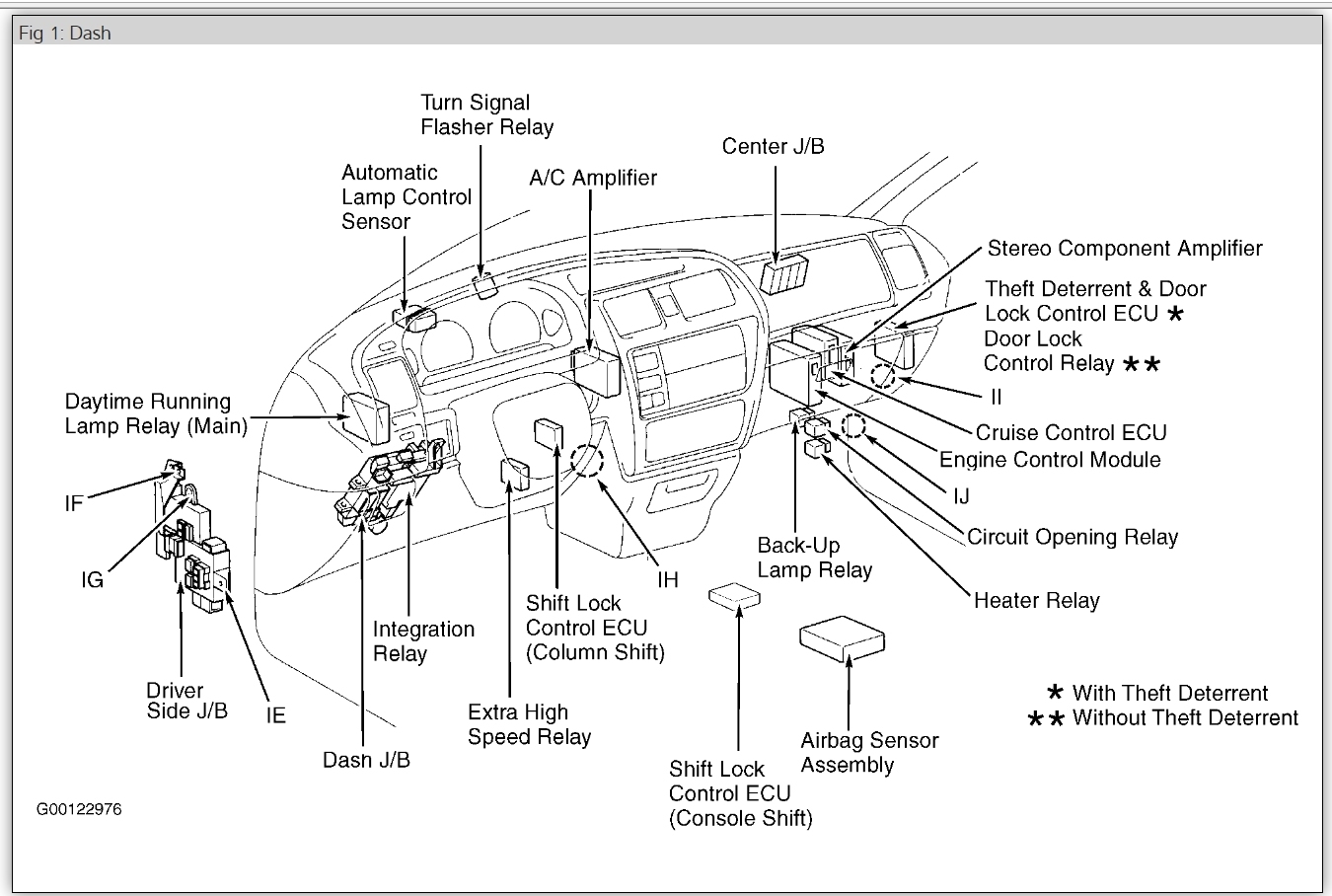

My problem is the car starts for thirty seconds and dies! I have replaced the in tank fuel pump and sending unit plus a new fuel filter and fuel pressure regulator! car still wont start? I checked all fuses and relays all are working properly. Now I was told by my mechanic that it is the circuit opening relay. Now I tested the connection to the fuel pump and what I found was when the ignition is turned on fuel pump does not respond! When I turn the ignition to the on or start position pump turns on. Let go of switch and car dies. I need someone who knows what this problem is. It has me stumped! Thanks, Tom.

Okay, I will check spark on cranking. I have the circuit opening relay, but cannot find its location. And believe me I have tried. Passenger kick panel? Behind the radio? Under the hood? Drivers side fuse panel? Behind center console? I gave up at this point. Any Idea Where It Is? Thanks, Tom.

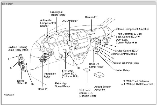

Hey topD
I know its a little crazy but have you checked the engine oil and made sure there is gas in the tank? Both of these will make the engine shut down in thirty seconds. Here is a diagram of the circuit open relay location
Please let us know what you find so it will help others.

Yes! I have and your diagram of the circuit opening relay does not exist. I Disassembled the whole dash board looking for it. Right side kick panel no. Behind glove box not there either. Under the hood no. Behind radio no. Under drivers side fuse panel. I am frustrated as to what to check next? My wife loves this car and so do I. Do you have anymore thoughts? Would be greatly appreciated! Thanks, Tom.
