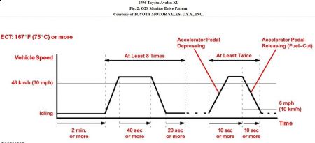

Only two things come to mind, Readiness monitor is not ready, car needs to be driven a certain way which I will post, and the DLC 3 connector needs to be checked, I will post this as well:
DLC3 INSPECTION 1. If scan tester displays UNABLE TO CONNECT TO VEHICLE when scan tester is connected, try scan tester on another vehicle. If scan tester operates on another vehicle, go to next step. If scan tester does not operate on another vehicle, problem is probably with scan tester. 2. Check DLC3 for loose or damaged terminals. Ensure DLC3 terminals are in correct position in connector. See appropriate wiring diagram in WIRING DIAGRAMS article. Repair as necessary. If connector and terminals are okay, go to next step. 3. Check voltage and resistance between ground and specified terminal on DLC3. See DLC3 VOLTAGE & RESISTANCE SPECIFICATIONS table. See Fig. 1 . If voltage and resistance readings are not as specified, check wiring circuit. See appropriate wiring diagram in WIRING DIAGRAMS article. NOTE: Terminal No. 2 on DLC3 provides the pulse generation during the information transmission from the Engine Control Module (ECM).
https://www.2carpros.com/forum/automotive_pictures/62217_dlc_2.jpg
https://www.2carpros.com/forum/automotive_pictures/62217_2_39.jpg
https://www.2carpros.com/forum/automotive_pictures/62217_Monitor_Readiness_1.jpg
I will email a PDF on monitor driving instructions.

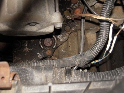

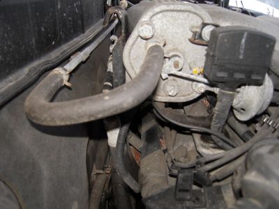

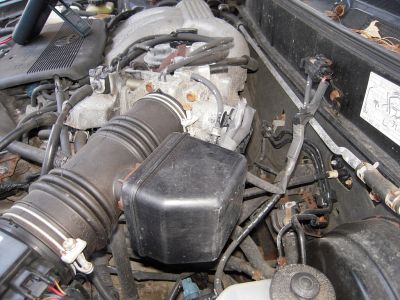

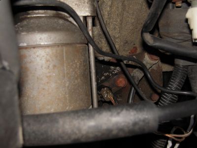

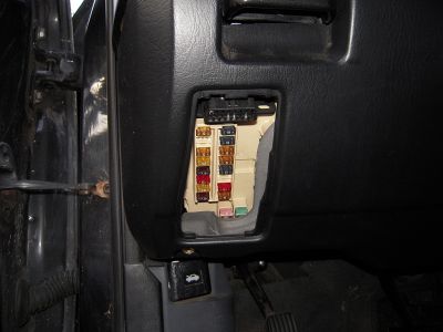

Could not locate a ground connection at the back of the intake manifold. Perhaps you can direct me via the attached images.
Images 4 and 5 show the earlier problem with the trans speed sensor. Since the connector was rotted, I soldered the leads directly to the sensor. The resistance of this sensor is in spec with the magnetic testing. The error code for this was cleared.
Please note: I'm able to clear the check engine light with a scanner when the car is running. However, when I shut the ignition off then on again, the light returns.

In the top picture, under the hose that connects with clamps, that looks like several ground wires, check that, remove and clean them up. The other possibilty is the ignition switch might be the cause.
Saturday, November 21st, 2009 AT 7:22 PM
SILVESTRIK
  • 9 POSTS
I pulled and cleaned those ground wires, but no change.
