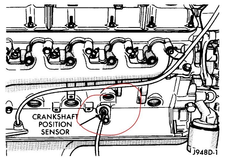

Loss of power.
2500 model, V10 engine. Runs like a new one but lately while driving let's say at 55 mph, it will shut completely down just as if you turned the ignition key off. After coasting to the side of the road I turn the switch key off then back on and it starts right up. I'm able to take off. Most times I can make it like ten miles before it repeats but today it shut off four times like above but always restarted and I'm home now. Was thinking cam sensor. Please I'm poor and can't afford to throw parts at it. Can you help?

First, if the check engine light stays on when the engine is running, you need to scan the computer for diagnostic trouble codes. If it is on, there will be helpful information to diagnose the issue.
Here is a quick video that shows how it is done:
https://youtu.be/YV3TRZwer8k
I realize most people don't own a scanner, but often times a parts store will do it for you. Also, they even may lend or rent one.
Now, based on your description, my first suspect is the crankshaft position sensor (not the camshaft sensor). When they start going bad, they can fail like this. Take a look through these links. The first explains the crankshaft sensor's function. The second explains symptoms. The third explains in general how one is replaced.
https://www.2carpros.com/articles/how-a-crank-shaft-angle-sensor-works
__________________________
Now, if the check engine light never stayed on, it could still be this sensor. How I determine if it is bad is by using a live data scanner to see if the RPM signal stops when the engine stalls. If it does, this is my first suspect.
If you look at picture 1, it shows the location of the sensor. I circled it for you. If you determine this is the problem, here are the directions for replacement. The remaining pictures correlate with the directions.

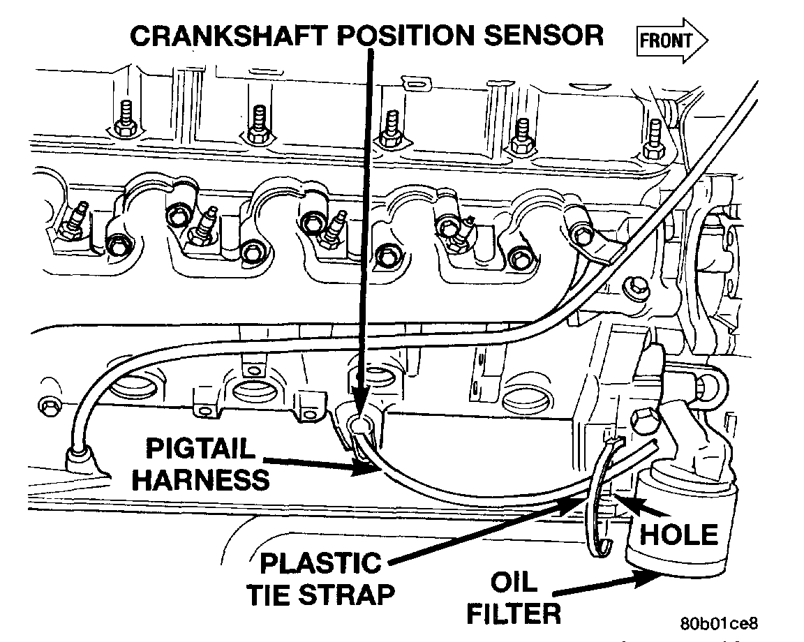

Crankshaft Position Sensor Location
pic 2
The crankshaft position sensor is located on the right- lower side of the cylinder block, forward of the right engine mount, just above the oil pan rail.

1. Raise and support vehicle.
2. Disconnect sensor pigtail harness from main engine wiring harness.

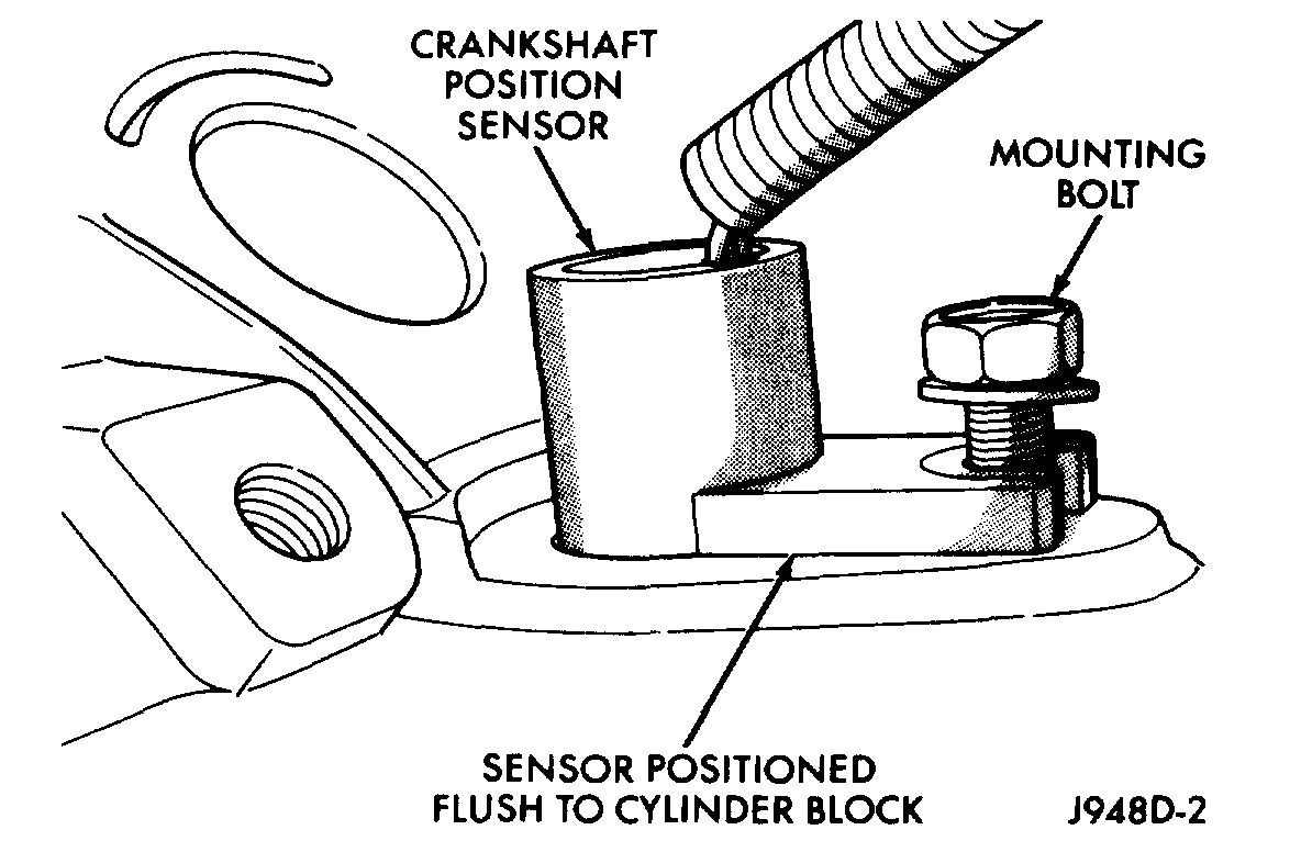

Sensor Removal/Installation
pic 3
3. Remove sensor mounting bolt.
4. Cut plastic tie strap securing sensor pigtail harness to side of engine block.
5. Carefully pry sensor from cylinder block in a rocking action with two small screwdrivers.
6. Remove sensor from vehicle.

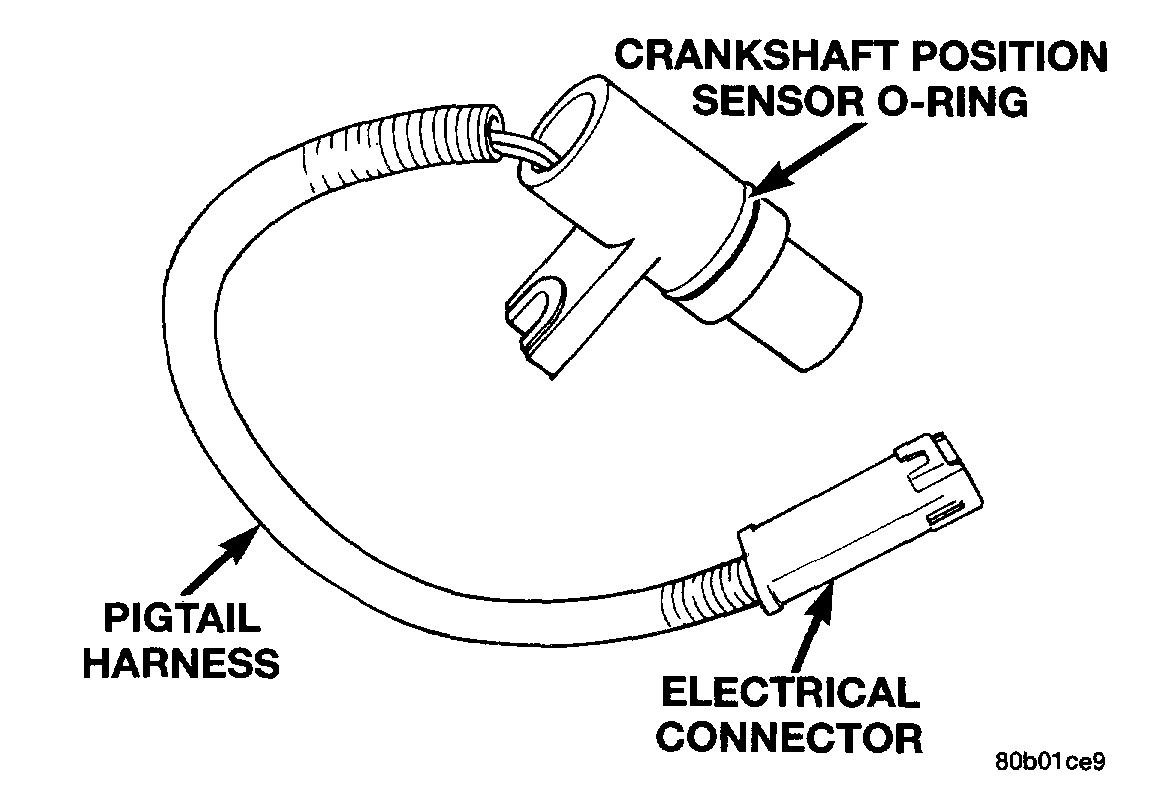

Sensor O-ring
pic 4
7. Check condition of sensor O-ring.
INSTALLATION
1. Apply a small amount of engine Oil to sensor O-ring.
2. Install sensor into cylinder block with a slight rocking action. Do not twist sensor into position as damage to O-ring may result.
CAUTION: Before tightening sensor mounting bolt, be sure sensor is completely flush to cylinder block . If sensor is not flush, damage to sensor mounting tang may result.
3. Install mounting bolt and tighten to 8 Nm (70 in. lbs.) torque.
4. Connect sensor pigtail harness to main engine wiring harness
5. Install new plastic tie strap to secure sensor pigtail harness to side of engine block. Thread tie strap through casting hole on cylinder block.
