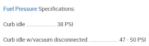

First thing I would suggest is to perform a fuel pressure test.Sounds like you might have a weak or failing fuel pump.If you don't have access to a fuel pressure tester most auto parts stores have a tool loaner program and can rent you one.Here is a tutorial showing what is involved to test fuel pressure:
I've attached a picture below for your car fuel pressure specification below.Hope this helps and thanks for using 2CarPros.
