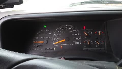

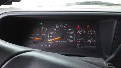

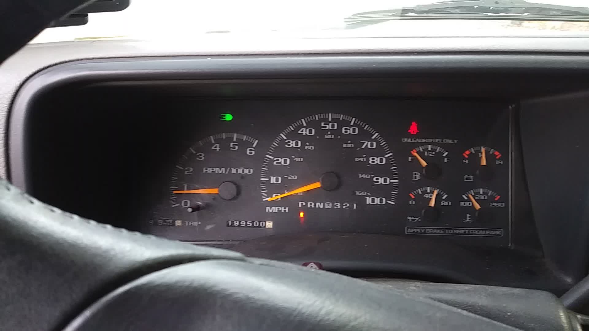

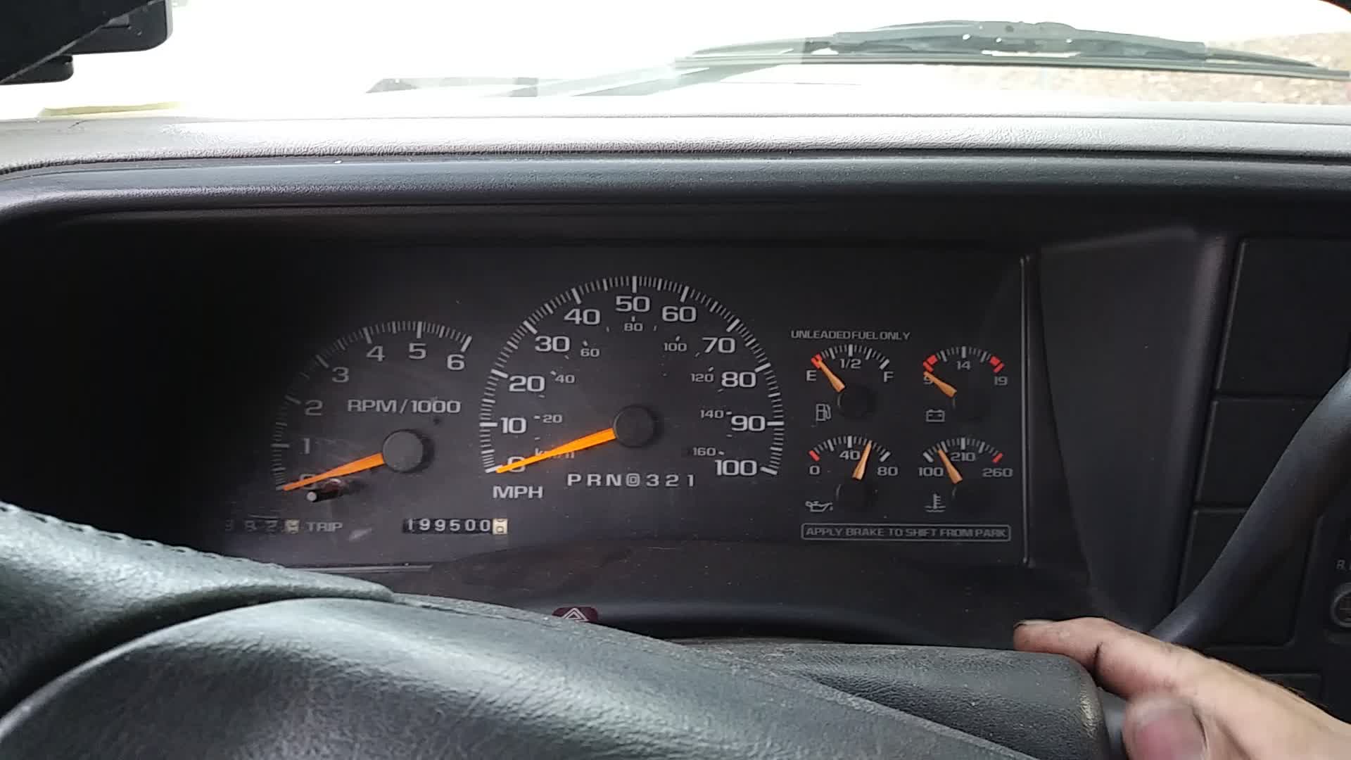

Okay, I uploaded a video of the sound. Oil level is good, have not replaced plugs but have pulled two and they looked good.

ASEMASTER6372, here is the video you requested. Hope it is what you need.
Thanks for your efforts.
Sep 29, 2018 at 5:23 PM
That is a main or rod bearing in the bottom of the motor. Sorry. Sounds like the engine is done. Something has failed in the lower end.
