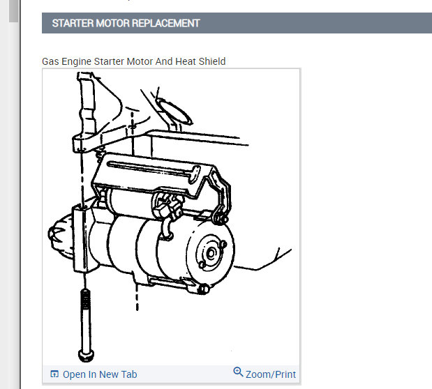

When the starter does not turn at times that is most always the solenoid. Here is a guide that talks about this in more detail:
Basically the solenoid gets a worn spot and when it is resting on this spot it will just click or not do anything.
Clicking the starter a few times will normally get it to move enough to get the starter to turn.
If it were me, I would just replace the starter again as it comes with the solenoid on it.

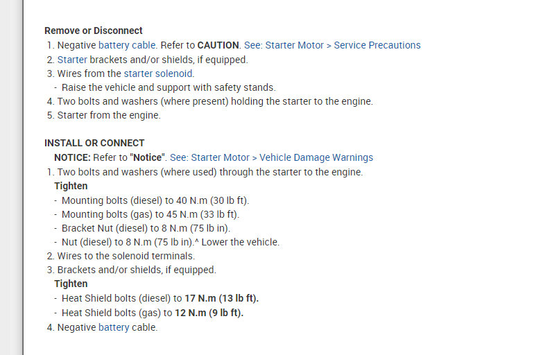

below is the info from the manual on how to replace the starter.
Please run through this info and let us know if you have other questions or need more info.
